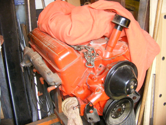

    Here's a rebuilt 1956, 40 over 265 for sale, PM interested for price and info.
