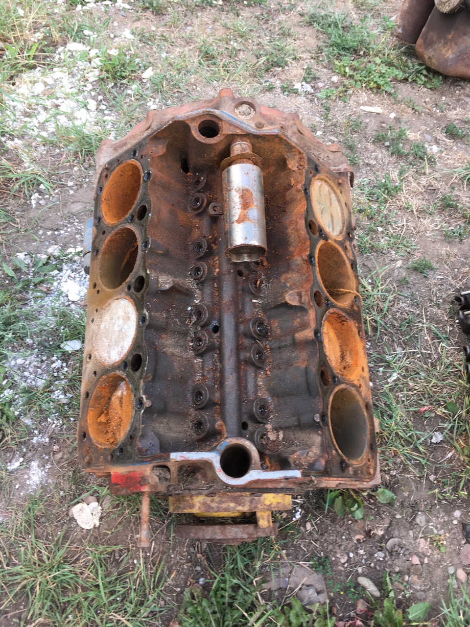

    I wound up with 1 ‘55 265 and 2 ‘56 265s, 2 pair of 2 1/2” rams horns, a crusty staggered hole Vette valve cover, a ‘57 549 head, year of manufacture plates for one of my Impalas, a Ford green bible, a Chevy parts book, a 58 Chevy service manual, an original Big T kit, and an original AMT ‘32 coupe. I was wrong about one of the 265s being a ‘57. I thought I saw chartreuse but it was colorful engine paint. She wouldn’t part with the ‘57 283. She wants to sell it with the wrecked ‘57 4dr Bel Air that she thinks someone might want to build. I may bug her again in a month.
    I opened the ‘55 up tonight to see if it was s**** or not. It was the crustiest on the outside so I wasn’t sure what I’d find. Two cylinders had been wet. It’s still standard bore so it may clean up. Almost all the casting numbers are 12/54, it was a 2 barrel manual with the oil filter. It’s made it through triage, I’ll bring it inside and pull the pan. I’ll get pics up soon.

    The 55, 265 is a standard bore block as noted by the "flat top with NO valve relief pistons"; the source of a LOT of warranty work when valves and pistons collided. Oversized pistons had 4 valve reliefs, as did warranty pistons. What the "thing" that's bell-shaped, and installed in a freeze plug hole, with two electrical terminals, I have NO idea. Some sort of block heater? Almost looks like a standard electrical plug on an extension cord. I've seen some Corvette valve covers that were on an engine in a 55-56 Chevrolet, where the battery is directly above the p***enger side valve cover and gets corroded from battery acid. That's the worst Corvette valve cover I've seen. Looks like the one 265 was in a circus in a previous life; they even painted the freeze plugs yellow. The 265 with the Power Pack heads has a freeze plug slightly pushed out; better check that one carefully for cracks, and it has a 57 and later distributor, with the missing, windowed cap to adjust the points through. What is the "ring" attached to the dampener? It's not a pulley. Not seen that before. Get them all covered up, especially now that the heads are off one of them; are the cylinders at all pitted? I am Butch/56sedandelivery.
  24. Stick the crusty one with the heads off in a electrolysis tank. It will eat the rust and the pistons. then the pistons can be removed a lot easier. It needs bored any how. So you buy a 283 engine kit and bore it to 3 &7/8 inch. Would not cost any substantial amount more to build than a 350. I long term store bare blocks by covering them with ch***is grease to prevent rusting. and even on engines not taken apart a thick coat of ch***is grease will prevent rust and mud wasp mice ect.

    I pulled the heads off the other two engines tonight. The power pack motor is standard bore and has had a lot of water in it. Even the lifter valley was rusty. I’m kinda bummed about that. The technicolor block is really interesting. It’s a 3720991 block with a ‘62 casting code and no pad stamping. It also has valve reliefs in the pistons. It’s standard bore and had ‘55 heads and intake on it. There’s no sludge in it and no wear ridge at the top of the cylinders. I’m not sure that it was ever finished and run. It’s been wet. It might be a virgin replacement short block that went to seed. I’ll take pics soon.

  29. 62 casting code on a block without side mount provision? Possibly someone ground them off to make a 283 look like a stock 265? Mount it in a engine stand and turn it so the deck is horizontal and soak thos cyls with a 50/50 mix of auto trans fluid and acetone. and repete for the other bank. then turn it over and soak from the bottom of the cyls. take your time and eventually you can get it apart without damage.
