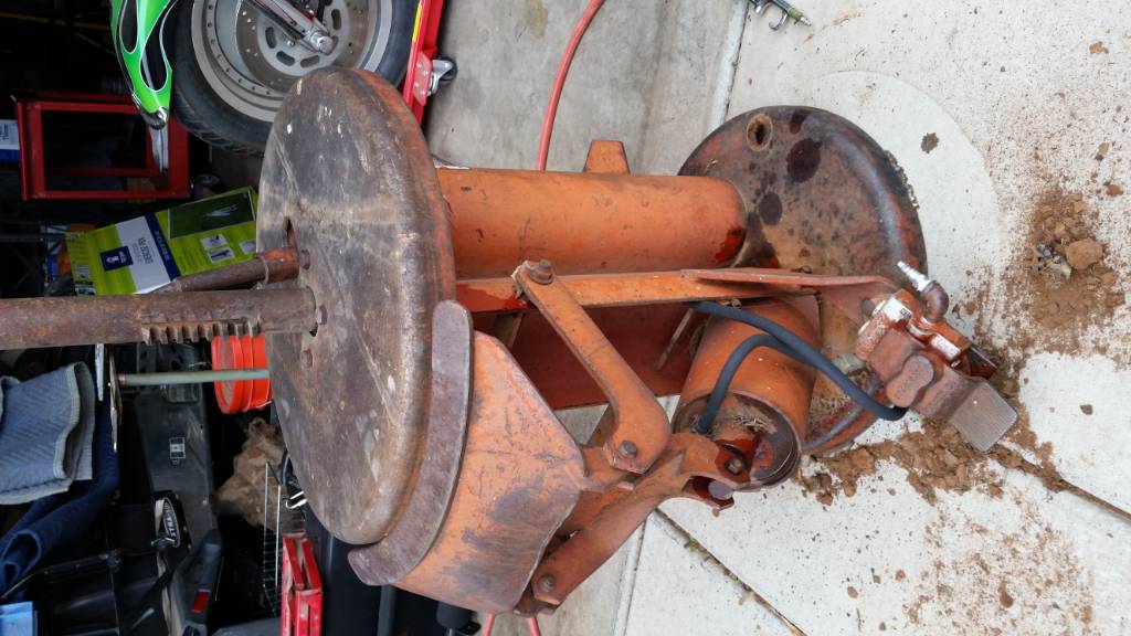

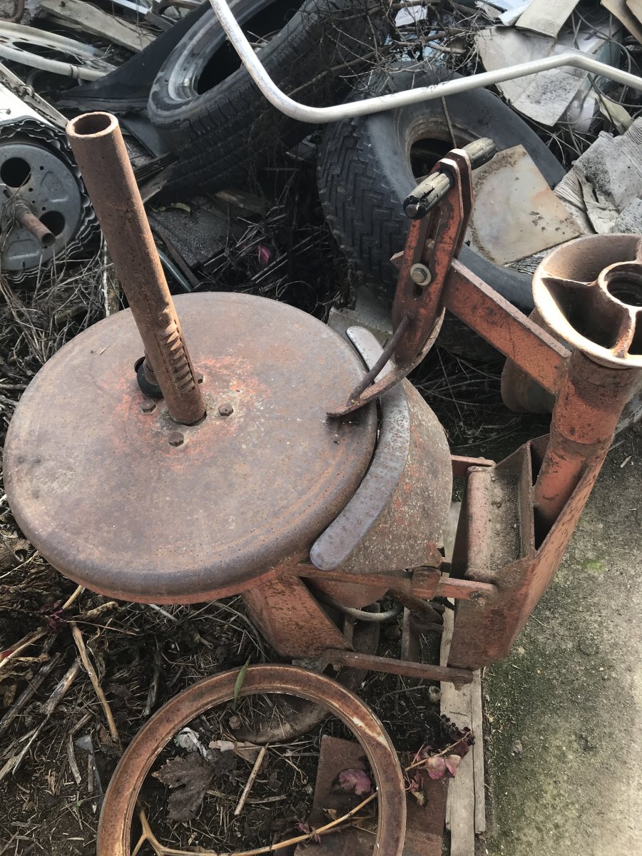

    Going to go look at an old Coats manual machine tomorrow. Guy has a couple of them, one together, the other he took apart to clean and paint. Pic he sent me it has the air powered bead breaker, he said on both the cylinders were froze up. Only thing is he doesn't have the dismount / mount bar. I looked on eBay, but didn't find much. Everything looked to be for the newer machines.

    That's the first tire machine I ever used. I have a bit newer model that has an air operated bead breaker for the bottom bead. You are missing the cone to hold the tire on the machine and a short bar that connects to the tab on the bead roller. Get those two things and you are in business.

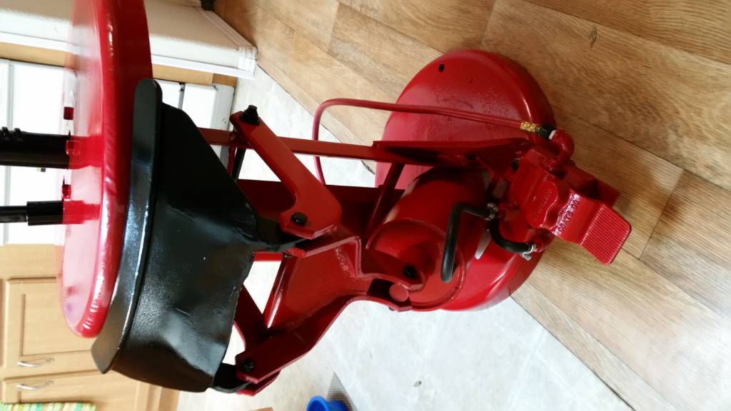

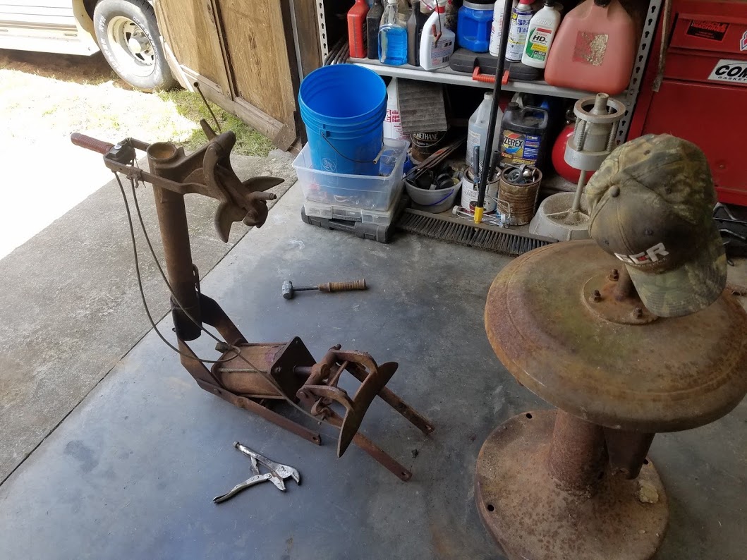

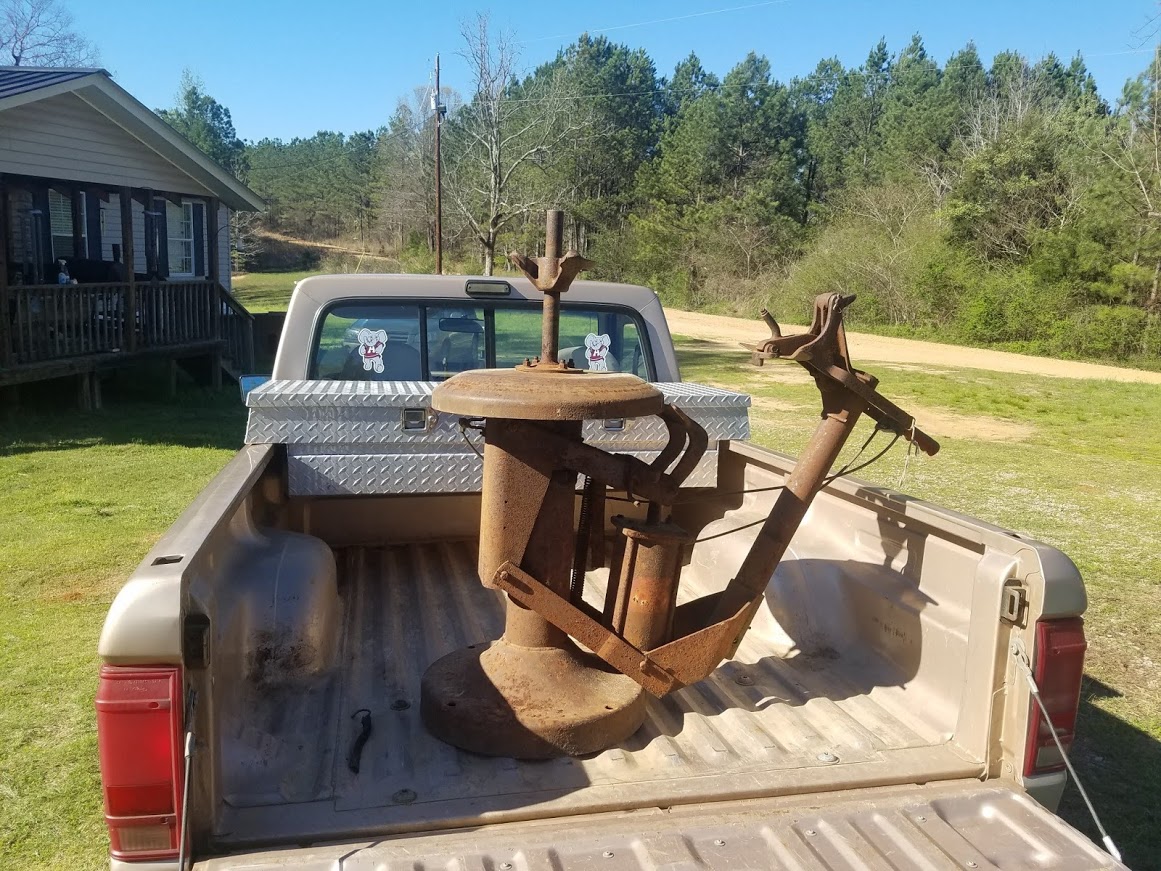

    Went and looked at it this morning, after the exchange of some George Washington's, it rode home with me. Can't find a model number plate on it anywhere, just ***uming it's a Coats. I have to rebuild the cylinder and put it all back together after I sand and paint it. tire machine.jpg tire machine 2.jpg
    Pics on his truck and in his shop.

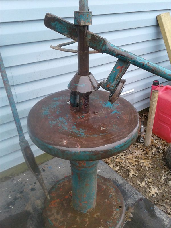

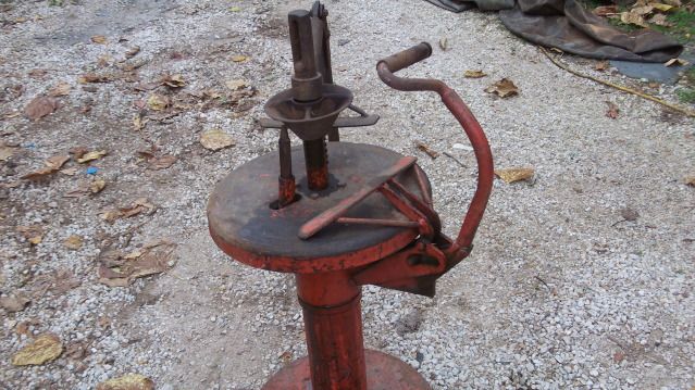

    I missed this thread when it got started but I first used one of those machines as a high school sophomore in 1962, used used one in the Pontiac dealership I worked in for 3 years in the 70's. Dismounting 4 Vogue bias tires that were like 6 ply and mounting 4 new ones kept you out of the gym that day. Then when I started teaching auto shop in 1977 the same tire changer I had used in the 60's was in the shop in the new shop building.
    A couple of shots off the net:
    First shows the tool that is used with the slot and is the bead breaker if you don't have the other style.
    Second shot shows one with the threaded cone that screws on to hold the wheel down that most of us are used to using. Those can be had on Ebay. Now that I look the cone is upside down on the blue one. I have never seen one of those bead breaker rollers like you see on the blue one in any shop I worked in that had one of those tire changers. I piddle potted around and didn't go buy one that was sale about 50 miles from me a couple of years ago.

    I still haven’t figured out what brand mine is, but pretty sure it’s not a Coats like I first thought it was. I rebuilt the cylinder and valve and put new lines on it, it does pretty good on 15” steel wheels. Tried it on a 15” aluminum, it worked, but chipped the rear rim in a couple of spots, looked like the aluminum was soft anyway may have been the reason. Tried it on one of the 17” wheels off the wife’s Expy, I couldn’t get the top breaker shoe high enough to go over the tire. Even tried turning it upside down, still no go. Thought about getting a piece of pipe the same ID as the OD of the bead breaker and cutting it and making the height of the top shoe adjustable for wider tires, but haven’t tried it.
    I still need to find a duck head bar to mount and dismount with. Still using a couple of flat bars, they work ok on the top, but a pia on the bottom. Oh, I bolted mine down to a piece of 3/4” plywood that is bolted to a wooden pallet. Holds it great, and I can easily move it if need be.

    I did a little searching on mr google last night to see if I could find any pics of one like mine. I did, turns out mine was made by a Studebaker company, Big 4 Industries. Time frame seems to be 1950’s to 1960’s. Couldn’t find much info about mine, although did see a manual on eBay for a later powered model made like a coats 20/20.

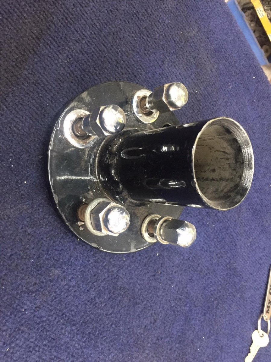

    My Dad had a Coats Iron Tireman manual changer in his garage when I was a kid. It was missing the top bead breaker, so he had taken the rear breaker off the machine and made it into the bead breaker. The downside was that you had to flip the tire to break both sides. I became very fluent with this machine in my high school years!
    About 30 years ago I found one at a yard sale that had all of the parts and was paired with a Bear bubble balancer. I didn't hesitate to buy it and still use it often today. My garage unfortunately isn't big enough to leave it bolted in place, so I set 3/8" anchors in the floor and bolt it down when I need it. 16139530129447536327638937855679.jpg
    16139527972469188224569398070483.jpg 16139528314112445071310722579932.jpg To Bobby J, I posted a pic of my top bead breaker for measurements.

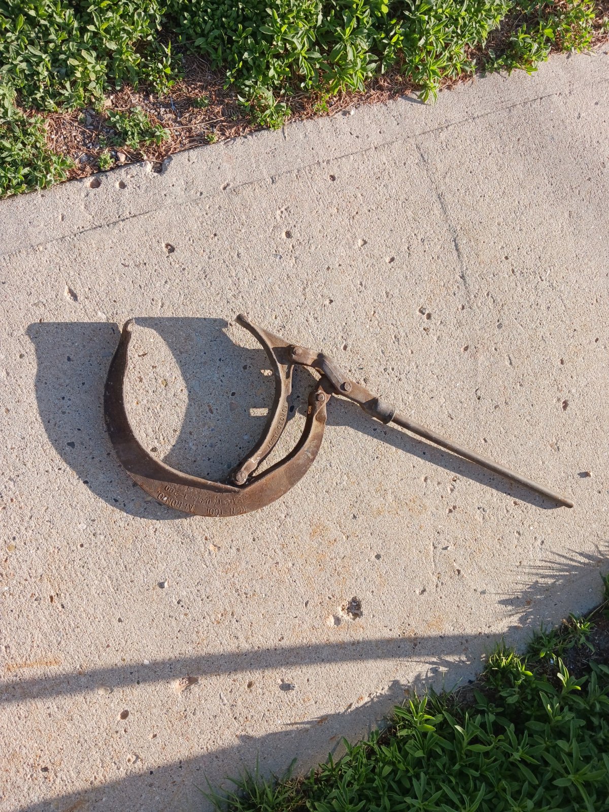

  27. Ok, I like to see that one in action.....

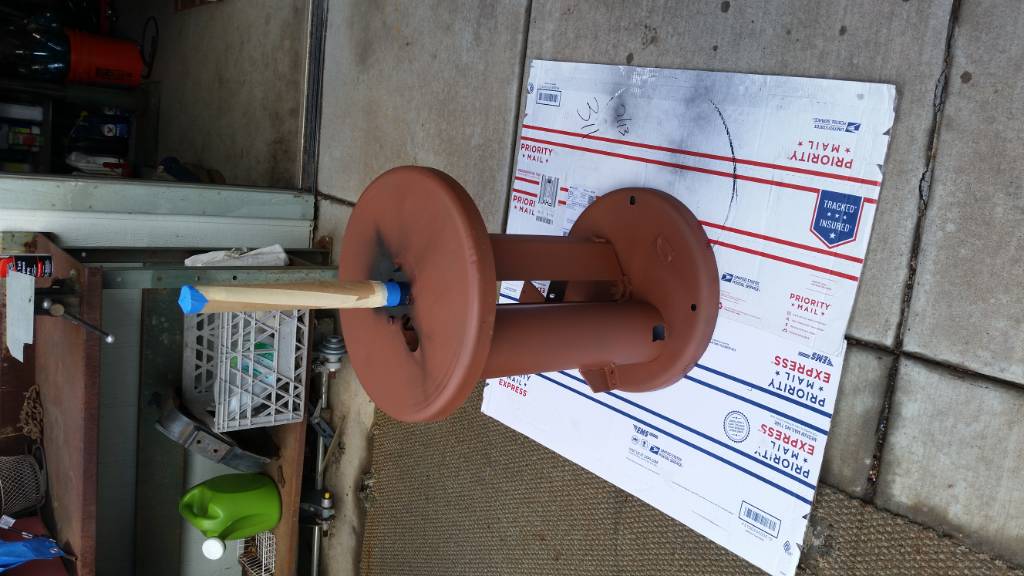

    So after I bumped this thread back up I found one for sale at a good price :D. I went to look at it tonight and bought it. It's missing some original parts BUT, it has some mods close to what I was going to do (and they look pretty solid). I give you the Coats Tireman 3 Star 2.0............in an odd color
    I can feel comfortable doing newer aluminum wheels.
