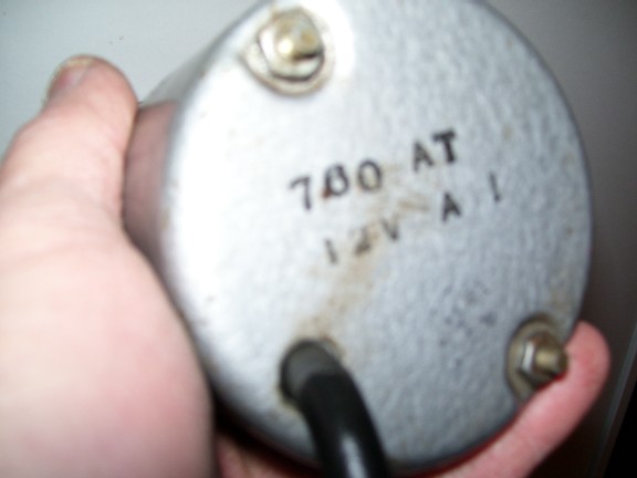

  19. I have this one, on the back it has a dial with 1,2 ,3, 4, 6 pulses per engine revolution.
    can it be hooked up or modifide to run on my 1962 283 SBC? (2 terminal’s not mechanical drive).
