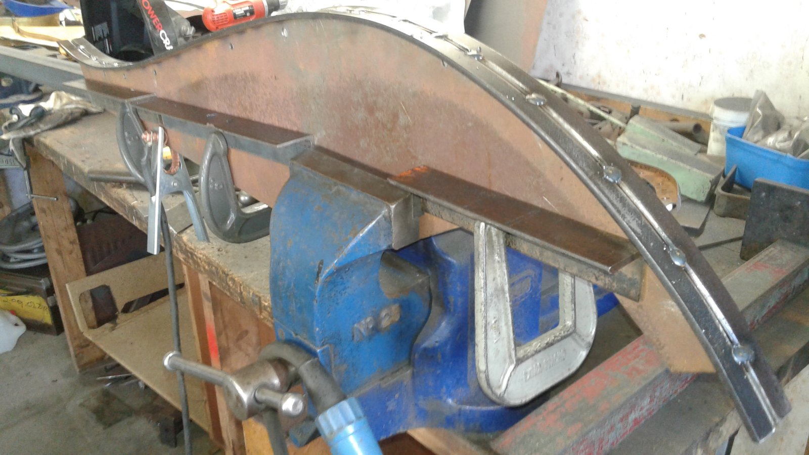

    I made my own by welding two pieces of flat bar to some sheet metal cut to the correct profile. Get at it with a large grinder with 36 grit sanding pad to get the profile. Finish it off with a body file. A bit of work, but less time than what you'll spend looking for some originals.
