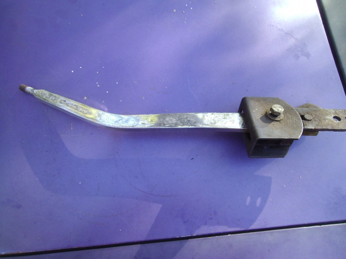

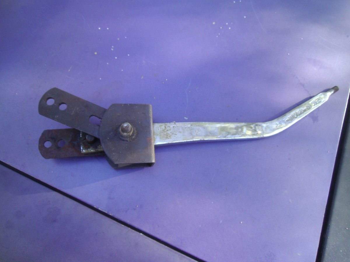

  25. Randy Routt
    Joined: Jan 13, 2013
    Posts: 614
    Randy Routt
    Found one, I know I have a foxcraft somewhere but there is a Mr Gasket, It looks better than the pictures, that you can get for 25 plus shipping. slides and stuff 006.JPG slides and stuff 007.JPG
