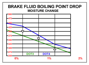

    Here is the boiling point of brake fluid and also the effect of moisture on the boiling point

    Wow, just a little moister really reduces the boiling point.
