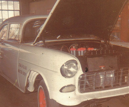

    Gassers needed 4 wheel brakes from at least 1964 (^^^^^see link to rules).
    Lots of Gassers in the 60's could have been turned into MP cars with a days work. A lot of them ran the engine in the stock location. On the tri 5 Chevys, the engine is as far to the rear as possible without a lot of firewall work. Many of the gassers had injection and the MP cars carbs, until the developement work with tunnel rams surpassed the hp available with injectors (probably late 60's).
    I've posted this car more times than I care to admit, but here's a typical lower class gasser from the mid 60's.

    Well, it probably didnt have the rear leafs mounted to the top of the rear axle either! Man, what are you trying to PULL??!!
