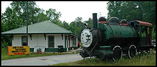

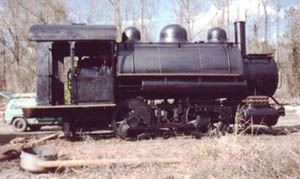

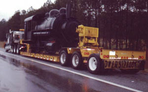

    This 1904 Alco locomotive was nothing but rust when I acquired it. After cleaning and degreasing we painted it with POR-15. That was twelve years ago and it's been outside ever since. Only where the POR-15 has literally worn away from the weather does the rust show through. I believe in the stuff. I don't have enough life left to dismantle, bead blast and epoxy every part so POR-15 is great for that get-it-runnin-and-out-on-the-road restoration. I've also used KBS and I went back to POR. Check out my build at http://www.jalopyjournal.com/forum/showthread.php?t=468936&showall=1

  29. So how did it hold up?
