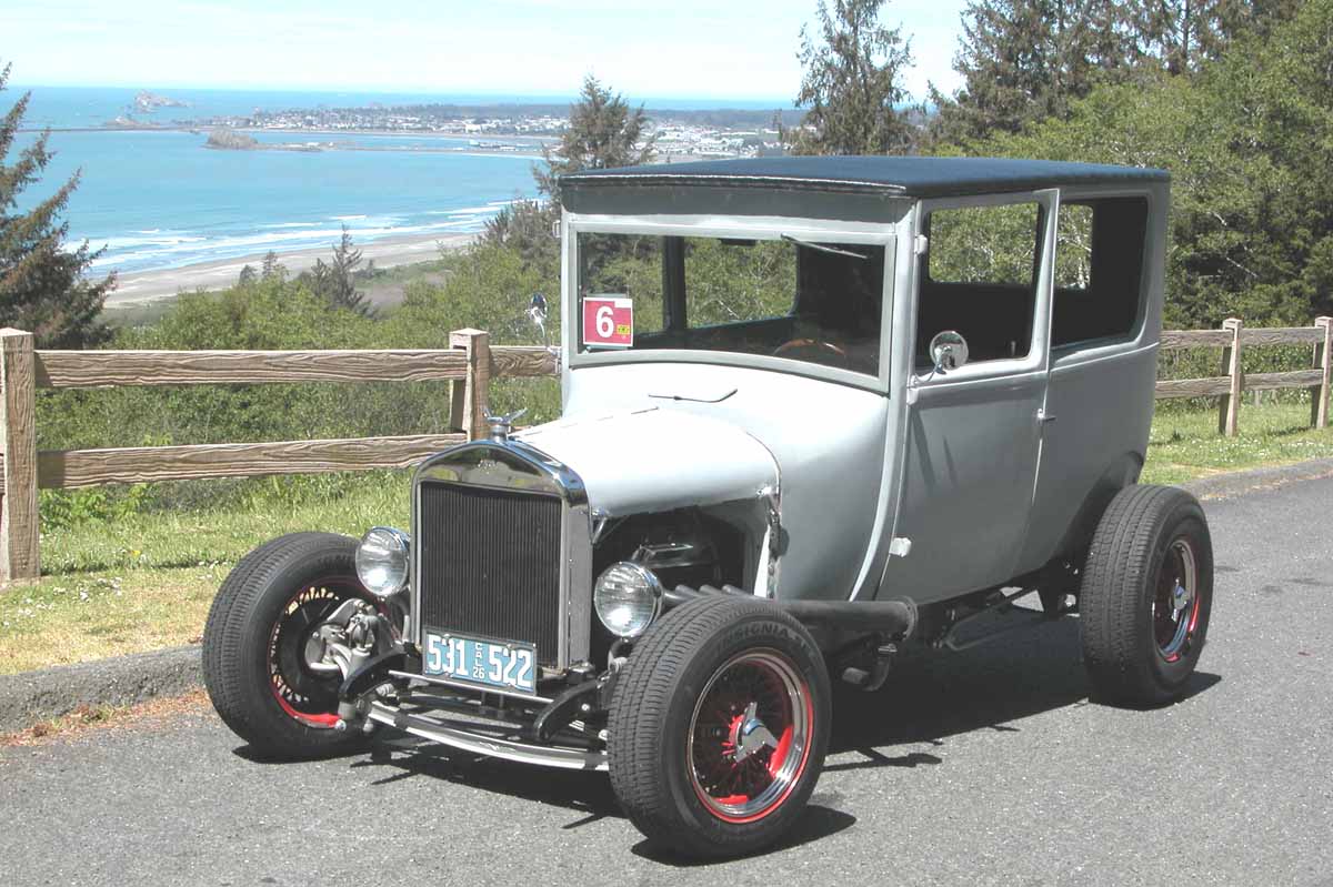

  19. I got tired of seeing the silver on my aluminum radiator on the T, so I fogged on some black paint. I had done a run up the hill, through the redwoods, and came home, parked it in the garage, and checked the temp gauge, and hit about a dozen places, including the radiator, with my infrared heat gun.
    Painted the radiator, repeated the same exact route, same ambient air temps, same speeds and as close to the same throttle position as I could, (except for having to nail it to get around a motor home on the way back to the garage from trip#2) and checked all the same places with the heat gun...
    Absolutely, no change... not one degree, no difference anywhere.
    Just my way of checking it out, your mileage may vary.

    26Tudor - Very scientific! Also love the "T". Kinda like what I want to do to my Dad's '27 tudor if he will ever let me get my hands on it. Got a 348 W engine waitin' in the wings for that..
