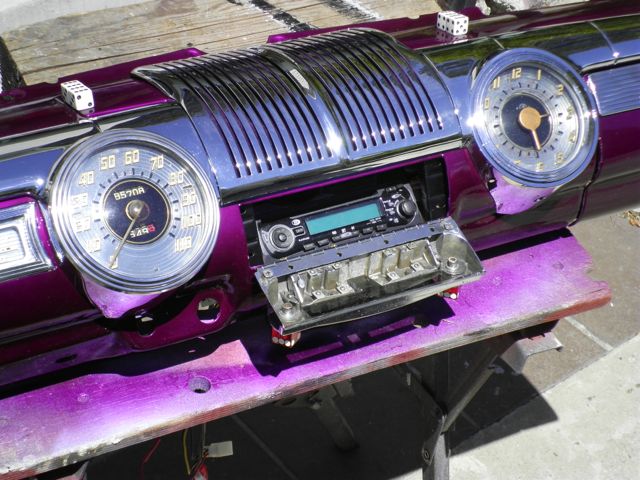

    Hey, I painted the dashes on all my cars with Krylon years ago.
    I think that's the clue. It was years ago when the paint was marked that it dries in a few minutes. 1948 Chevy Panel (4).jpg P1010010.JPG Misc Wagon Pics (10).jpg
