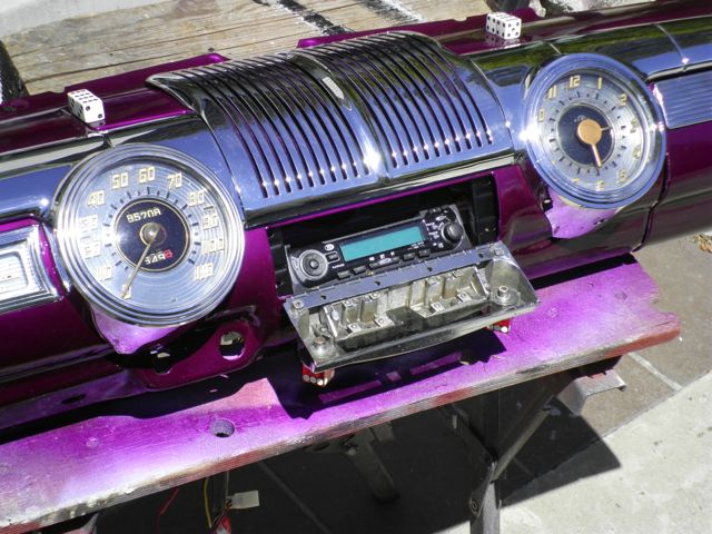

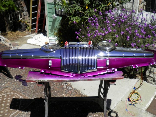

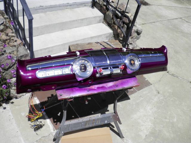

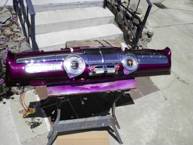

  13. steel rebel
    Joined: Jun 14, 2006
    Posts: 3,604
    steel rebel
    Thanks ******
    The way I got that deep metallic look is by using purple see through chrome rattle can paint over silver. Then spraying rattle can clear over it. Since it doesn't have any hardener in it you just have to give it some time to dry before handling it. The more coats you put on the longer it takes the first coats to dry. A few days before handling and a few weeks before wax.
    I spent a lot of time fitting and hinging the radio front. I hadn't figured out how to lock it into place when I first put it together. I discovered it just clipped under the speaker grill and no other locking device was needed.
    By the way those are Lincoln gauges in the '48 Ford dash.
    Model T1 likes this.
  14. I actually have some cans of metal flake paint here that go on pretty nice. But that look is excellent, chrome over silver? its like a candy paint?
    The Lincolnn gauges are a nice touch too.
    You actually hit the nail on the head about waiting for the paint to gas out. For some reason rattle can paint take a while and it is not for someone who is impatient. The dash on my Willys took a good month to get hard, of course it had several wet coats and that is part of it.
