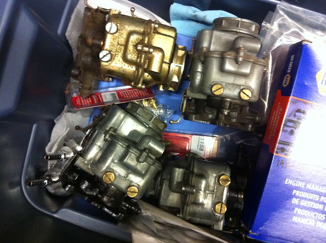

  15. Carbs, carbs everywhere. I've got old crusty ones...
    I've got sorta shiny ones...
    Gold ones and silver ones and rusty ones...
    How 'bout some ol' 97s? Got them too...
    and I've got a pair of 06H's with 4 bolt bases that I'm told are off a '38 Lincoln V12, and I think that's what I'm going to run...

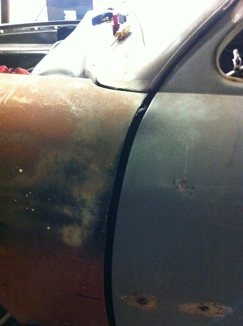

    Oh yeah, sheetmetal makes me happy until it comes to door gaps.
    WTF?!
    P***enger side isn't too bad and I think I can get it closer with some finagling, but the driver's side has a gap you can throw a friggin' mule through. I had both fenders off and on about 5 times each yesterday and I cannot figure out why the hell the gaps are SO far off. Everything else lines up, the bolts are in, nothing seems to be particularly bent or anything, but they look like ****. Totally took the wind out of my sails, I really don't know what to do. I have the old doors and old fenders, I suppose I could trim some off those and graft them on the new ones, but what a pain in the ***. I'm open to suggestions.

    Try welding some 1/8" round stock to the edge of the front of the fender, maybe two pieces?
  18. Ralphies54
    Joined: Dec 18, 2009
    Posts: 808
    Ralphies54
    Sorry, I meant to the "rear" edge of the fender.

    Looking good Andrew hope to see if in person in a month or so. I'm sure you've checked but since you've had all your floors and body mounts apart make sure the body and front sheet metal are square to the frame. That can cause a larger gap one one side.

  22. Hmmm... you might be onto something Ed. I've been pretty much eye-balling it, I wouldn't be surprised if the body is ****ed-off slightly, enough to mess up the door gaps.

    That body mounting issue could be the answer for this problem.Measuring and few body shims should do the trick.Are the other gaps ok?
  24. The other door gaps are good/tolerable but I'll probably screw them up when I start shifting and shimming this weekend :rolleyes:

    Just a thought,
    thats a new fender you have mounted?
    Try the old one before shimming the body,if it fits better is must be a fender issue.

    Big A, my 50 has the same door and trunk problems. Always seems to be the drivers door do to more use. I can't bend ,torch, or beat them into submission cause the car is finnished. Thinking body shmming might help but waiting on your tallents and skills to see what you come up with. Body has not been off the frame. Love this little car but the body gaps drive me nuts. Building and aligining old fords for 50 years but this one needs your continued build thread for a solution. Can't wait to see what you do.
    Thanks man you are a genius. And thanks for the thread. Jack;)
    Does not look to bad in the pict but the door wont close with out slaming it. New striker plates and latches and adjusted 500 times,well at least 20:D Belt line only off about an eighth inch. Any tips from anyone? Thanks so much.

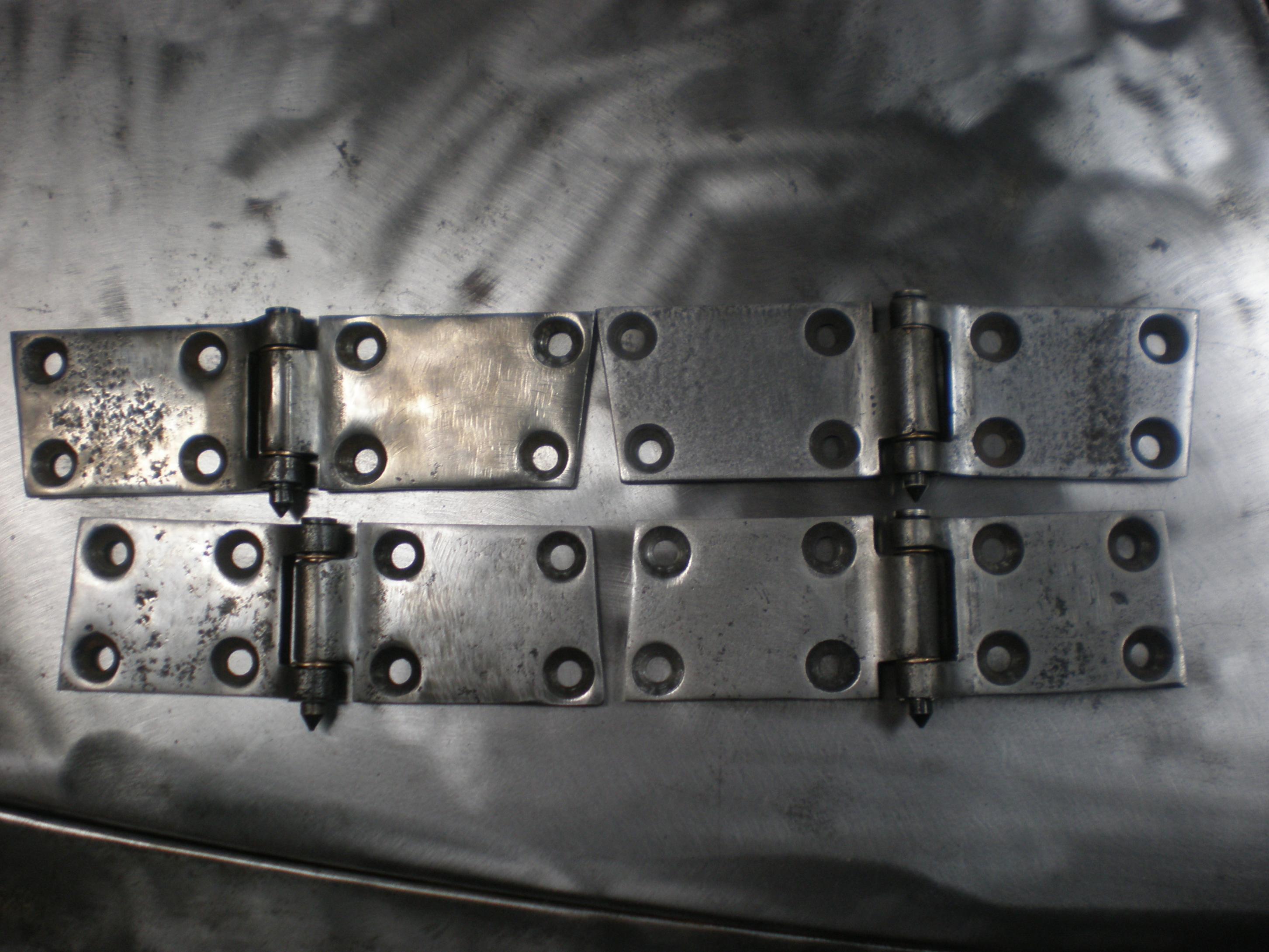

    Big A - I may have the answer for your door gap issue. When I rebuillt the hinges on my 51' I found the 2 ears on the hinge plate that mounts to the A pillar were totally out of whack. As I rebuilt my hinges, I bent those 2 tabs back a little (or toward the front of the car) and this solved my door gap issue. They don't take much bending to move the door gap ALOT. I didn't use heat to bend those ears - just mount the plate in the bench vice and a bit of tapping with a 3-lbs sledge. I have attached a picture of my rebuilt hinges for reference.
  30. EssexCoupe
    Joined: Sep 30, 2010
    Posts: 176
    EssexCoupe
    from Vantucky
    In that picture you can see how the hinge plates to the right have an ear top and bottom. Just take and bend those ears a bit to get that gap to close up. Hope this helps.
