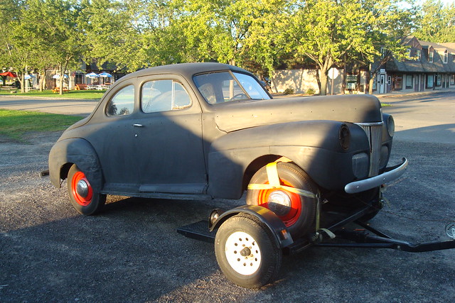

  19. Haven't touched the shoebox in 5 or 6 weeks, but I'll be back on it one of these days hopefully soon. I think I needed a break, didn't plan on taking one but things have been crazy busy lately so it was forced on me. I bought a house with a nice 20 x 30 garage so I'll be bringing the whole circus across town in the next few weeks. I also bought a '41 Business Coupe project that is sitting on the wrong side of the Canada/US border at the moment. Hope to have that here in the next few days. It'll get tucked away until the shoebox is on the road.

  22. Got the '41 across the border with no drama, and sitting in its new home. It's going to sit until the '51 is on the road. I'm anticipating this shouldn't take longer than another 12 or 15 or 40 years...
    Trying to get the '51 moved in this coming weekend, but also need to do some work on the garage first. Going to be chaos for awhile.

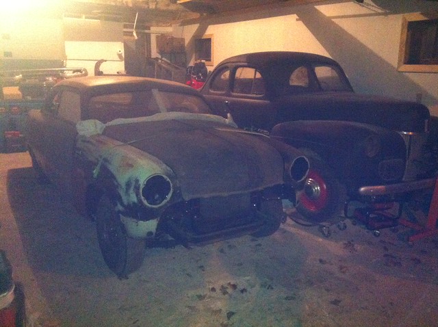

  25. Nothing new to report, haven't really touched the shoebox since... August. Ugh.
    Finished the big move yesterday. With the hood on, this is the most complete this car has been in over 2 years (looks can be deceiving)...
    The big new garage has gotten awfully small in the last couple of weeks, but these 2 look pretty much at home next to each other...
    Going to spend the next few weeks getting more organized and trying to create some room to work. I might even work on my car again some day.
