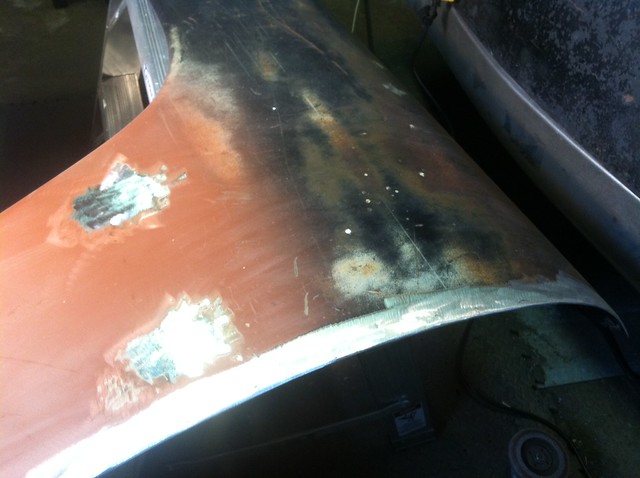

  2. 'Bout damn time I updated this post, right? What the heck have I been doing for last 5 months?! Life mostly, but I have managed to get a little car time in here and there.
    Got my door gaps mostly figured out (thanks Ralphie and others who suggested adding filler rod).
    Started with this...
    Stuck a little of this on there...
    A little weldin', a little grindin' (and some swearin')...
    Hella better (it's actually a more consistent gap than that but I was jammed between 2 cars, taking a photo with my phone while holding the fender with my knee, drinking a beer and juggling a flaming chainsaw at the same time). Take my word for it...

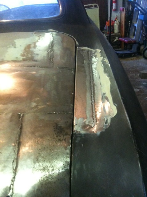

    Ok, so back to the damn trunk lid. Just wasn't happy with the ****ty job I did originally, so I decided to do another ****ty job to it...
    Happened to have a chunk of steel lying around...
    Cut the old **** out...
    Zip zip zip, zap zap zap...
    Didn't get any pics, but I also cut the trunk opening sides out and replaced them with some straight pieces (how novel!)...
    Still some minor tweaking to do, but getting there...
    Yeah, I'm still a ****ty welder.

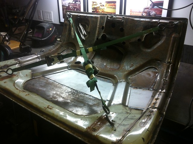

    Ok, so all this fargin' around with the trunk lid left me with a frankenstein-looking thing on the underside. Plus, I still had some fitment issues, so I cut some relief cuts in the inner frame and used some straps to pull it into the desired shape (while it was still on the car)...
    And there were all sorts of random cuts and scars leftover from that knife-fight we got into over some drunk chick in Scranton...
    More zipping, a little zapping...

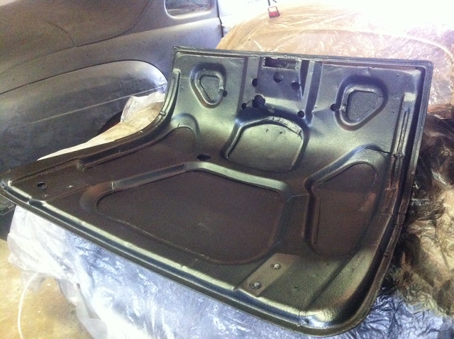

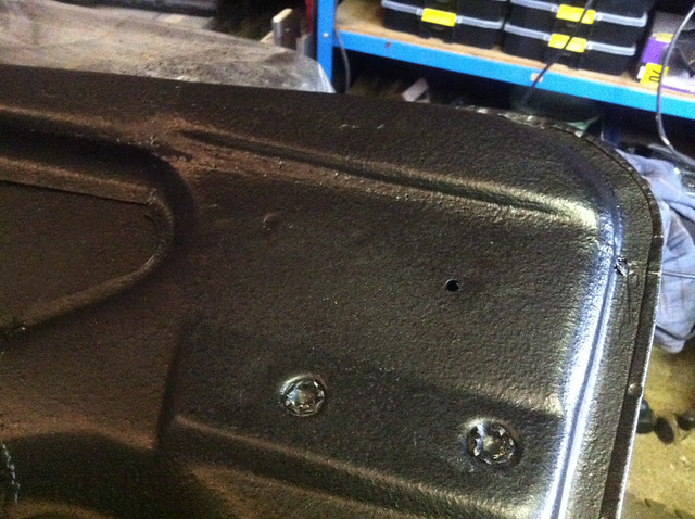

    Grind grind grind, drink beer, grind, spray some black stuff to cover up the ****ty welding and it's looking like a dang ol' trunk lid again...

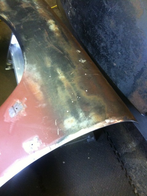

    Other than that I've been filling holes and removing paint. More on that to follow...
