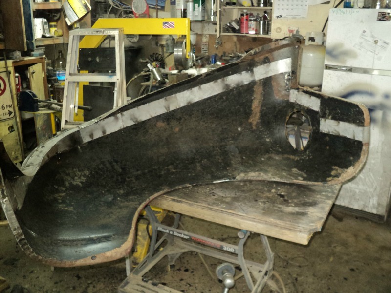

    Here is a method that I use, it works on the old asphalt based undercoating.
    I found that by using a piece of 1/2"copper tube over a straight chisel in my air hammer it will do short work of it.
    With the pipe hammered into a chisel the copper is too soft to damage the steel but hard enough to chip off the asphalt.

    That copper tube chisel looks like pretty fine solution.That factory tar **** can be real pain in the ***,i know it because i've peeled most of that stuff out of my shoeboxes body..

    That's some great thinking! Copper tube is cheap too, and would be easy enough to replace! GREAT IDEA!

    There is a down side, you have to reshape the chisel end every so often. the piece you see here started out 3" longer then it is now ,it tends to break off when it work hardens......

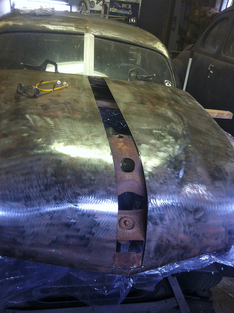

    Looking damn good! Just saw the peaked hood.

    damn nice....naked car and a peaked hood.

    Looking good bro. I'm really diggin the hood peak.

    Holy Shieat Andrew!!! You aint afraid to cut anything up ; ) thats a ton o work for a peak. Looking great brother!
