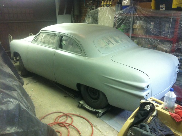

  12. Nope. Still sanding...
    And sprayed another coat of primer. I won't be posting any close-up shots quite yet, still not done...
    Oh boy. More sanding to do this weekend. :rolleyes:

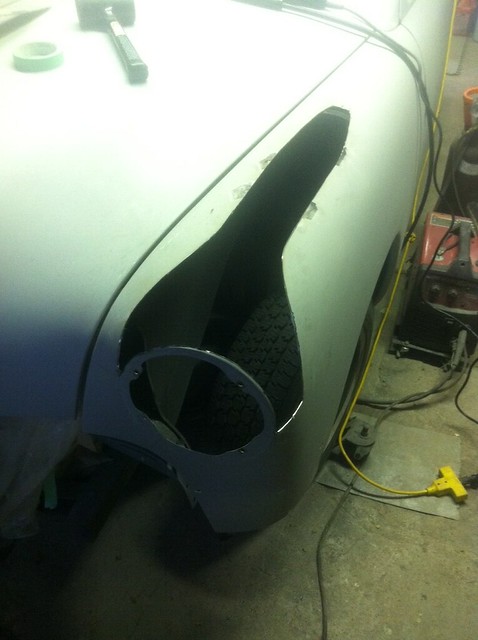

    Alrighty then, moving right along... I'm sick of sanding, need to do something on this to get my energy level back up. So, what haven't I messed with on this car? Let's find some virgin steel and cut it :D
    I've had a set of '56 Olds headlight rings stashed away for years. I've looked at all kinds of different ways of using them, most of which involve using Olds buckets and pieces of the Olds fenders. '56 have the nice peak on top, which is hard to replicate... or not tooo hard, as it turns out. I didn't have any luck finding Olds fenders or buckets, and I read a Street Rodder article using the stock Ford buckets so that's where I pointed my comp***.
    First of all I need to clean up the old rust buckets...
    Whip 'em through the sandblaster and hit 'em with some Rustoleum, they look almost p***able...

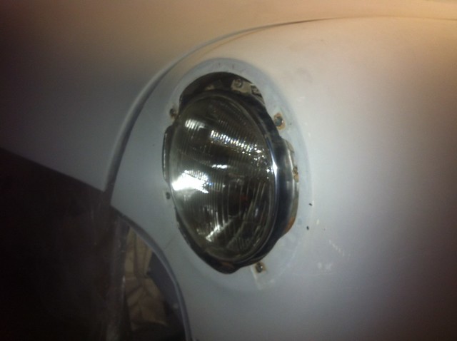

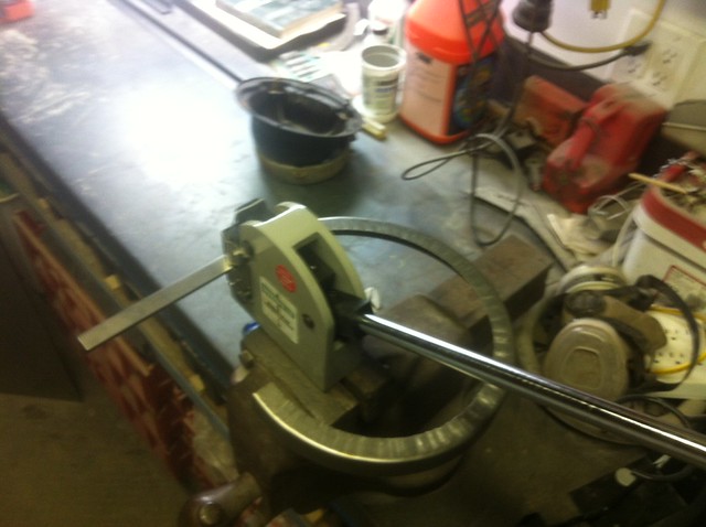

    Now, just attaching the Oldsmobile rings to the Ford buckets makes them stand out like a fake ***, so I needed to pull the buckets back about 3/4". I also want to be able to install bulbs and make adjustments from the front (one of the things I dislike about typical frenched headlights is guys mount the bucket from behind, then have to pull the bucket out every time they need to access the headlight).
    I started with some 18ga, bent 90°...
    I'd never used a shrinker before, but it turned out to be a pretty simple operation to make a fairly decent circle...
    Tacked the fairly decent circles to the buckets and after some farting around getting the holes etc. in the right places, I ended up with these...
    Which sets the bucket back in the fender...
    What that pic doesn't show is the mounting tab on the bottom. I pop-rivetted them on and things were ticketty boo. That's the easy part.
    Here's where the real fun begins...
    I wanted the natural crease in the stock fender to line up with the peak in the headlight, so I stuck a hunk of rod on there as a guide. Looks a little crooked in that pic, but it was where it needed to be...
    That gave me a good couple of starting points to work out a template. I wanted to transition from old steel to new at a point where it would seem natural, and that took a little finagling...

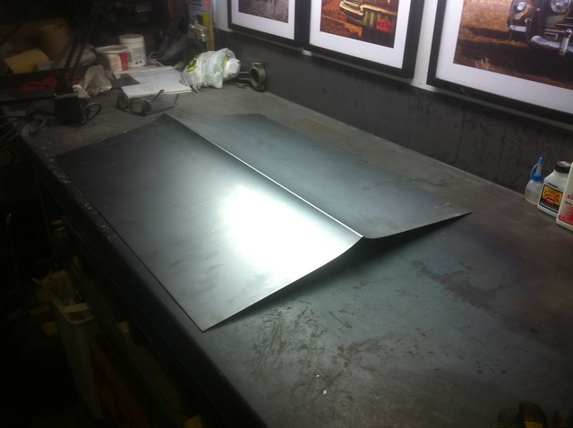

    So how the hell do you make that crease? Same way I made my hood peak. Started with a sheet of 18ga, bent to about 75° (I didn't want as big/sharp a crease as the hood, so I convinced myself that 75° was about right... highly scientific guessing)...
    And I just started flattening it using my wimpy little schoolgirl hands, don't want tool marks in the steel...
    Once I transferred my pattern and cut out the shapes, then I pounded it into a closer approximation of the final shape using a dead-blow hammer and a block of wood...

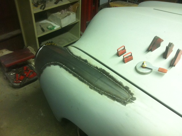

    I tacked a chunk of tubing to my bench with a small gap underneath so I had something to help with shaping...
    Then I tacked the roughly shaped steel onto the fender and pretty much just pushed it into shape...
    Talk about frickin' nervous. I looked for a couple of years before I found a nice set of fenders I could afford. Found 'em in Missouri on my way to the HAMB Drags, and BenD and Marcy brought them up north for me. Nice, solid, original sheet metal... that first cut was almost painful... but I got over it :D

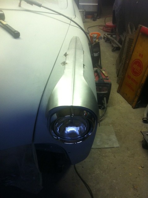

    Still need to do lots of finishing, but the first one came out pretty alright if I do say so...
    The peak worked out...
  24. I still need to make a filler piece under the eyebrow, and a bit more ******* & dolly work to make the shape 100% right...
    And then I get to do it all over again...
    To be continued...

  29. Thanks guys. I'll get some better pics up once I get things a bit more finished. I lost sleep over this for a long time before attempting it, gotta say I'm pretty happy with the result so far.

    ballsy, but turned out great! they will look awesome with the peaked hood. Bravo dude
