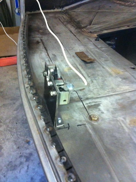

  28. You might think after all this time I could show some pics of me terrorizing the neighbours with smokey burnouts or something.
    Yeah... no. I've accomplished next to nothing in the last 6 months. Lost my mojo, and it was too damn cold to thaw it out, but things are very slowly creeping along again.
    About 3 years ago I made a little trunk latch dealio that was kinda flimsy. It worked, but it would flex and I just never really liked it much...
    So I put pen to paper and came up with this...
    Which I made into a little posterboard mock-up because I'm crafty like that...
    Once I figured out that it would fit and made some adjustments, I transferred the pattern to 18ga...
    And got to snippin', grindin' and drillin'...
    ...and (the fun part) bendin' and weldin'...
    I also made a new inner tail pan, which was all sorts of compound curve bending fun. No pics of that process.
    The new latch support is in, does what it's supposed to do and is a helluva lot beefier than the last one. I just have a hunk of wire on there for now, hopefully today or tomorrow I'll figure out how to route a cable from somewhere. Not quite sure if that's going to go inside or outside the car. It won't be powered, just a hidden pull.
    How's that for the mother of all updates?! We waited 6 months for that? A trunk latch? Good lord. Worse than the Walking Dead season finale. Sheesh...
