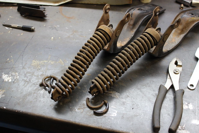

    Back to the oh-so-exciting world of trunk lids. Mine didn't fit worth a damn, and it seemed like the springs in the hinges were trying to force it open at the leading edge (closest to the rear window), so time to have at 'er...
    I popped the hinge pins out and pulled the entire mechanism out...
    Now when Mr. Bleed chopped my car, he lengthened the trunk lid. Shortened the package tray. And hacked the **** out of the hinge boxes. Nothing a few goober welds can't fix, right?
    Oh, Mr. Bleed. Alright, I cut them off properly and fabbed up new tailpieces...
    I drilled a few more holes thinking I could move the hinge pins and give them some adjustability. Smart idea right? Wrong. Don't do that, it doesn't work.
    The springs still seem to be too forceful and the lid still doesn't want to sit properly...
    So I cut some coils off the springs...
    I ended up taking 3 coils off and that helped. I'm going to take 1 more off I think, then I'll probably add a gas strut of some sort to help get the lid up. It's a heavy ****er, I'm amazed it still doesn't sit down quite right.

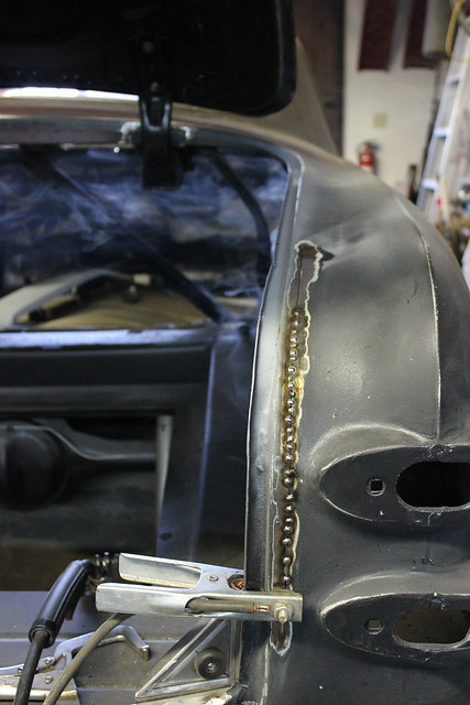

    Next up, more cutting. Not happy with the wonky trunk gaps, so I cut the body and moved things pretty much where I wanted them to straighten up the lip...
    Then I trimmed a chunk off each side of the trunk lid and using my carefully calibrated paint stirrer, I welded 3/16 rod to give myself a nice edge...
    Lots of welding...
    Lots of grinding...
    ...and I don't have an after shot. It's not quite done yet, but it pretty much lines up, latches and sits... almost... where it's supposed to...
    Pain in the ****, I'm tellin' ya.
