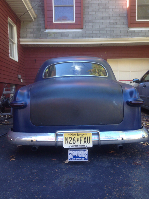

    The deck lid turned out great. I turned my 50 deck lid into a 51 when I swapped hinges too but could never get it to fit right took springs out fit better but was never happy with how it say. I ended up buying a 51 off craigslist that no body wanted and the guy said $20-25 or I junking it so I bought it. Have to reshape the license plate but I'm way happier with it. ImageUploadedByH.A.M.B.1446823172.493507.jpg

    Wow, that lid fits very well. Chris at ShoeboxCentral told me that the '49's were the worst as far as the gaps are concerned. I'd have to say that the trunk lid is actually a different shape. Had to do a little cutting on my fenders to make things right........

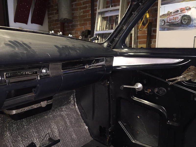

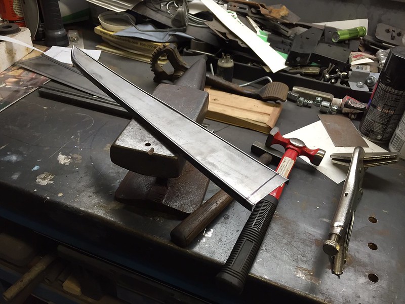

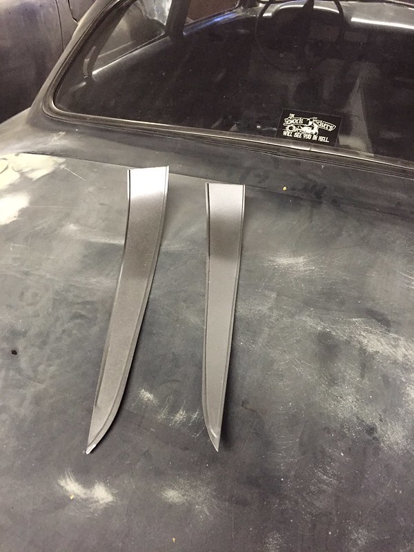

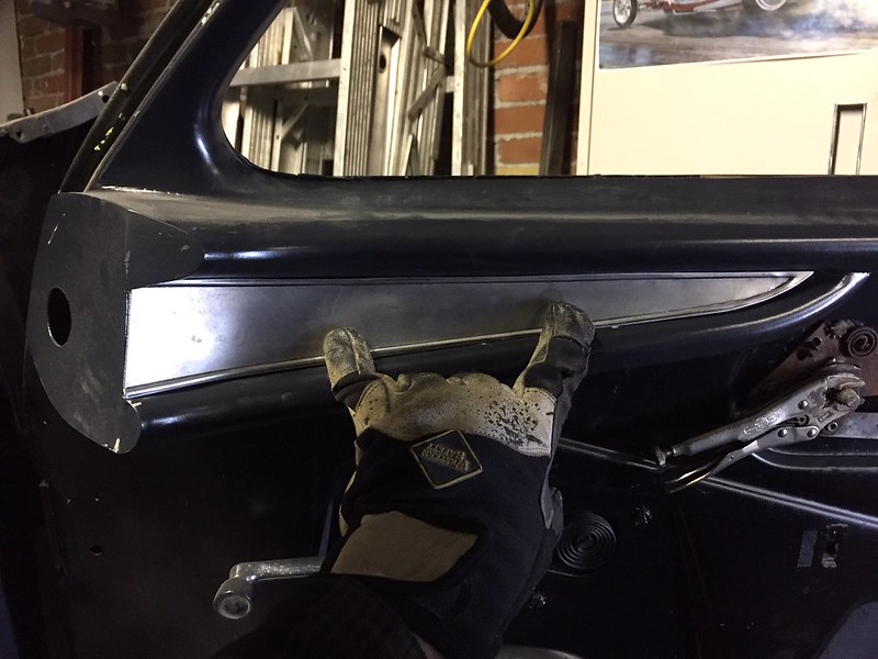

  21. I've got some stuff in the works again finally, hope to have a bigger update to report in the next week or 3. In the meantime, I just needed to do something other than sanding to see if I could get myself interested again.
    A small job, but one that's been chewing at the back of my brain for a long time. Since I made the dashboard "wings" that wrap onto the doors, there's the problem of the chrome strip that runs through the gauges and glove box and should run into the wings.
    I made a paper template and transferred it to some 20ga...
    There are some tricky little beads that needed to be rolled, right up close to the edge, so i did that before t******* it out...
    Trimmed out. Curves are easy enough with an angle grinder if you use a cutting wheel that's pretty worn down in diameter...
    Did a little sanding and grinding to smooth it out...
    And just bent it over my knee like I was giving Betty Page a spanking to get the right-ish bend...
    Got the other side done too. Still have to fine-tune, they both need some touch-up, and I may actually make them again to see if I can do a better job, but at least I wasn't doing body work. Pretty happy with how they turned out.
    Not sure if I'm going to get these chromed or how to finish them. The rest of the dash insert pieces are chrome, getting everything to match is either going to difficult or expensive.

    Looks great man. I would say if the rest is chrome, ideally that would look best. But body color paint could look decent too...
  23. clemsoncrewman
    Joined: Jan 22, 2009
    Posts: 501
    clemsoncrewman
    Those look awesome! Chrome!

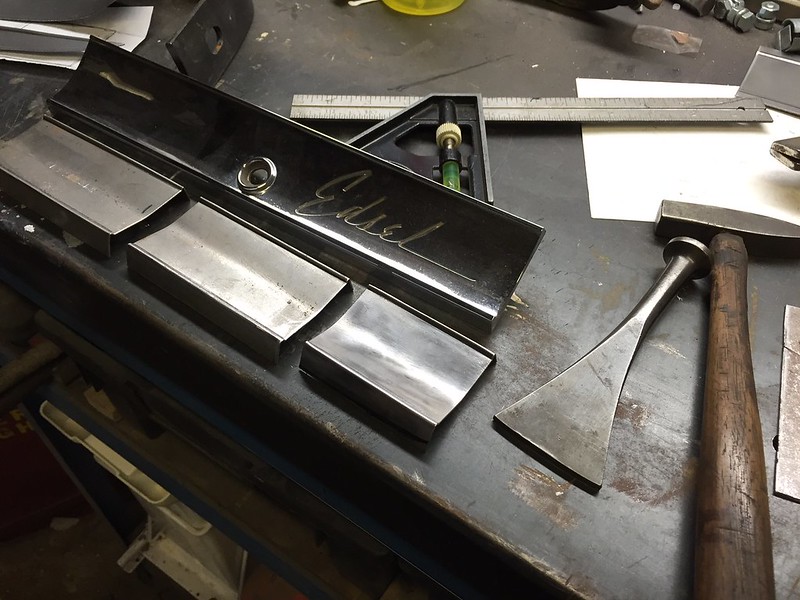

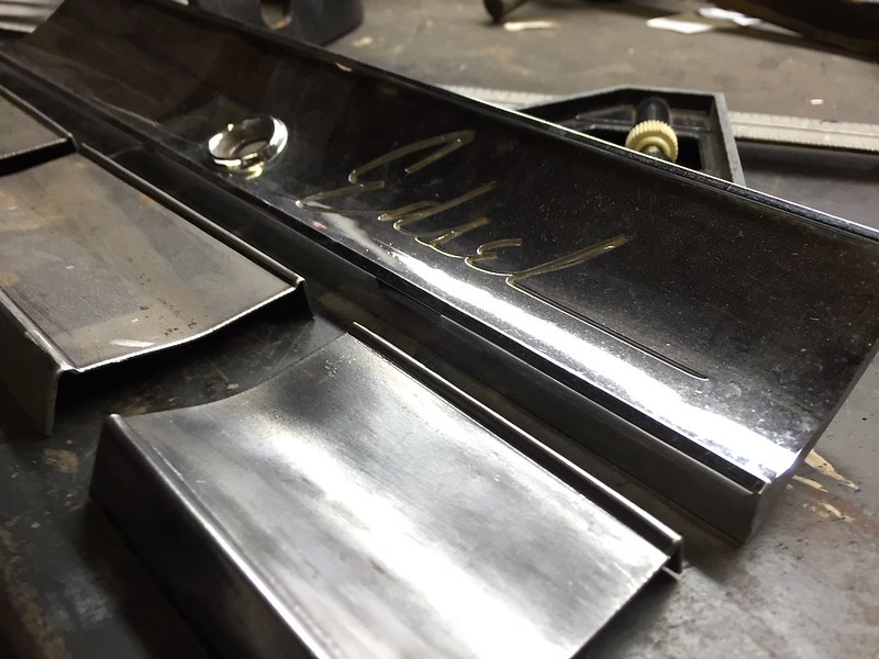

  30. A little more metal banging on the weekend. Since I rearranged the dash and lost the clock, there are a few small pieces to make to fill the gaps...
    The shape seems simple enough, but not that easy in practice (especially without a tipping wheel).
    But I managed to get it pretty close...
    Found it easier to make each piece separately, instead of one long one then cut down. These still need some fine-tuning...
    You can see the gap fillers on either side of the glove box. They're just held in with magnets, so not 100% lined up...
    First time since I cut it all up that I've had the inserts etc in place. Starting to look like a dash...

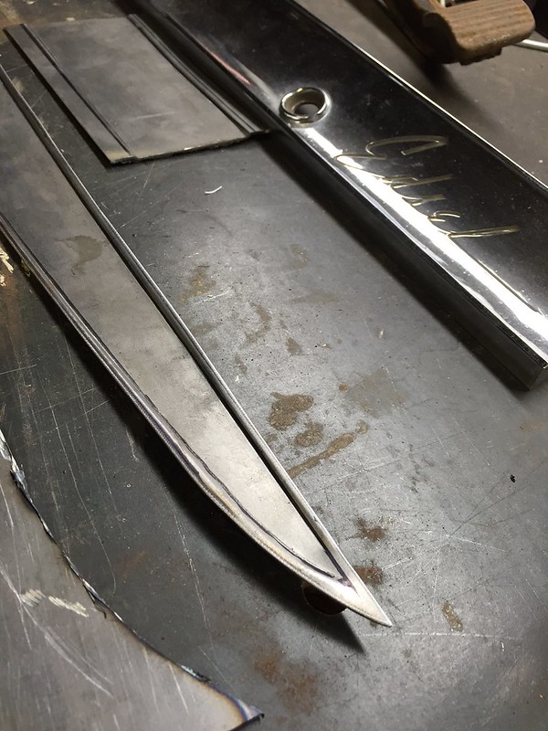

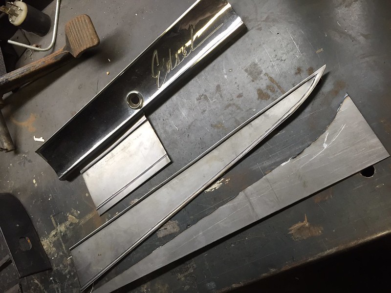

    But now I'm really unhappy with the first wings I made, so I started to make betterer ones with more accurate character lines...
    Lots to do yet. Ran out of time as usual, and won't be back in the garage for 3 weeks. Never enough damn time.
