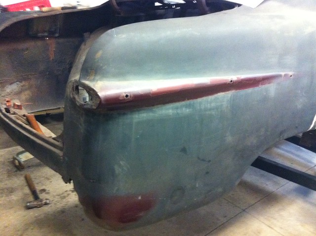

    Backing up a bit, here are some shots of my shenanigans with the taillights. Cut 'em out, slap 'em in, how hard can it be, right? Well, for an idiot like me it was a bit of a struggle…
    Right off the bat you can see the contours are not the same as you move down the body…
    That's a fairly serious curve for something that on first glance looks pretty straight…

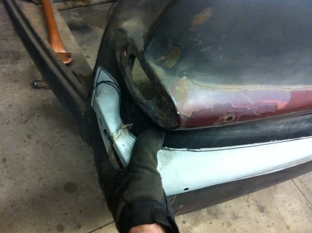

    When I hacked this out of the donor car I really should have paid more attention. I guess my grade 3 teacher was right, neatness counts! So I stuck it in the vice and cleaned up the lines…

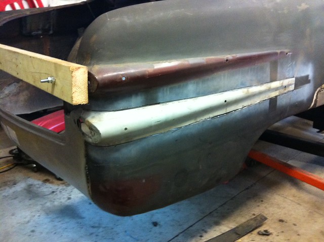

    Lots of highly technical eye-balling to try to get the body lines where I needed them...
    First try to get them lined-up, kinda surprised myself. Looking not so bad…
    Had to trim off a lot more meat than I originally thought…
    Lots of measuring, head-scratching, lining up holes and anything else I could line up. Chalk lines, Sharpie lines, and then I sprayed some primer down so I'd be able to see where to cut...
    Talk about stressful. About the only reasonably solid panel on the whole damn car and I cut it. I also had to install the tailpan before I could continue with the taillights...
    A Holy **** moment! The damn thing fit…

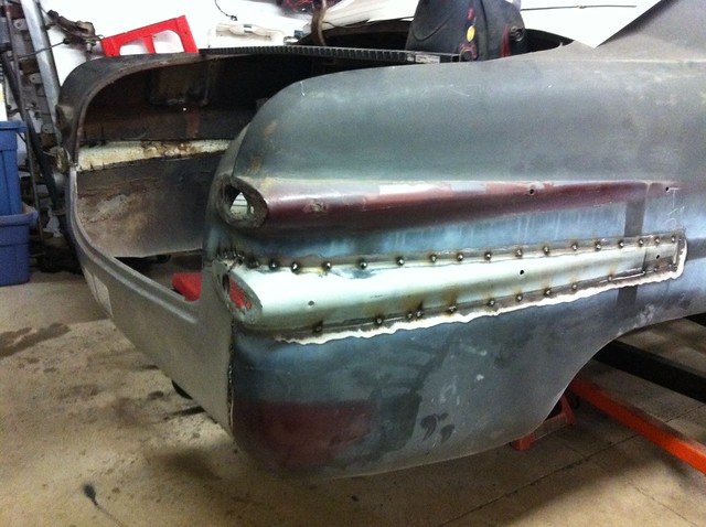

    Ok, once the first side was in I still had to tackle side 2. I was thinking I must be an idiot, but I got through it...
    Yesterday I got in and did some of the finishing. I'm a ****ty welder, but my grinding skills are improving...
    I don't think Brian B*** has to worry about the compe***ion, but I'm happy enough. Lots left to do...
