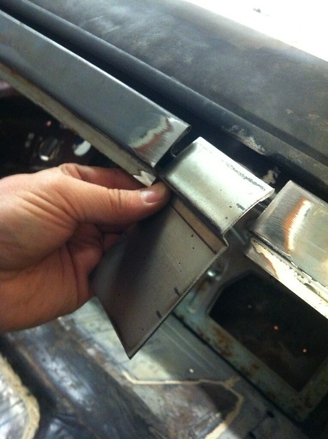

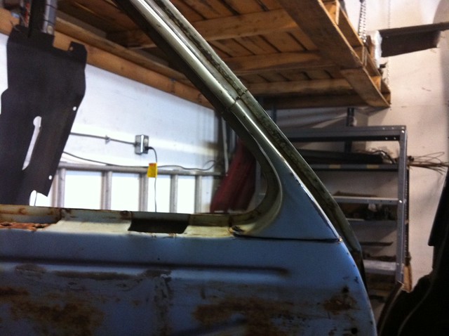

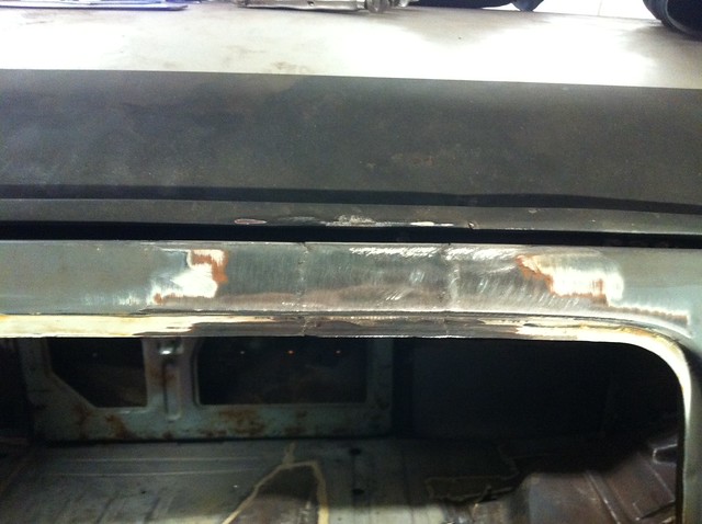

  5. Nothin' to it, but to do it. Get things cut and lined up, used a stiff straight-edge to keep things aligned...
    I planned to use the chunk cut from the front of the doorframe to fill the gap in the top, but after I chewed on it for awhile I decided to just make a new piece...
    Needs some finishing yet, but looks pretty spiffy...
    Looks pretty much like a door if'n ya ask me...
    ...'cept the angle of the dangle has changed somewhat...
    Got the p***enger side to this stage today too. Tomorrow I'll see if I can actually get them to lay down and be good like they're supposed to.

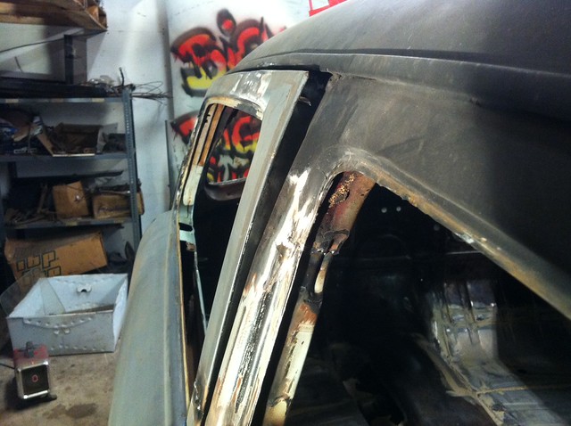

  16. A couple of well-aimed slices, inside the door at the A and B pillars...
    I clamped them against the body and snot welded 'em...
    Seems to have solved the dang door wang...
    Got some clean-up to do, but both doors are playing nice now...

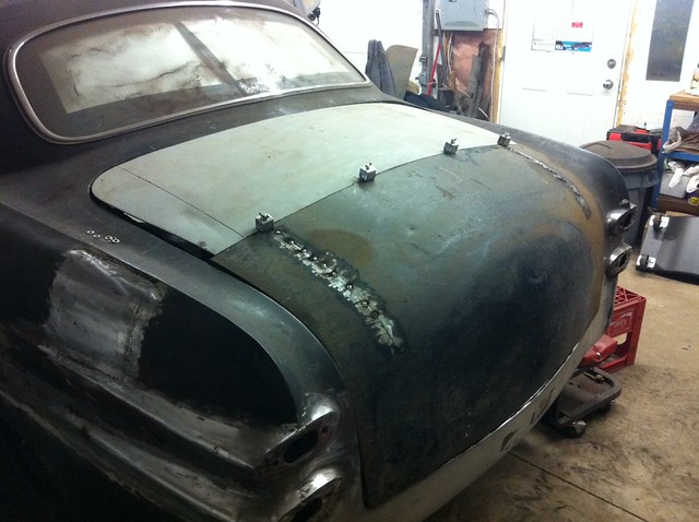

    Ok, so when Bob chopped this car he moved the rear window, and thus (thus! big little word, eh?) extended the trunk opening, about 6". That way you don't end up with a big space between the rear window and the trunk opening, looks more stock. He 'splains the principle pretty well in Mad Fab III (available wherever fine greasy hot rod DVDs are sold), but doesn't get into the actual how-to extend a trunk lid part.
    So, I happened to have a couple extra trunk lids lying around, so with my trusty cut-off wheel in hand and not a friggin' clue what I was doing...
    I used the ol' "dirty glove trick" (hey, not that dirty glove trick) to make a paper template, so I could see how the 2 pieces would or wouldn't line up...
    Using said template, I figured out how much to cut off the first victim...
    It was pretty beat up across the back, but in good shape where I needed it, so no great loss to cut this one...
    Setting it in the hole you can see that the shape of the opening no longer follows the stock contour of the lid. This will take some work...
    And after slicing another perfectly good stock lid, it was about a 1/4" too wide for the opening, so I gave it a couple of relief cuts to narrow it by a blond one...
    Which brings us to here, before I ran out of time...
    The upper piece will get pie-cut and spread apart about 1/2" on each side, I think.
    I've got some time to mull this over before I make any more cuts. I'm headed to Detroit for the Autorama this weekend, so won't be touching this for a couple of weeks.

    I would get the trunk edge straight and welded, then match the chanel on the body to the trunk.
    Trunk Plan B: make sure your widening cut on the forward section is in the same spot as where you narrowed the back, that way if you can't get it all welded and flat, put a couple ribs down the trunk over the top of the slices. Hell maybe even a couple more tail light fins for good measure. :)
