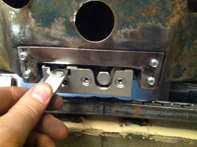

    Small update... doing small stuff. Got the lower part of the trunk latch installed... several times, trial and error, all that sort of thing. Over-engineered it a couple of times before I got it in, adjustable and adjusted...
    Yes, I have a lot of welding to finish up in and around the trunk, around the whole car for that matter.
    This might be under-engineered now, but if it's too weak I'll add gussets or something. Just happy to have a trunk that latches. The wire will be replaced with a hard brake line and a cable running... somewhere. It's running out a taillight right now, which may not be too practical once the car is on the road :D

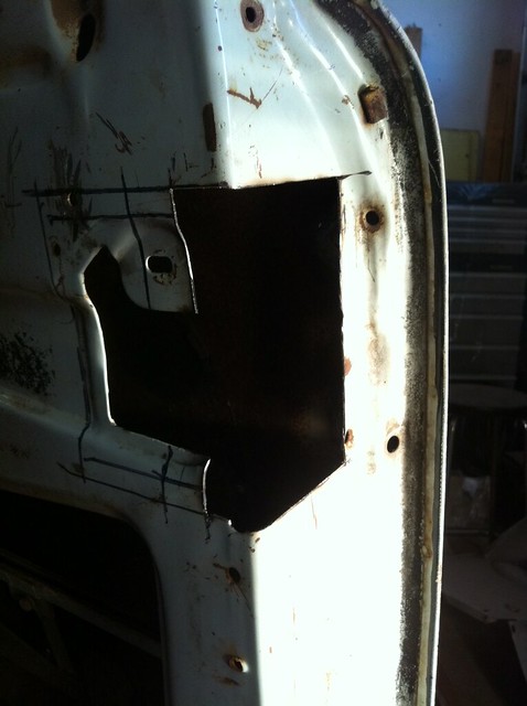

    On to the doors. Lots of threads about bearclaw installs, everyone does it a bit differently. Here's how I did mine.
    Marked out some cuts, not too much, not too little...
    you can see by my Sharpie lines I did a little hemming, a bit of hawing before I got to cutting...
    Got it to about here, things were looking pretty good and I pretty darn proud of myself...
