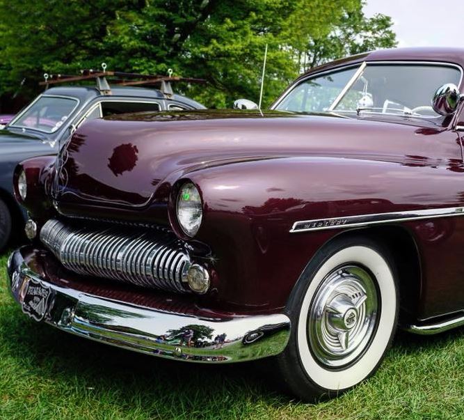

    I say do not flush fit the skirts, that is a modern modification, we hate modern stuff here don't we?? I see that car dark maroon no metallic....

    I like the color of the Ruggiero Merc......
  19. Sancho
    Joined: Apr 24, 2001
    Posts: 5,036
    Sancho
    Something like this color?
  20. Moriarity
    Joined: Apr 11, 2001
    Posts: 37,712
    Moriarity
    SUPER MODERATOR
    maybe a little less purple than that. more like this

    Local merc for color ideas in that range CB46353D-1205-45F3-B198-22EF2F878968.jpeg I saw you a bunch but never got to say hi. I don’t think I got more than a few words in with anyone at any one time this weekend. Was a lot to take in!
