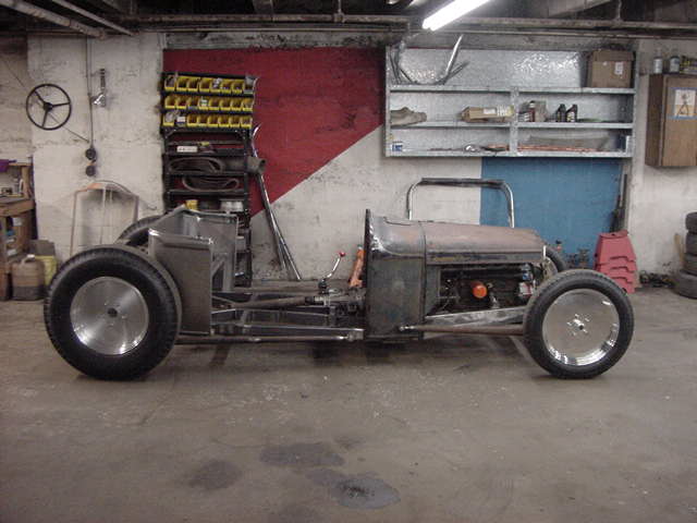

    I ask because I’m having some titling issues. What you are looking at is a 1930 Willys-Overland cowl (and doors eventually) grafted to a 1930 extended back section from a Model A RPU. The frame is scratch built as are the wheels. The hood is from a Chevy and will be modified to line up the belt lines. The grill will be a 1930 Willys which looks like a Model A. Most or the suspension is early Ford.
    I can not for the life of me find a clean 1930 Willys title but I do have a 1930 Model A Roadster title.
    Do I call it a Ford and title it as a Model A Roadster?

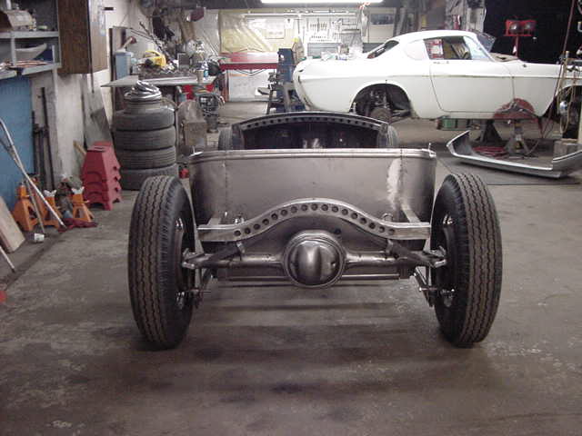

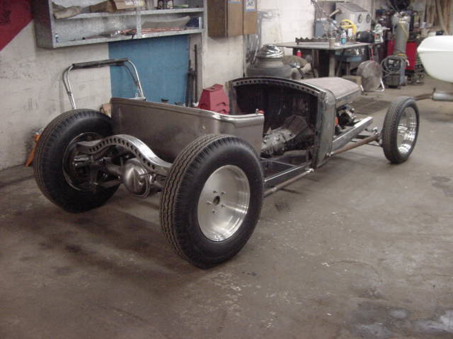

    Thanks for the compliments. I came up with the wheel ibea a little while ago and from the company I purchased them from I could get some tall and skinny sizes. The fronts are 18" x 4.25" and the rears are 18" x 5.5"
    The rear tires are "atc something or others Transport bias plys from Coker" 33" tall!
    I drew up the rear cross member in CAD and had it laser cut from 1/4" material. The is rolled in three pieces and then welded inside and out.

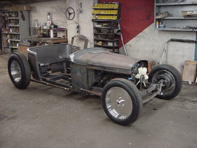

    Here is a pic before I moved the front axle back. It looked too long.

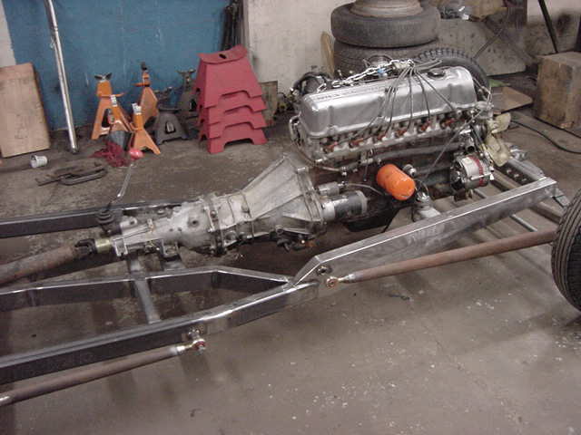

    Oh yah, forgot to mention that the engine is a 240Z engine. Light, Fast, and Cheap!

    Those engines came stock with dual side draft webers right? looks pretty good and those have a decent aftermarket for them as well. Bitchin car, I hope everything works out for you.
