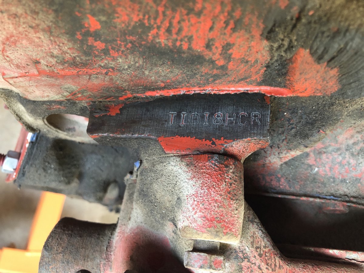

    So I picked up another 327 for cheap. Cheap enough that if it’s toast, I am still okay.
    This is what I’ve not seen before:
    The casting/stamp is a ‘64-67 327 250hp or 300hp
    Date code is J145
    I’ve read (online) that GM did some casting number modifications for factory replacement engines. Is this correct or do I have another vintage boat anchor?
    From the suffix on the pad, HCR , it’s a ‘66 327 275hp 4bbl Rochester carb
    Intake number is 3844457
    Power pack heads.

    There's no VIN derivative stamped on the pad, so maybe it is a replacement blocks. They did some crazy things at the engine plants, but I don't think anything that crazy. Corvette guys would know.

    Broach marks look wrong. They had a swirl to them, these are straight. I'd say re-stamp. But what do I know?

    The broach marks look right, the decks get swirl marks when resurfaced, or cleaned with any tool that leaves circular marks.

    I'm a little confused about the 3 letter pad ID, 'HCR' vs just CR. 3 digit codes began around 1970 as far as I recall and by what I find in Hollander manuals.
    That said, it may indeed be a warranty or dealer replacement unit. Big blocks were usually 'CE' which designated such a thing. I don't know how the H got in there. Perhaps the code is actually HC with the R used to indicate an OEM service or replacement engine. Did you find a list with early 3 character letter codes? It's been a while since I looked stuff like this up, maybe I'm full of **** on the 2 vs 3 letter thing. Been known to happen...

    On a couple of new short blocks I bought in the 60s the pad on the p*** side in front if the head was blank. I guess if a dealer installed It they stamped it.

    I have an HCR. It came out of a 66 Impala wagon w/PG. Check the NaztyZ28 site.
