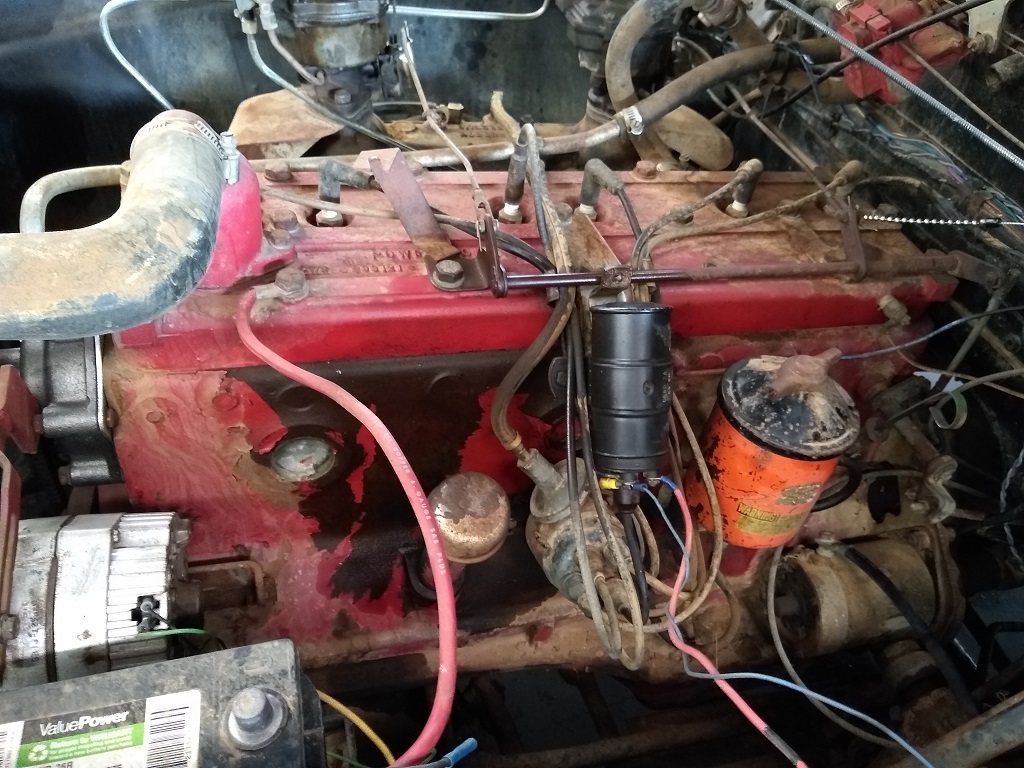

    I need to do a compression test on all cylinders...when I first started working on it I checked the first two just a little and got 90 or so after a crank or two, so I figured it would probably run if I gave it spark and gas....and it did....

  5. Have to admit. I forgot about the wet clutch deal. R&R -ing engine might be a bigger deal than I mentioned earlier..What about that, Hudson guys?
  6. squirrel
    Joined: Sep 23, 2004
    Posts: 60,033
    squirrel
    shop manual has you pull the engine/trans together as a unit....and if you just want to work on the clutch, you pull the seat, a big chunk of the floor, pull the trans and bellhousing out from the inside, and have at it.

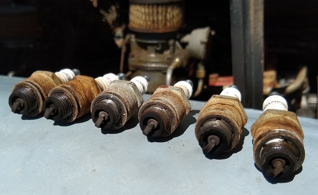

    I went for a 5 mile drive this morning, and then pulled the plugs and checked compression. 120 on all cylinders, plus or minus a few PSI.

    Decent compression for 4,600 Ft al***ude. Should handle the trip.
    EDIT: It is not broken, no reason to "fix" it.

    Those plugs sure don't look like they came out of an engine that is using a quart every 100 miles.

    yeah, I know. It is leaking some, but it's also smoking some. I might see about looking at the leaks and see how it does.
    Old wolf likes this.
  27. From the look of those plugs it dont appear to be drinking oil. If it was mine I would retrofit a PCV. A PCV would redirect those oily blow by g***es into the engine and thus help seal the rings a bit. and a PCV many times will help with external oil leaks. also try running it a half quart low?
