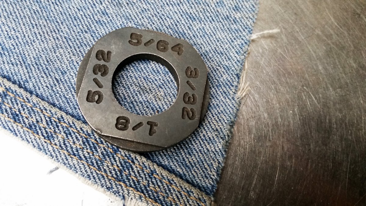

    If one is just going to re ring, one of this come in handy.
    It's a go no go ring land gauge, most used pistons I have pulled out the ring land are worn out and need to cut for a spacer.
