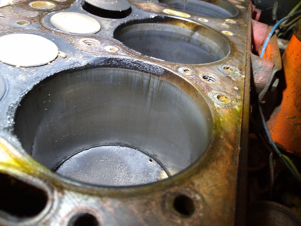

    anyways....I had a few minutes, so I pulled the head off the Hudson. Interesting!
    it's been rebuilt, the slugs are 20 over, and the bores are nice...except number 3, which is badly scored. Hmmm....

  16. spanners
    Joined: Feb 24, 2009
    Posts: 2,197
    spanners
    Broken rings perchance or a lump of carbon?
  17. squirrel
    Joined: Sep 23, 2004
    Posts: 60,033
    squirrel
    It appears that the pin that holds the rings in place, worked loose, and caused some mayhem.
    Notice that the piston was knurled, also.
    I measured the bore with the dial bore gauge, it's over 10 thou bigger than the piston where the rings travel, measuring front to back, but not so bad from side to side. Also the rings appear to be quite worn, even on the top and bottom, so it probably has a lot of miles on it, in addition to the locating pin coming out. Other pistons had quite a bit of oil on top of them, too.
    I'll pull some more pistons tomorrow.
    It only took about half an hour to get the pan out, didn't need to jack up the engine or anything, either. Someone had replaced the mounts, I guess that helps.

  19. Hone it and replace the rings. myself I don't like the pinned rings. Pinned rings are not necessary and just another thing that can possibly fail. I would do away with that feature. I would buy .030 rings and cut them to fit. and if the piston has excessive movement in the bore. place a shim behind the rings. After all its not a high RPM race engine. The goal is to curtail excessive oil consumption without spending high dollars.

    There is no ridge, and after some more measuring, the #3 piston and bore are .030 over, while the rest are .020" over. The piston pin in #3 is pretty loose, and the piston is damaged, and just looks like it wants a new one--I called one of the Hudson parts suppliers, he thinks he has one, but not sure if he has the 20 over original type rings for the other 5 pistons.
    I pulled #4 also, and it does not have the pins to align the rings--the bosses are there for them, but no holes drilled, even though the rings have the notches for them. Interesting.
    There is one big scratch on #3 bore that I found after doing some honing, about 1/8" wide, as long as the ring travel, and one to two thousandths deep. I expect it will let some oil in, but hopefully not too much.

  25. That scratch over time will build up with carbon. and the rings wear to fit the damaged bore. Since one cyl is already .030 just get a set of 30 over rings and cut them to fit. I would grind all the casting flash and polish & CC the combustion chambers in the flat head. That will lower the compression ratio a bit and make it run very smooth. I am looking foreward to when you get it back together. So we can tell the naysayers told you so!

    Can you knurl the #3 piston to make it a little tighter fit into the cylinder? It only needs 0.010 to tighten it up. Might help the rings be a bit more stable in the ring lands with less rocking??? I agree that longitudinal scratch is a "live with it for now" until a lot more serious engine rebuild is done. In the old days, a taper of 0.006-0.008 seemed to still have pretty good rering results; so i think a set of new rings, and cleaned up pistons and ring grooves will have you using a lot less oil. I think the suggestion to use std non-pinned rings is a good one.
