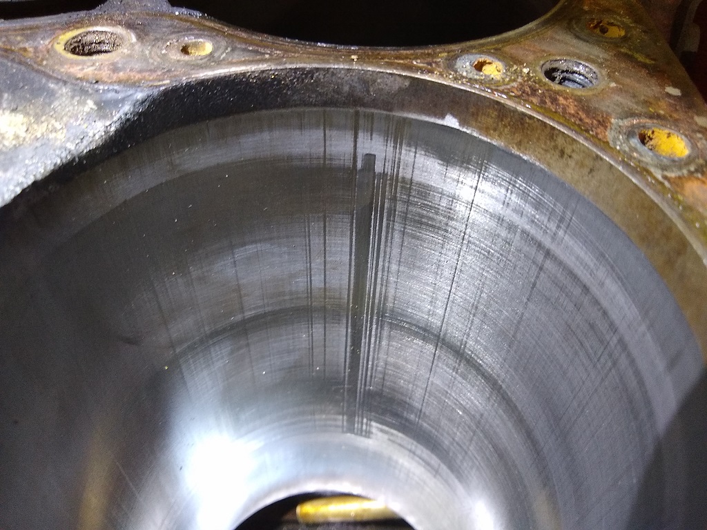

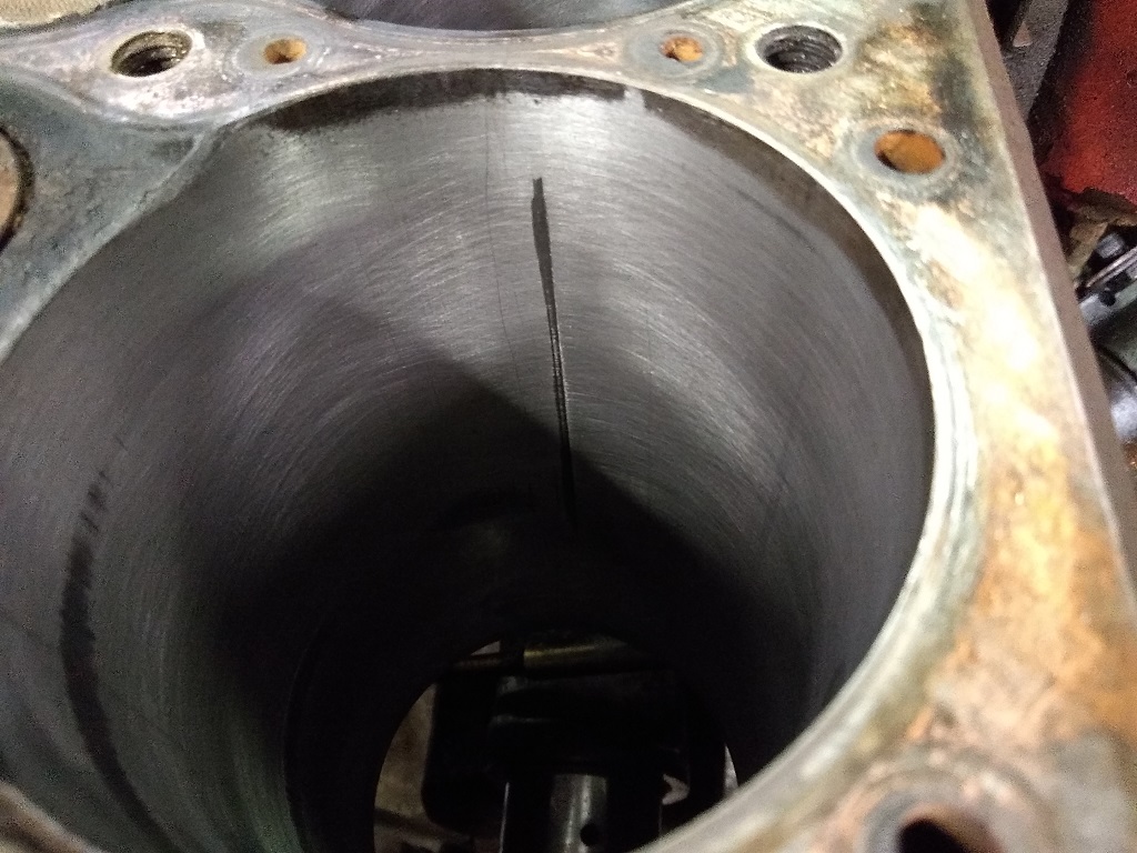

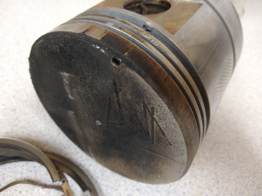

    I finally got a piston and rings (one piston's worth) to replace the .030 over piston that was having trouble. But the new piston and rings are .040 over. Hmmm....
    so, I got a rigid cylinder hone, and opened up the bore a bit more. It was in pretty bad shape, mostly .040 over already except for the bottom two inches, which were at .030 over. Now it's mostly .040, but the middle is about five thousandths over that, and the top is about 3 though over. Oh well....
    and that scratch is still there, although not as deep.
    I also bought a set of NOS rings for a different engine, a V8 that has the same bore and ring width, but only 3 rings per piston. And they're .030 over, not .020 over, so I have to file a bunch off each ring to get them to fit. When they show up....which could be a while, since they're coming from Canada.
    I love a challenge.

    TOOOOO much of a gouge! Have you looked at E-Bay? There are a couple of complete pistons sets, and another auction with two used pistons. One auction is fairly $$$$$, the other is only $$, but is for SEMI FINISHED pistons (you have to have them cam ground to YOUR oversize, and then use the proper sized rings); there are not a lot of options in this country any longer that can do "piston grinding", as it was called. Went that route with some 265 Chevrolet pistons I bought, and it would have cost me $800.00 to have them ground to size, on top of the original cost; yeah, they went back to the seller. I did't see the oversize on the two used pistons. I did see several sets of re-conned connecting rods; boy those are a SKINNY rod; sort of helps to explain their low C.R.!!! Even more so than a flathead Ford V-8. Did you wear out an electric drill doing the "boring"? I think it was Lone Wolf who said he did that once. I am Butch/56sedandelivery

    I did some of these ring jobs back in the 'dark ages', vertical 'gouges' like this worried me, but the $$ to rebore/replace piston (s) were far and away from the customer's bank.
    I was always surprised at the outcome, seemed that the Lord was rewarding me for time spent!
    Amazing how my 'schooling' affected my prognosis. Thinking, "This thing will smoke, use oil, and develop a serious compression loss in 1,000 miles."
    Incorrect, of course.
    Simply amazing how a cast iron ring will 'seal' a gap in a cast iron cylinder.
    Ratio of proportion. (there aren't 12+ gaps all around the cylinder...Usually only 1 or 2. Not 'deep', or 'wide'...Again, ratio of proportion.
    Then, there's wear taper. .008" is the limit on SBC, I've ringed (rung?) when they were that 'bad'...No smoke, easy starts, plenty of power.
    Inline engines seem to be more 'forgiving'.
    My first employment introed me to the International trucks. Big sixes blew head gaskets on a regular basis. Hone 'em, ring 'em, fly 'em. Hated that end of it.

  22. I think you will be surprised at how well that engine will run. I say go for it!

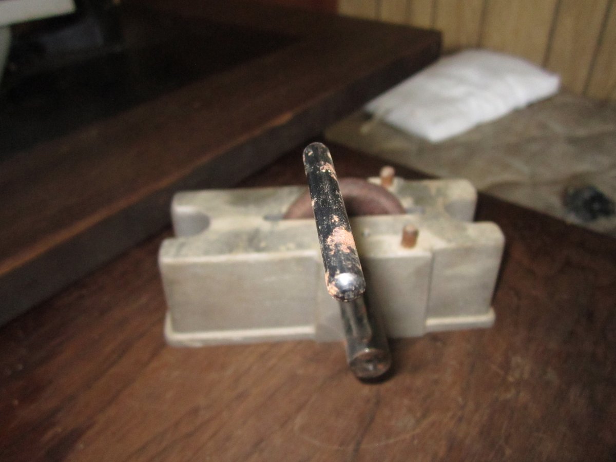

  25. It will work fine. Twenty years ago I cut down .020 piston rings and installed them in a badly worn std bore David Brown 3 cy diesel and it has 24 to 1 compression ratio. and its still going today. If you don't have one Get one of the ring grinders like I have. They certainly speed up the job of cutting the ring gaps. The diamond wheel grinds both ends at the same time. I think I bought mine From Jeg's? its been over two decades I don't remember for certain.. I used to file them by hand the tool is a hundred times faster and does a better job.

    OOPS! I said Lone Wolf when I should have said Old wolf; I knew who I was thinking of just the same. We'll all see when it's together again and running about that gouge. I have a similar, but smaller gouge in a 283 block I had tanked, oil plugs, and freeze plugs installed in; then I cut the very slight ridge from the top of the cylinders. A fleck of steel got caught under one of the reamers rollers, and left a horizontal gouge about 3" long, and I'm still sick over it; it's barely noticeable unless you know where to look. It's the only reason I have't ***embled that engine. I have some fairly serious money in the rotating ***embly. Maybe I'll just throw caution to the wind, and see what happens? I tend to be a little bit **** retentive with things like that. But, I still think the vertical gouge in the Hudson block is too much; at least from my perspective. The 333 SBC that was originally in my FED, then did time in my truck before it burned a valve, and when I tore it down for the rebuild it had a broken ring that left a vertical gouge in a cylinder; out of an abundance of caution, I had that cylinder sleeved and re-bored. Maybe I should have just left it. **** retentive.
