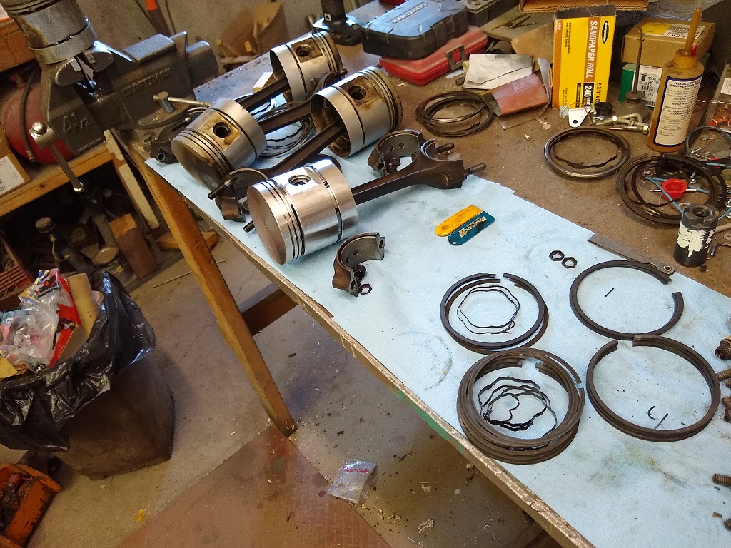

    I got some rings in the mail today, so I'm out there a grindin' away...
    The rings are NORS, and they fit a .030 over Caddy 331 engine. One of the oil rings was broken (they are cast, with spring steel rails), so I will use one more old ring than I hoped. Also, the rails are too tight to use without grinding, so I am thinking about just using the old rails, instead. The Hudson has 4 rings per piston, the top oil ring (above the pin) uses the rails, the lower ring (below the pin) does not.
    I also took a closer look at the old pistons, they have a ring spacer on the top groove, which is kind of neat...I don't think I've ever seen that before. They're also knurled, which I have seen before. The new rings have decent fit as far as ring groove wear not being too much.
    I also stuck an old ring in a bore to see how much gap they had...they had quite a bit! like 3/16" on the one I checked. yikes, no wonder it burned so much oil.
    To make the new .030 rings fit the .020 bores, I marked a line 1/32" from the end of each ring with a scribe, and ground to the line with the edge of the grinding wheel on my small bench grinder...then finished with the hand ring grinder, to get it square...and then checked the gap. I'm not to picky on gap, anywhere from .015 to .025 on the top rings is fine, and even tighter on the second, and oil rings, is ok.

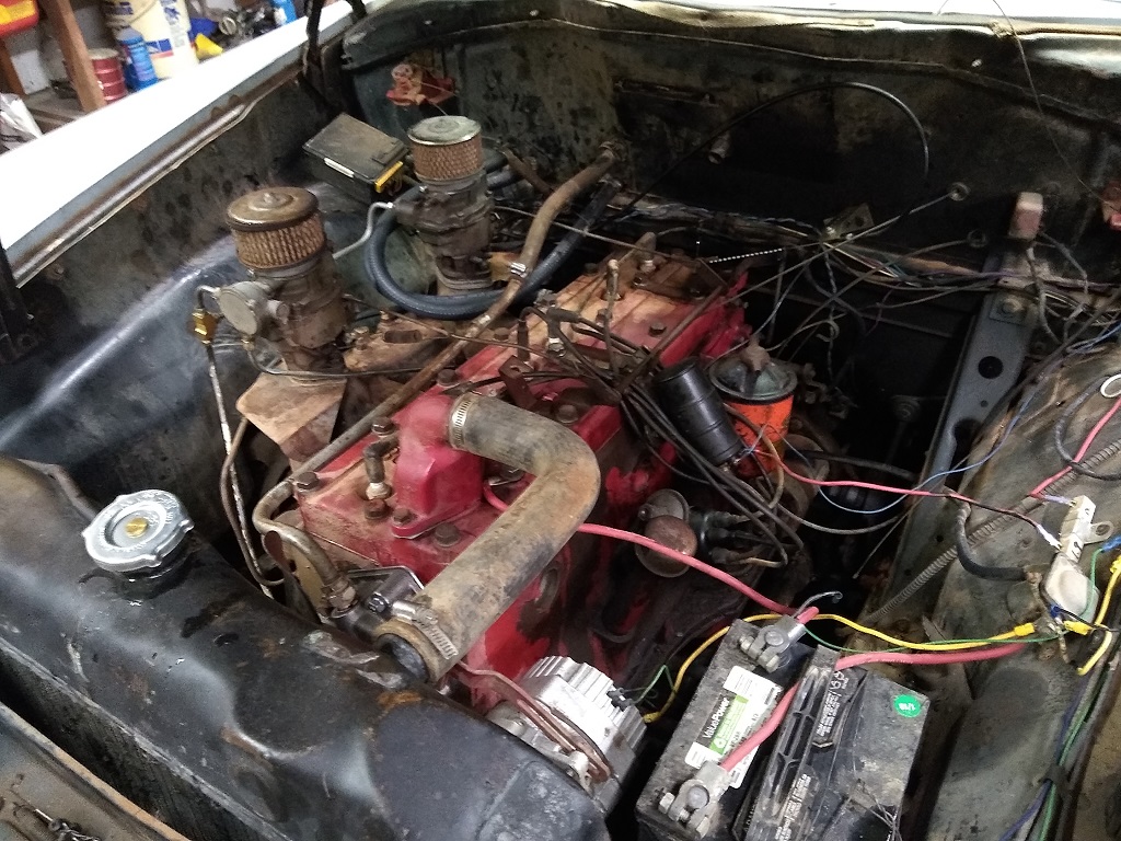

    going back together. I think the new rings are from 1958, anyways, a couple pictures for your viewing pleasure.

  7. I like the dual carbs. and I see the relief on the deck to allow better flow from the valves. Its just me however I would weigh the bigger piston & rod and remove some weight from the big end and above the wrist pin on the rod to balance everything.

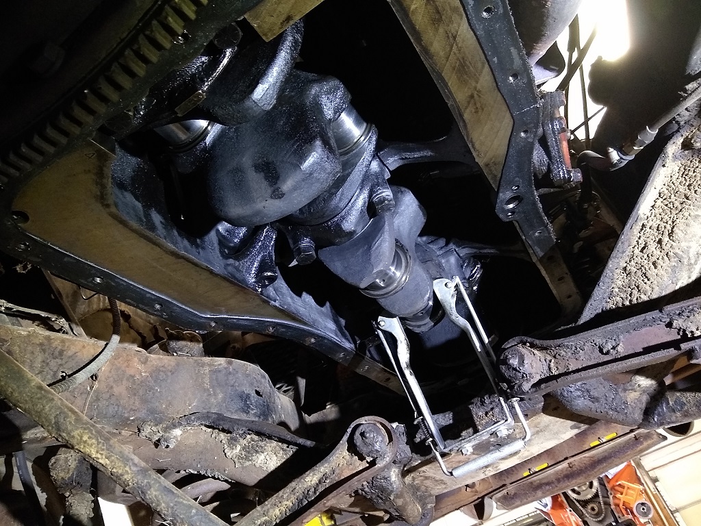

  9. Cool Tool! Any chance you remember who made it?

    The rod tool is a Blue Point, it's old, and they haven't made them for decades. It's my best "whatizit?" tool

  11. Jim,
    I have never seen a tool like that. Is it to protect the journal when you are installing the pistons?

    yes, also lets you pull the rod onto the crank journal....or push the piston out of the bore, if you're removing it. Very handy. I love it
  13. I just found a picture of one on line, and I can see why you would like it.

    The only problem is it won't fit 7/16" rod bolts. Which I have on two of my engines!

  25. Just from looking at the design, the only way I could see to convert it to use with the 7/16 bolts, would be to butcher this one or build a copy to accept the larger rod bolts.
    I guess I'll have to continue using fuel line hose, but this device would seem to solve the most difficult part of removing the rod, and that is, to get the rod off the journal without damaging the finish on the journal. Even with the rubber hose covering the bolts, that is when I am most paranoid.
