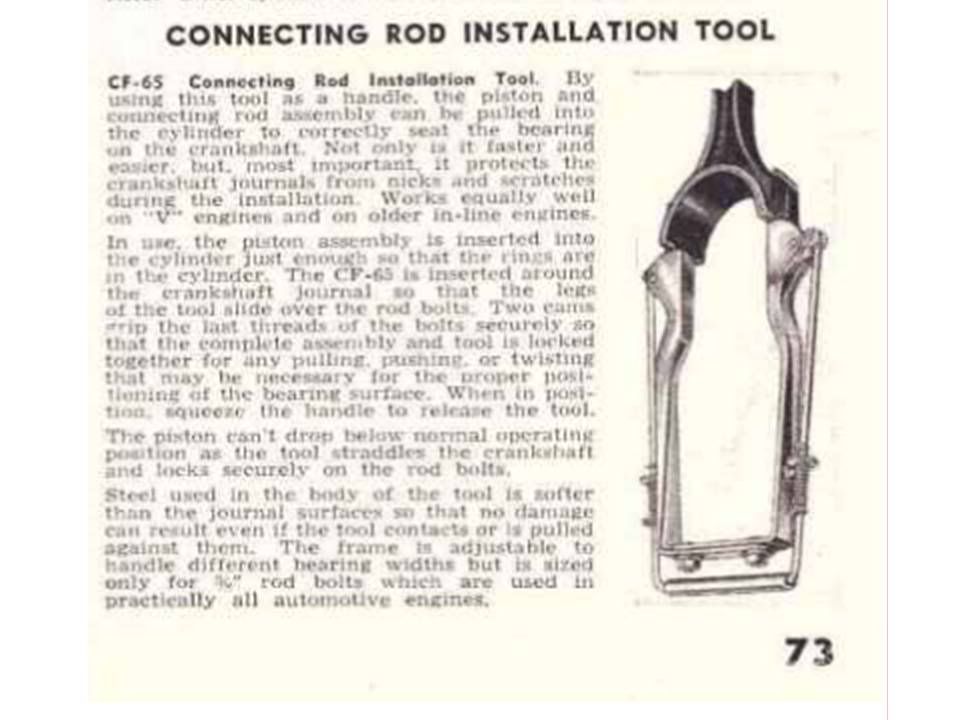

  3. Hey Jim, great write up, as usual. Thanks for the info on the conn rod tool. Have you found applications where the rod bolt grippers are too wide to fit down the bore, or is the illustration exaggerated a bit?

    The tool never goes near the bore, so it doesn't matter...you use this tool from the bottom side of the engine.
