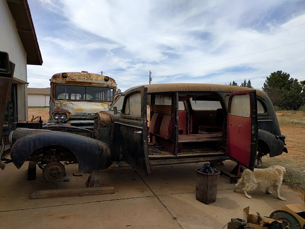

    the car, as David is cleaning it up....lots of pack rat infestation, which makes it all the more fun. The doggie is having fun.

    The engine is from a 1942 Cadillac, apparently someone put a rebuilt engine in it some time ago. probably in the 1970s. The original LaSalle engine was a 322 and had a 3-3/8" bore, this engine is a 346 and has a 3-1/2" (plus .030 over) bore. The top ring is 3/32, second ring is 1/8, the oil rings are (yes two of them) 5/32. Fun stuff. I spent a while looking through the Hastings ring catalog to find some engines that used the same rings, the top ring from a 239 Y block is the only thing I found that was slightly available.
