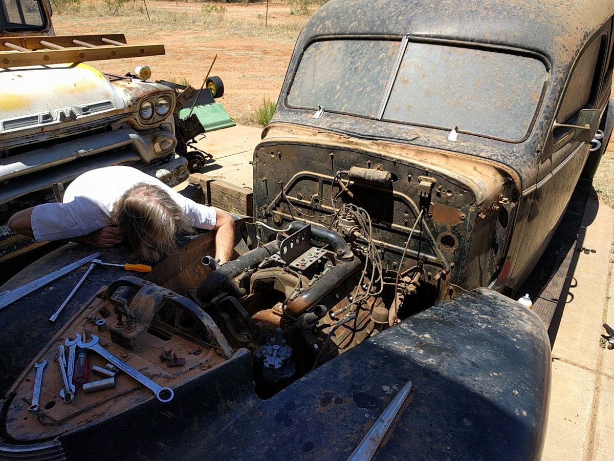

    dropped it back in today, we might be able to see if it will fire. Still have to get the transmission etc back in, and rebuild the carb, and a few other things...battery cables, etc. Might try to get the radiator in and plumbed and see if it leaks water. Lots to do, but we'll get it.

    Does the LaSalle have the shutters in front of the radiator, operated by the thermostat in the radiator, or did they do it differently than Cadillac?
    Bowtie Coupe likes this.
  10. squirrel
    Joined: Sep 23, 2004
    Posts: 59,979
    squirrel
    there was some kind of funky thermostat thing in the top radiator tank, but it's been byp***ed. No thermostat. We'll have to do some cardboard in front of the radiator if needed...

    It's probably just an optical illusion, but it looks like there's room for a second engine under there. :rolleyes:

    Anyways, last night I put the carb back together (after my brother took it apart and cleaned the parts, then left for a date). I also put the radiator hoses on, and filled it with water, and fixed a couple minor leaks. Today I got to go visit mom, which took most of the day. When I got back, I put the driveshaft back in, and wired up the battery and a coil, and a couple temporary fuel lines.

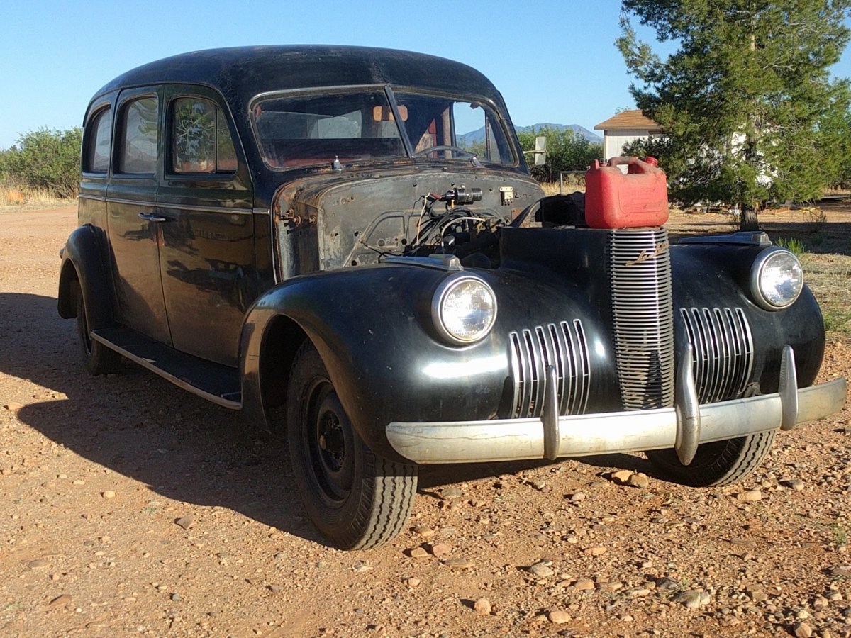

    I figured it was time to go for a drive, so I stuck the brakes back together this afternoon, mounted one more of the new Tornel tires, hooked up the throttle and shifter linkage, and relocated the gas tank. There is no master cylinder, but the parking brake kind of works. So I fired it up, backed out, and drove halfway around the shop. Drives nice.

    The engine has been running good, now we need to get the rest of the car working well. We installed the fuel system, electrical system, cooling system, brake system, etc. First test drive, it acted like it vapor locked, so we added an aux electric fuel pump, to see if that would help. About to go on another drive, see if it will make it into town. It steers, stops, accelerates pretty well, all the lights work, etc. No temperature gauge yet, and the fan belt is flaky, so it's an adventure....

    well, it was an adventure...kind of short distance, but took a while, Made it about 2-3 miles, got a bit too hot, had trouble keeping fuel flowing. took over an hour to get home, with several stops along the way to let things cool, put more water in the radiator, fill the carb with fuel, etc. The water pump is leaking pretty badly, so we'll see about putting the new seals in it. And check the radiator for proper flow. The pump does seem to be pumping, there's water movement in the radiator top tank. Also the belt for the fan is not nearly the right size, so it's not doing much to move air across.
