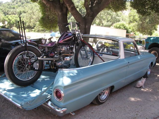

    Heres my Hauler! i have had 4 rancheros and i love em for some reason....

    ^^^ Dude i was askin aboutr the Rancho in SanDiegoJoe Santa Maria thread.
    I was wondering how did you get to tuck those cragars up front so much.
    Narrowed A arms?
    I have a ford w/ a similar front end and i have narrow'em to fit the cragers.
    Watcha say?
    Thanx.
    And btw, the bike is waaaaaay *****in!

    Sweet chero! What color is that?

    They look like vintage 13" 4 spoke/4 lug Cragars, and on a Falcon, they tuck like that.
