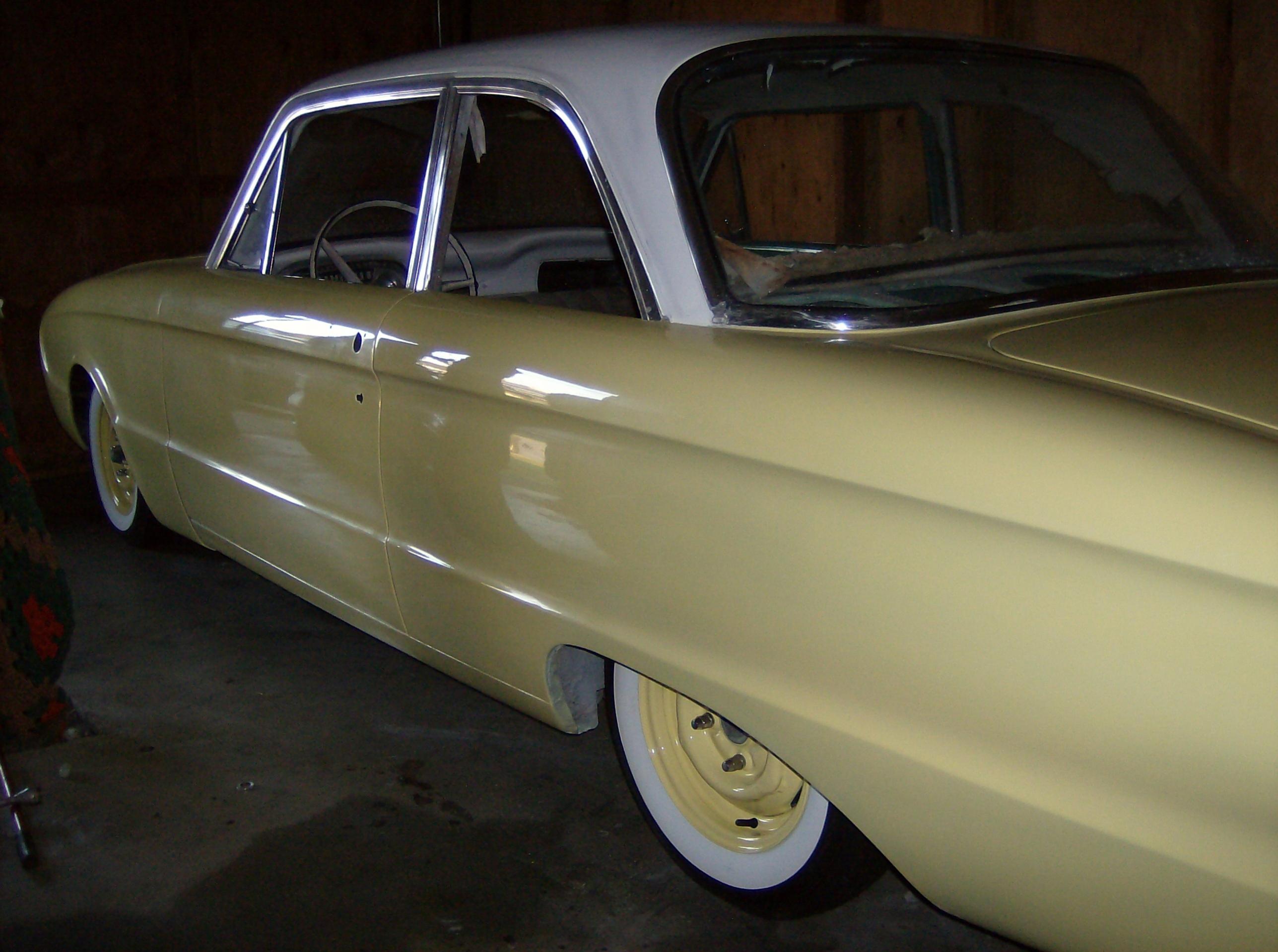

  4. emercadog
    Joined: Sep 10, 2006
    Posts: 14
    emercadog
    This is my daughter's 61, still in progress.

  6. sdg
    Joined: May 23, 2009
    Posts: 16
    sdg
    Great looking car! What size tires are you running? Is it the front or rears that rub?
    Thanks!
    EDIT: Nevermind, answered in a previous post:

  7. sdg
    Posts: 16
    sdg
    jr. Nice, How much drop?
