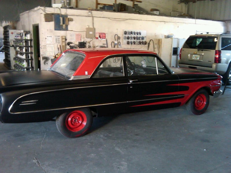

    The first picture was the last thing I did before going on deployment, i put on headlight covers. it was the only thing left out of the parts I had stacked up that I had time to do.

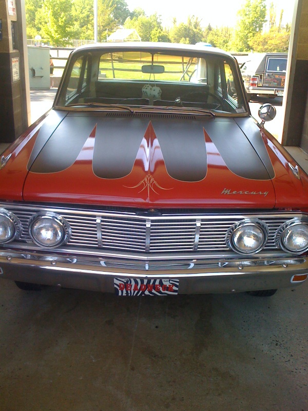

    The second is after my accident, after getting my frame pulled and replacing my quarter panel, bumper, and decklid. I called on inspiration from my first comet in high school.(extremely similar, just done in less becoming spray paint)

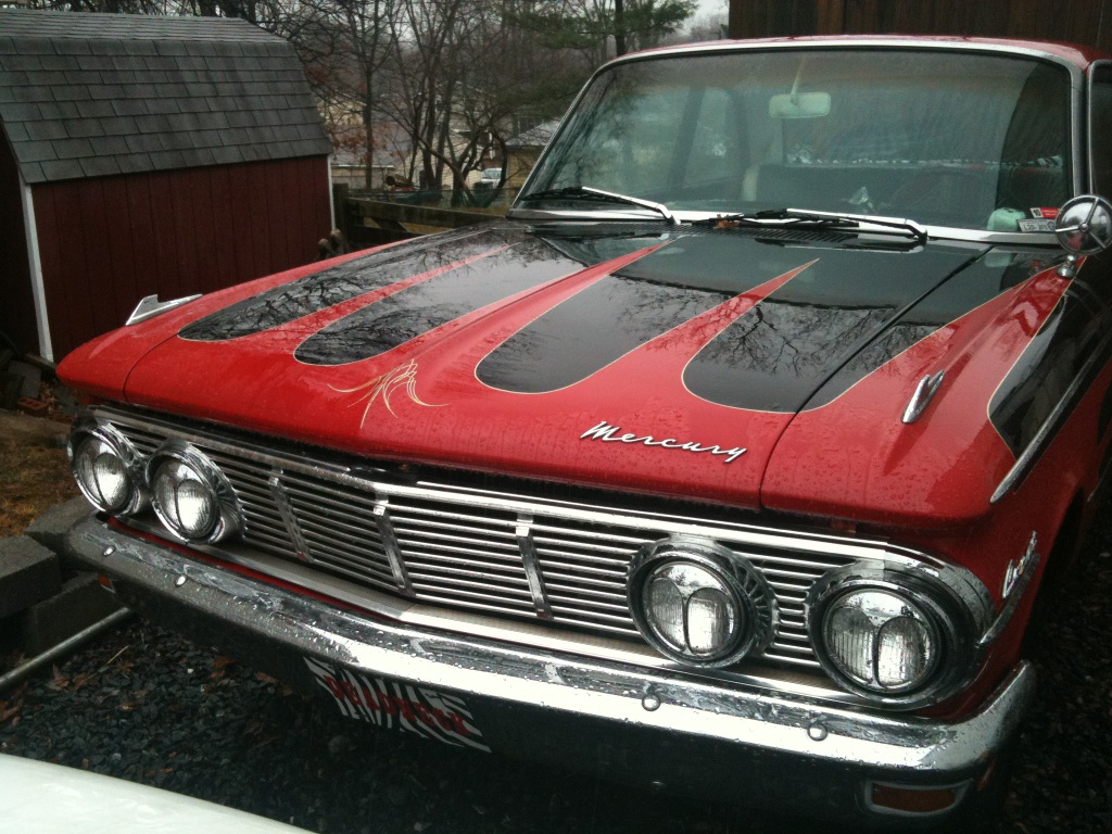

    The third picture is after getting her stripe, courtesy of Kobbie's Kustoms, this picture only shows the outline and hood.
    I apologize for lack of pictures of her I am currently on deployment and my wife is finishing her up with a drivetrain swap, I'm going from a 144 w/2spd auto, to a 300 w/c-4. This is my first endeavor going with the 300, my first i swapped in a 250, but kept the 2spd, so any knowledge or tips from others would be extremely appreciated. let me know what y'all think!
