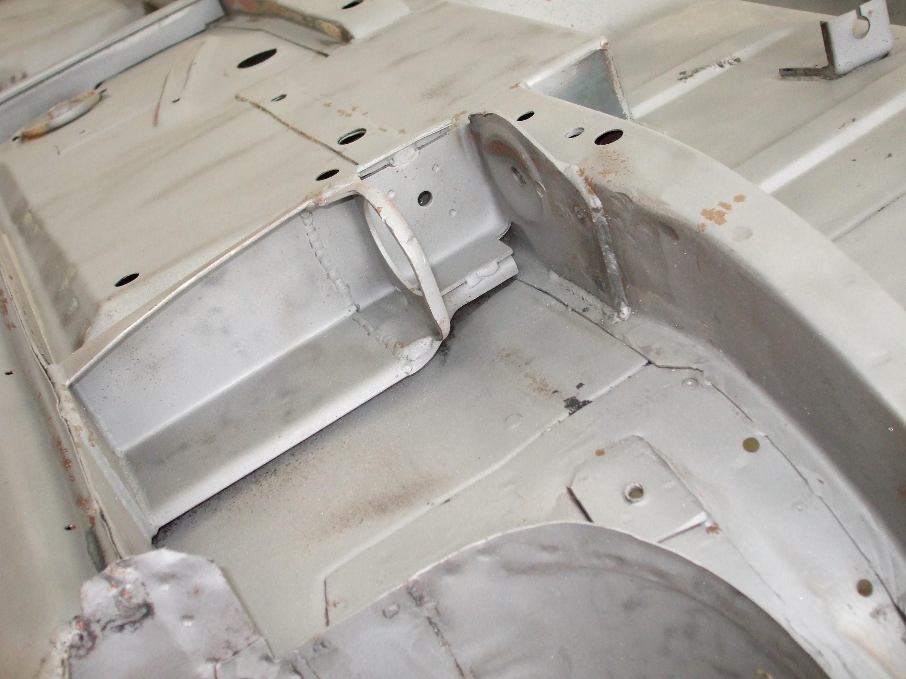

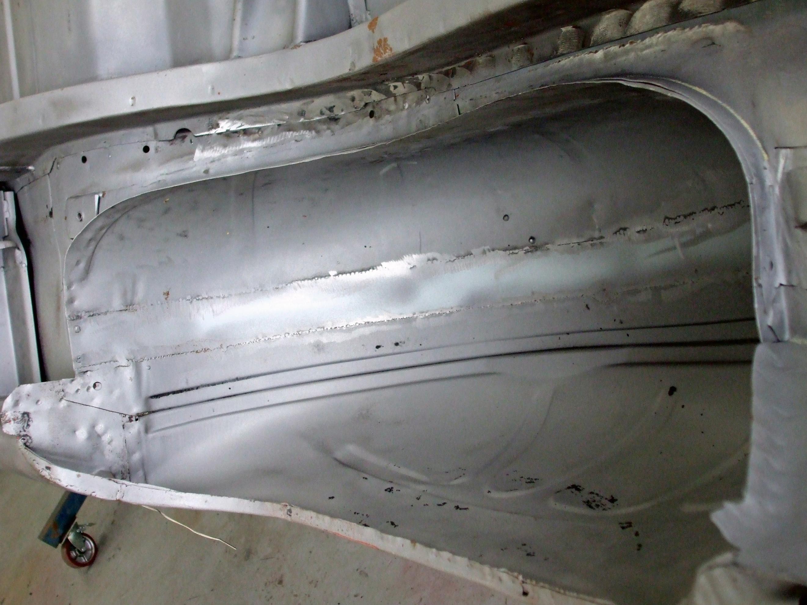

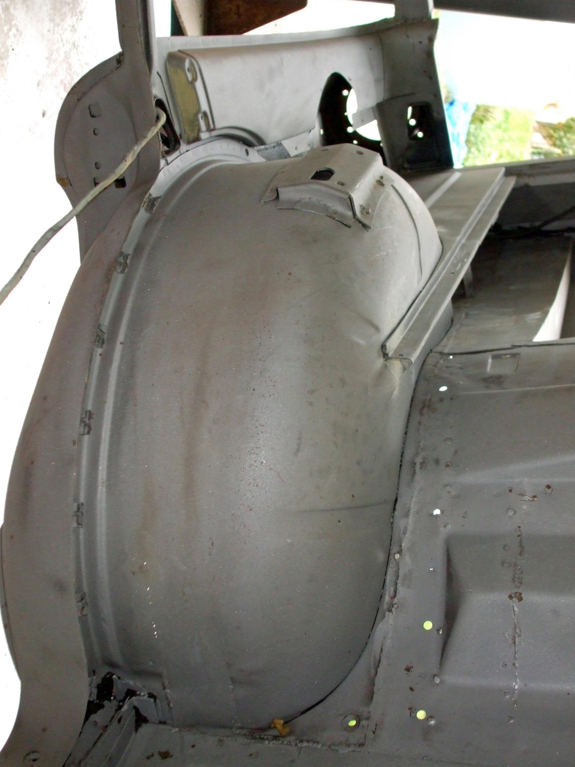

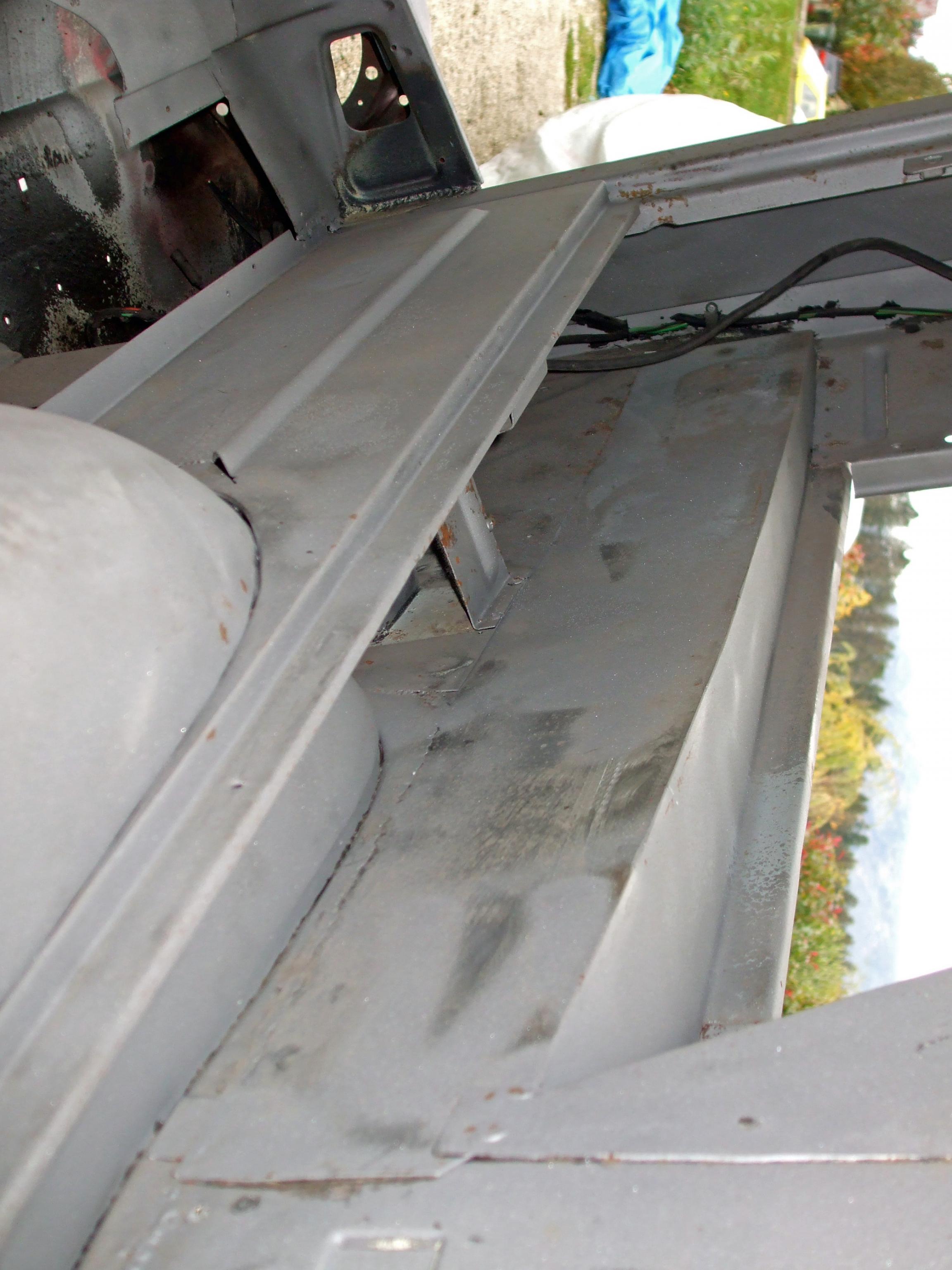

    Im building up (for the 5th time, and last) a 65 XP aussie falcon wagon. Cut out and shifted the ch***is rails in 3 inches per side, chopped out the inner gaurds and widened them the max width I could without modifing the spare wheel tray etc, a **** load of work but im going for the look where people scratch there heads knowing theres somthing different but there not quite sure what. Also cut out the front shock towers and am about to start building a coilover independant front end with HQ holden stubs, willwood brakes and a shortened Holden commodore rack. Out rear ive shortened a '57 9" diff with an eaton tru trac centre. Motorvations coming from a stroked 351W with cleveland heads and topped off with a 671 blower with injection, backed up with an FMX and im adapting a push ****on control on the dash, Just to be different.
    Ive owned this car since i was a teenager, been through 11 engines and made some average repairs in my younger years so this time its being done right as its a rolling advert for my hot rod business.
    At the moment im just finishing off the floor pans and filling a few unwanted holes in the fire wall and inner fenders.

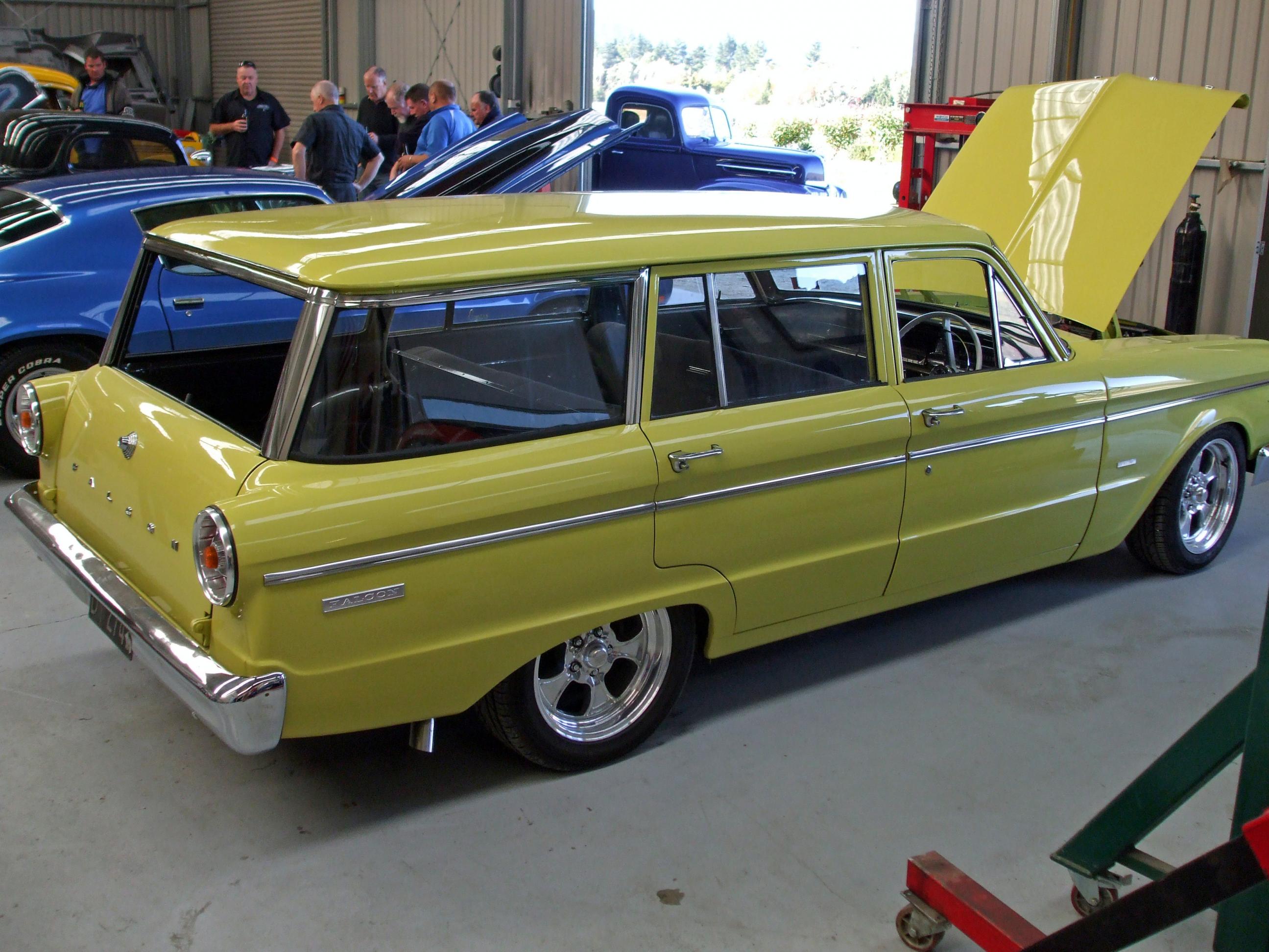

    Ive just finished the Yellow XP for a customer, 9" tru trac, 347 windsor and it goes like a scalded cat. Cool little car.
    Will post more when I make some progress.

    nailhead29a, very nice work!!
    love the yellow fordor wagon!
  24. Yip shes a pretty sweet little car,getting that going gave me a much needed boot in the **** to get mine done.
    The XP is pretty much an aussie body with 63 comet front sheet metal etc, came out in 4 door sedan, 4 door wagon, pickup, 2 door hardtop and 2 door panel van. We missed out on the convertable and 2 door wagon.

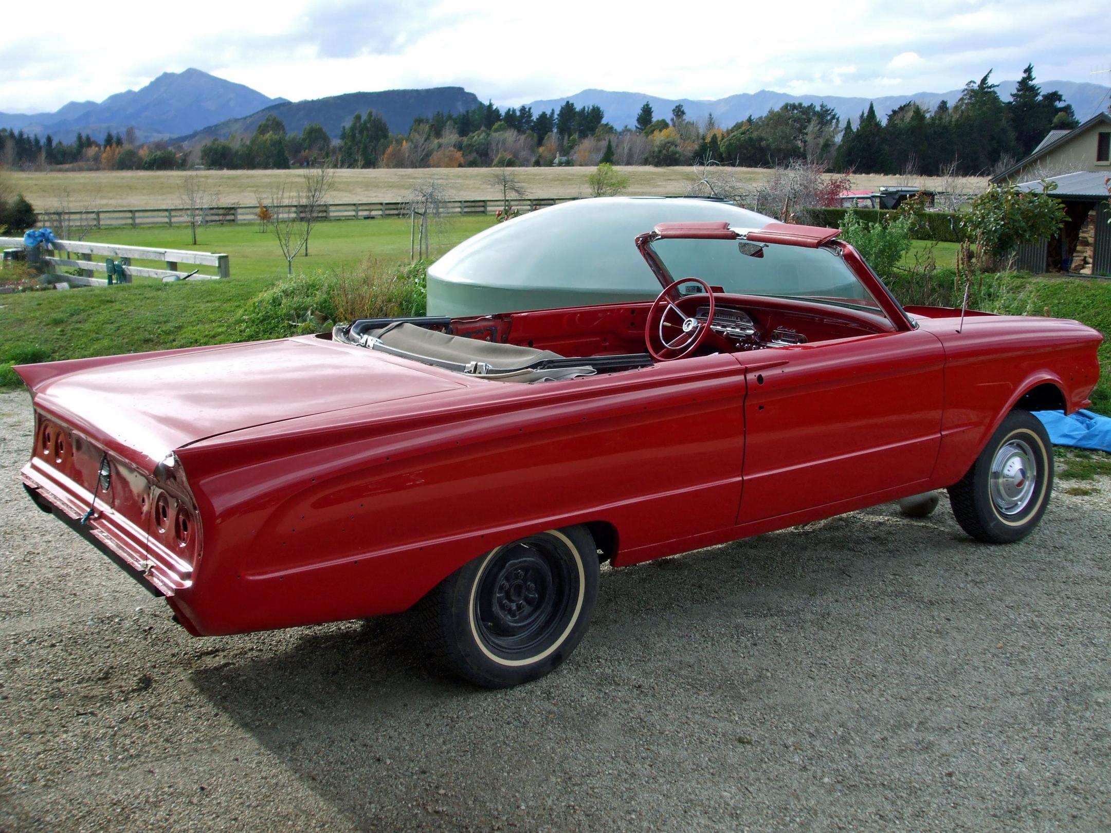

    Im a huge early falcon fan and rekon the XP has to be one of the best looking cars to come outa ozzie, I also own another wagon and sedan (both projects) and a 64 americian convertable which is the next to go under the knife. Just restoring with dad, my moms little '63 S22 comet convertable, it a little 260 4spd manual job and a very sweet little car.

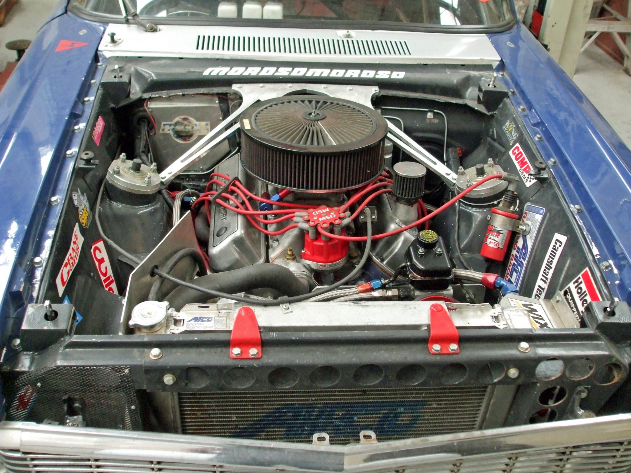

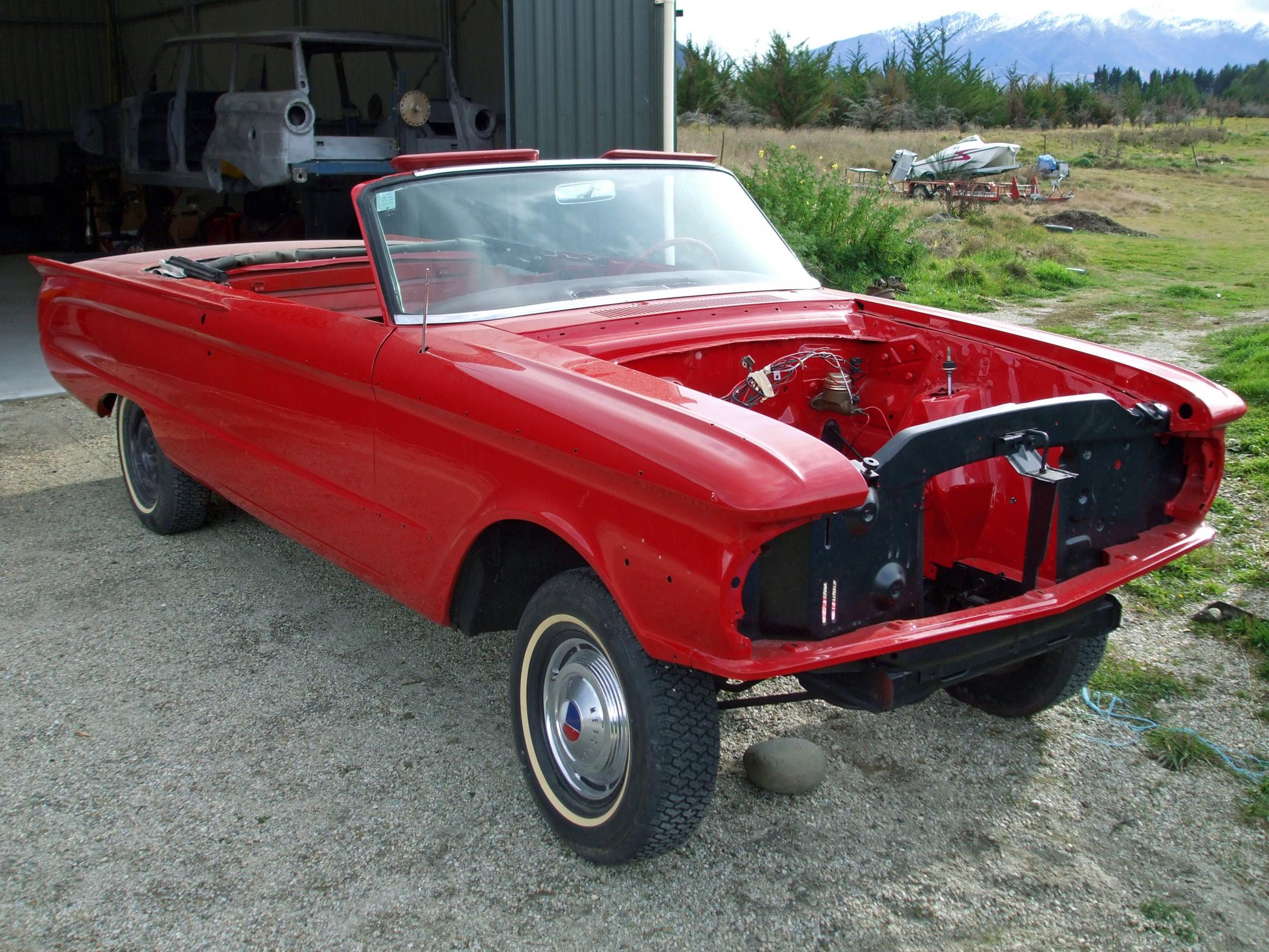

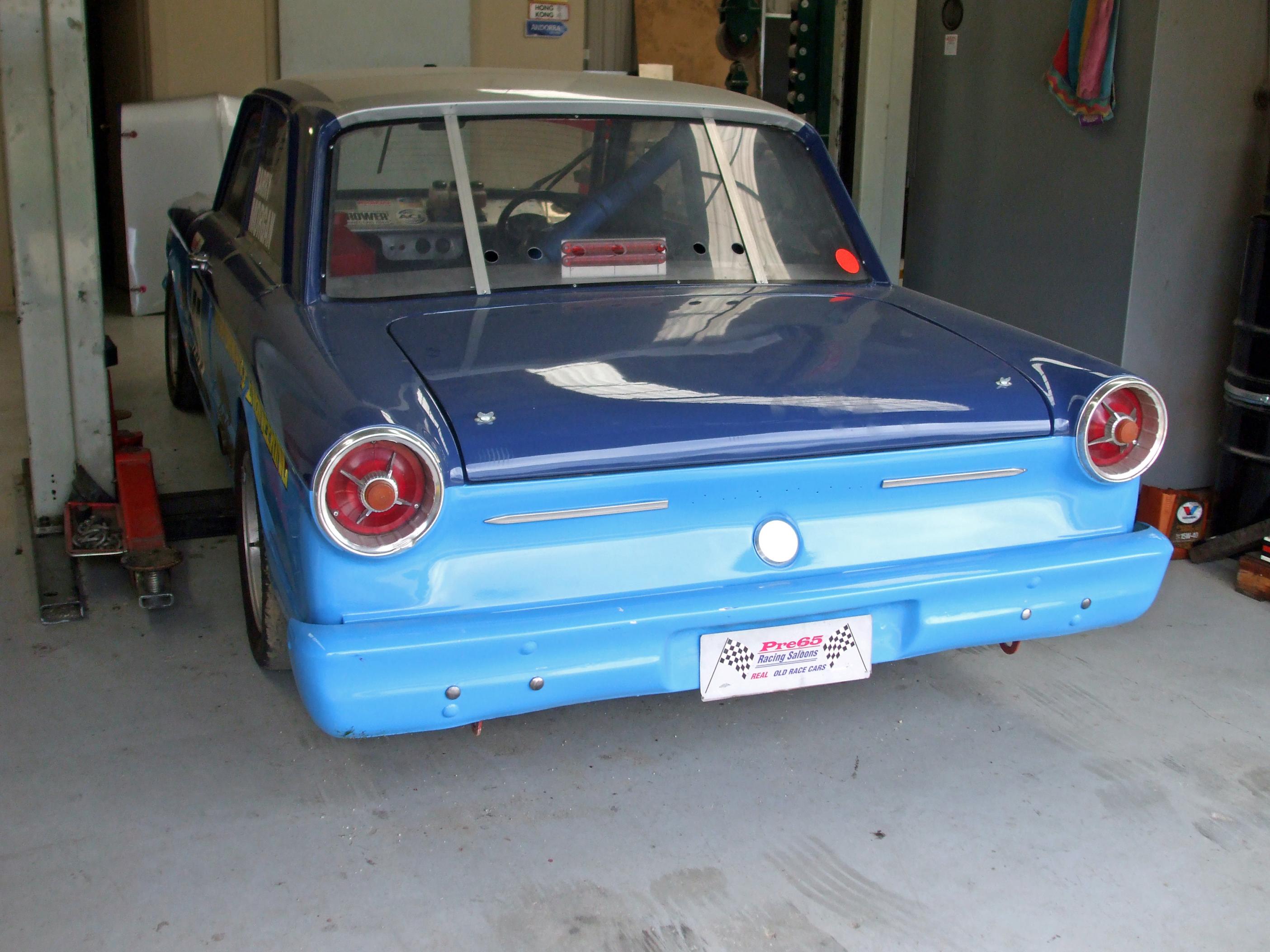

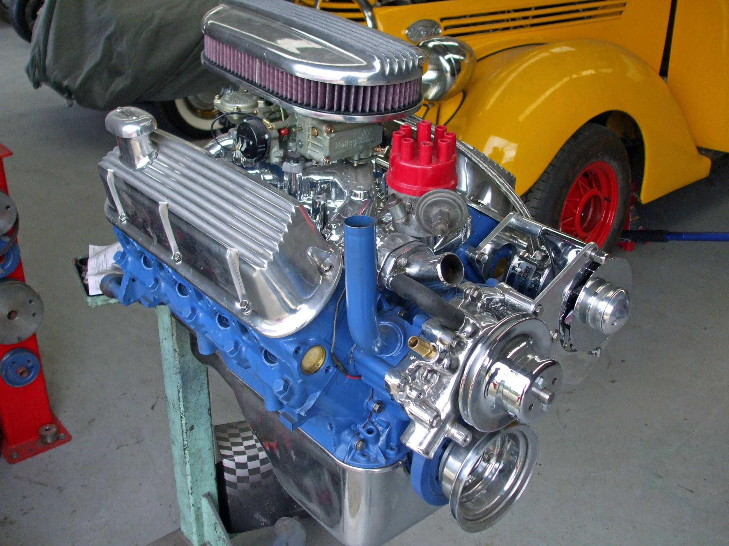

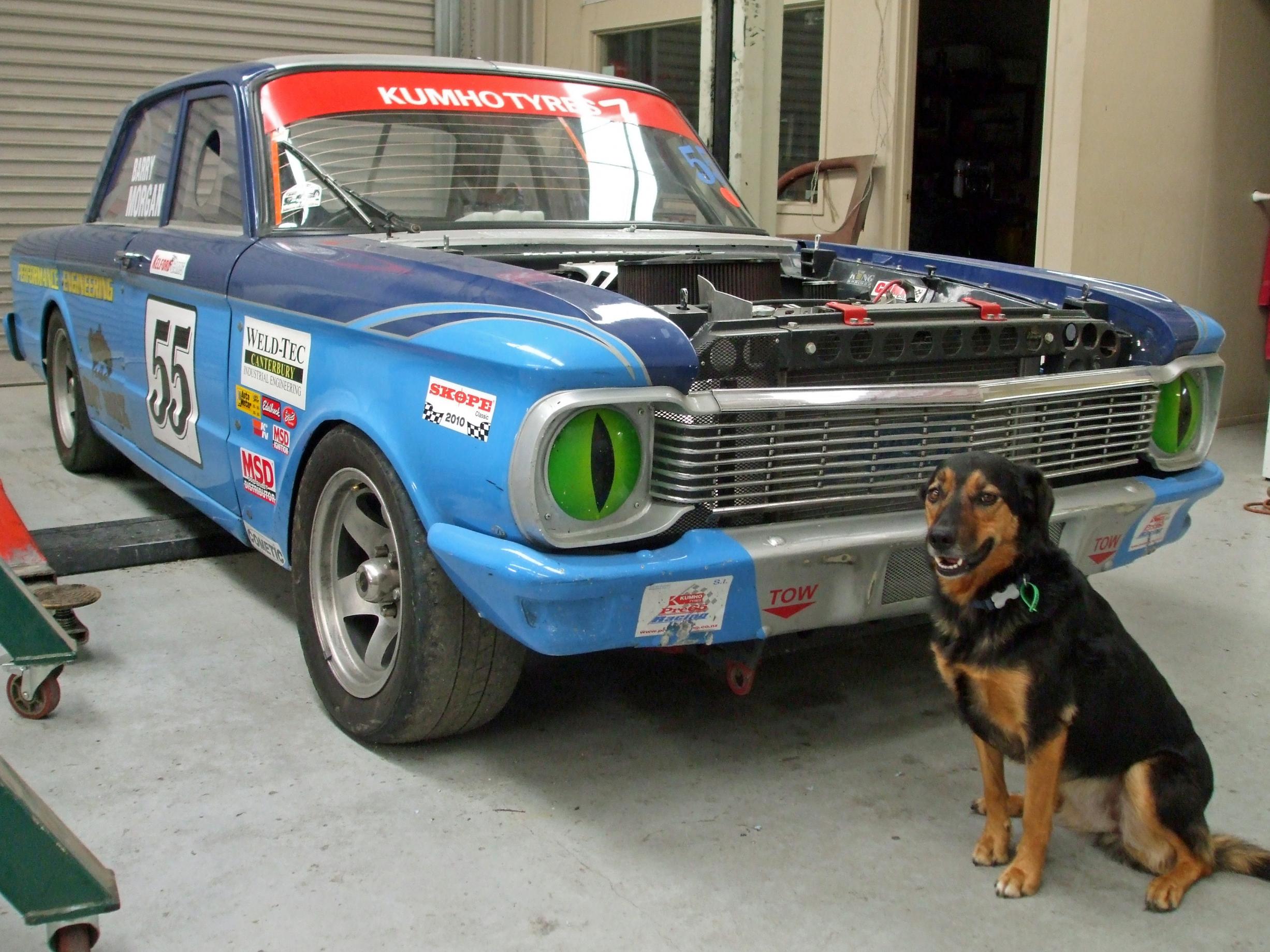

  28. Dad also races a 65 XP in the pre 65 circuit racing, has a very potent little 289 producing 480HP, extensivly ported and flowed early heads with huge valves, dry sumped, forged crank, carrillos, msd and all the other usual go fast stuff, super T10 box and a little 8" running 3.7 gears. He got rear ended last season by another car doing in excess of 100mph, the car was a bit of a mess, the rear end was shunted over about 2 feet, so as you can see its recently had a new rear grafted on. The little comet belongs to mum, which we are just giving a make over for her, its an S22 with a little 260 and 4 speed, cool little car, just done the motor up which is in the pic.

  30. falconizer_62
    Joined: Mar 2, 2007
    Posts: 637
    falconizer_62
    love the road racer!! actually, they're all sweet. even caught the wagon in the garage.
