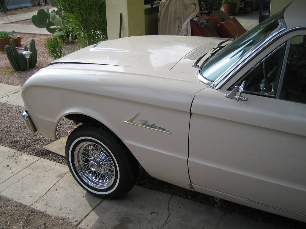

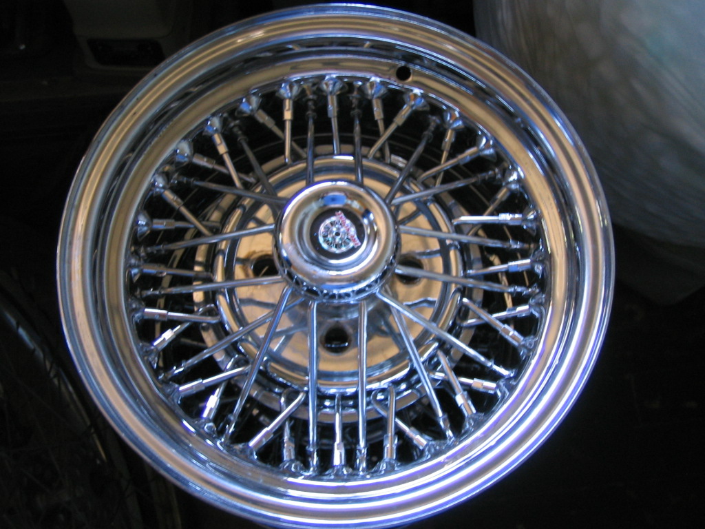

    Hi Kevin,
    I have to admit that I haven't run them yet, butI do have 14 x 6 tru spokes on my girls wagon. We have 185/75X14 cornell narrow whites from Pep Boys on them at this time. Mine have a backspace more like 3" or so (been awhile since I measured), so yours must be the more deeply reversed "low rider" version of the wheel. Any way you look at it, clearence is tight with stock but lowered suspension. Right now at ride height I have just a finger full of space at the front wheel arch, So I'm thinking rubbing will happen at full turning lock like parking and things. On our wagon, the rear fit is really close as well. We are going for a mid sixties L.A. mild custom vibe with this car, so I will do what I need to make them fit. I do have a narrowed Maverick V8 rear under my other Falcon and I think it might end up under this one before all is said and done. I will have to plug and redrill the bolt pattern to get back to a four lug pattern though. On the front I believe that I will probably narrow the lower control arms just a touch To bring them in just a bit with less shims needed for the upper arms. We'll see. Oh, just to add some info for those that might need it in the future - I have ours on the front with a set of Scarebird disc brake for a four lug Falcon. I had to do just tiny bit of grinding on the out side face of the calipers to make this deal work. Super easy conversion all the way around. Just have to finish up the plumbing and bleed them and we're ready to test.

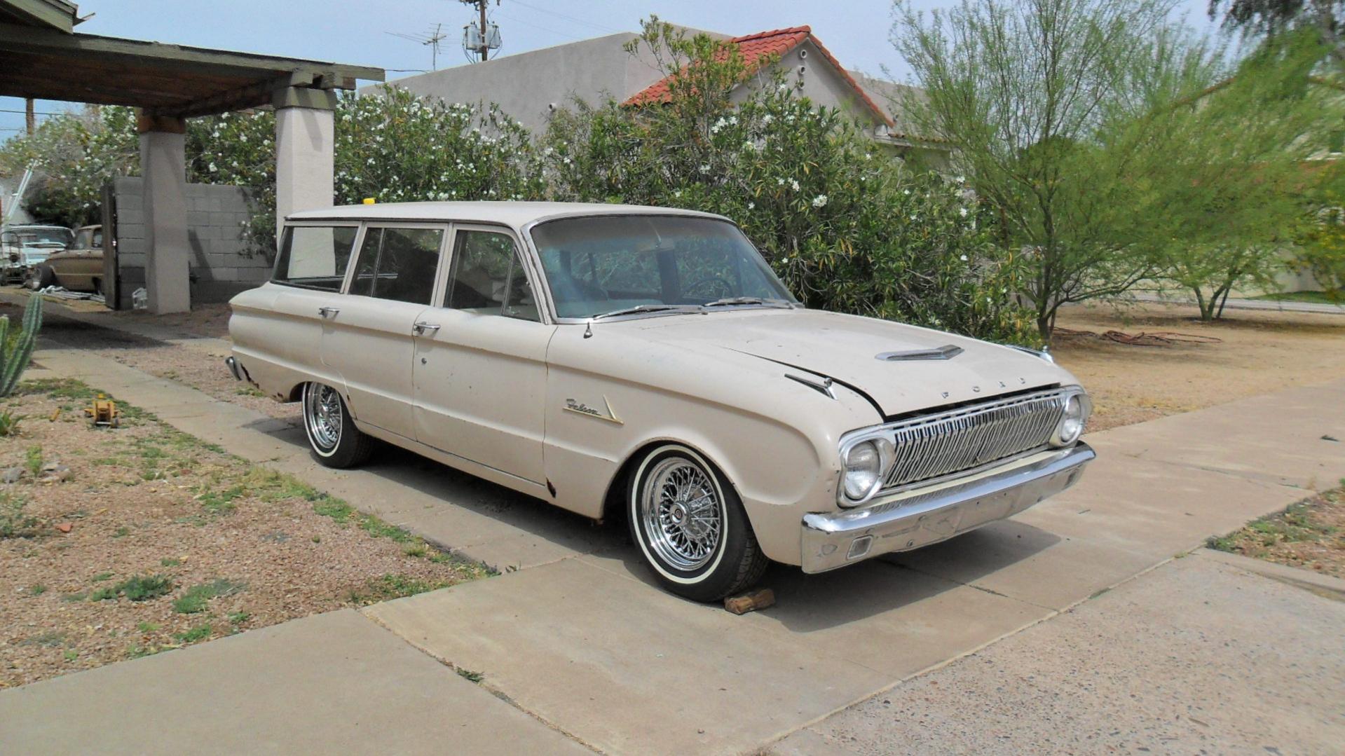

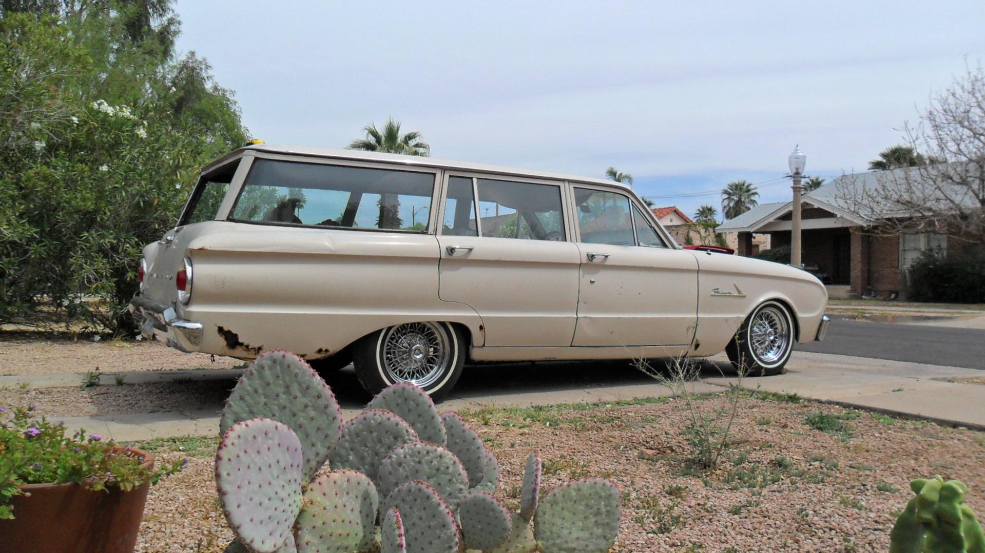

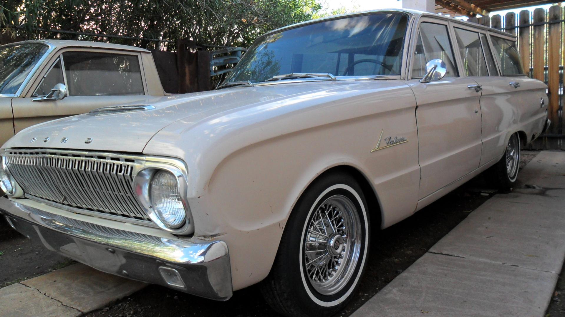

    Well, it's been a bit since I updated on the G/Fs wagon. And since it's not quite done yet, it still stays in Doing Falcons Right instead of Falcons Done Right. Got the rear end set up to my desires this last month in the first bit of personal project time I have had in quite awhile. I ended up dearching the rear springs 3" and doing all the bushings in urethane. I finished it up with some light gas shocks that were left over from another project around here. It's not nearly low enough for MY personal tastes, but I have had to be mindfull of who the proper owner and end user is. This is the same girl who once informed me "I'm a great driver! As long as I'm going straight!!!"
    Let's just say my usual too low was not an option...
    Right now, I have to put some oil in, drop a battery in, hook up a few wires, bleed the brakes and she's a runner. Then it's on to fixing "Arizona rust", looks bad, but it's just the outer panels from the windows leaking. She's in Hong Kong with family this month, and I have been informed that she would like to drive it when she gets home! Oh, and I love to shoot in my cactus garden front yard...
