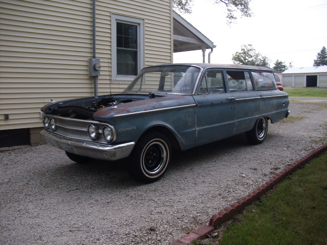

    I put 2 1/4" blocks in the rear of my 61' and it worked ok but I wanna put some 3-3 1/2" in it now and cut a coil outta the front now. Just needs to be lower I think. Have any of you guys had problems with over heating with the stock fan and radiator set up? I was thinking of adding an electric fan or a bigger radiator to help keep it cooler in traffic. That wagon is cool as hell by the way! The wagons always had just a cool custom look even completely stock.
