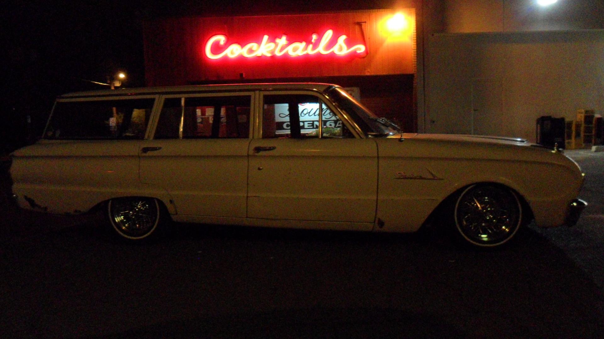

    Hot Damn! Built some aluminum lowering blocks last night and found a set of U-bolts I had made for my '62 sedan about 20 years ago hanging on the wall... 1 more inch down in the back and all is well! Going out to get plates right now!

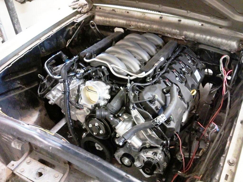

    Hey Nash510 - If you want to get rid of those stock "headers", I have just finished these for Coyote's in early Mustang using MII based suspension. Bet they would fit the Falcon as well!

    Did about twenty miles tonight just boppin' around town. Expect to see it out at the Nostalgia nats this weekend!

    Go go go man! I can't believe I dragged my heals to get my wagon running as long as I did. Everytime I turn the key I get all happy and giggly...

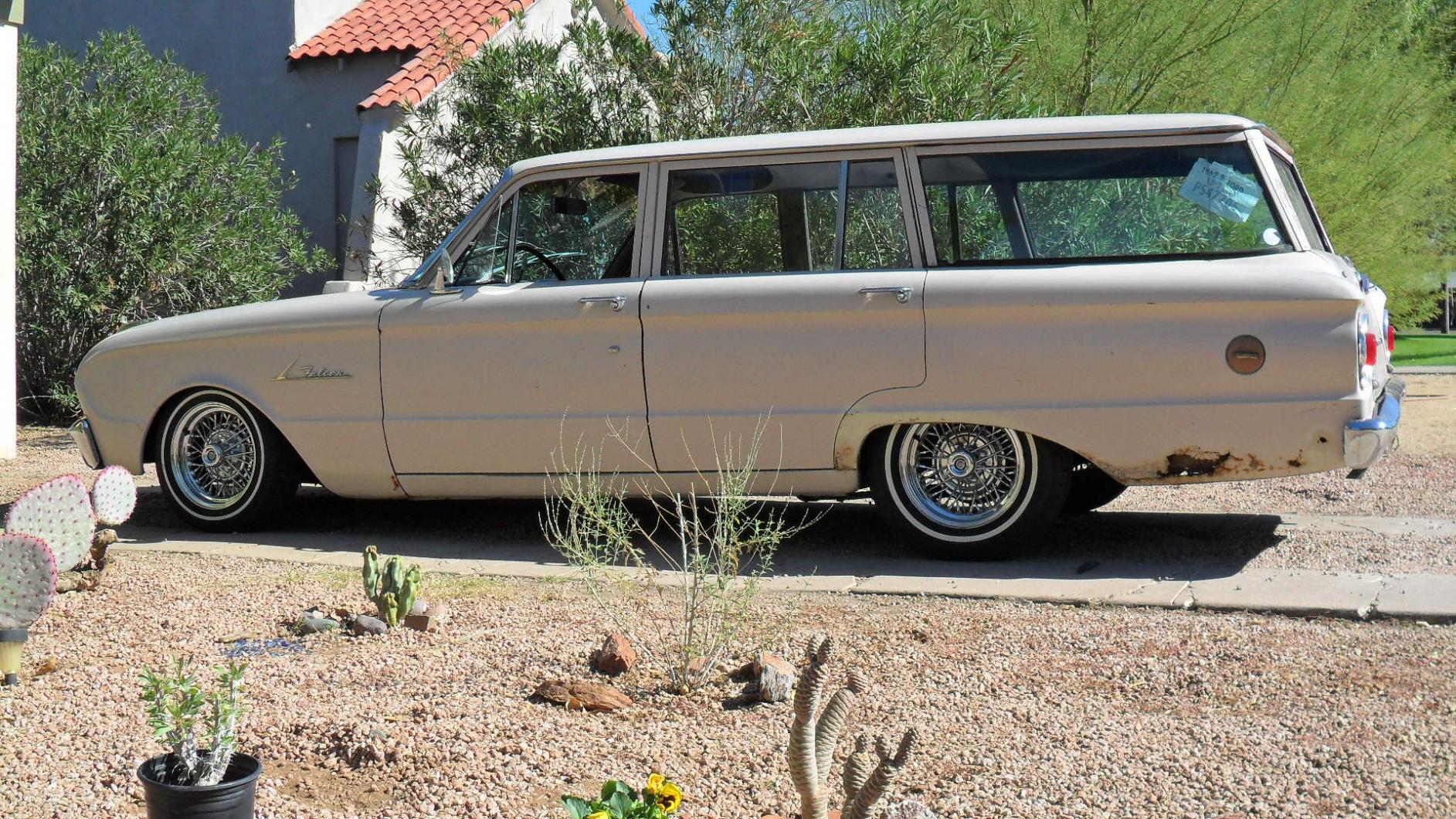

    Sorry I didn't see your question until right now. My Tru-Spokes are 4 lug. As far as brakes go, I went with a kit from Scarebird right here on the H.A.M.B. and would recomend it to anybody with one of these cars. It uses Nissan Stanza rotors and Chevy Celeberty calipers. Earsy, cheap and works well.

    Thanks man! Took it out to GoodGuy's this weekend and had a small crowd around it all weekend. Judy was m***ively stoked because she had never had that connection to something she owned and had helped build getting that much recognition. Plus, yesterday she and MIKE's wife Mary both learned to drive old cars in it in the fairly empty West end bowl of the venue... It was a good day!

    I was really shocked at the two girls reluctance to drive the wagons. (Mike and Mary have a '62 Chevy wagon) I just jump into anything of any age and just go. Not so with these two! I even set Judy's car up with a Mustang floor shifter because I realized she has never pulled a lever on a column shift... Even an automatic! Sure was proud of her though. Next is getting her to drive it up to the grocery store and around the neighborhood. That stupid Honda of hers is doomed!
    Edit. One more "glamor shot" from the "have a drink with H.A.M.B.ers" deal the other night....

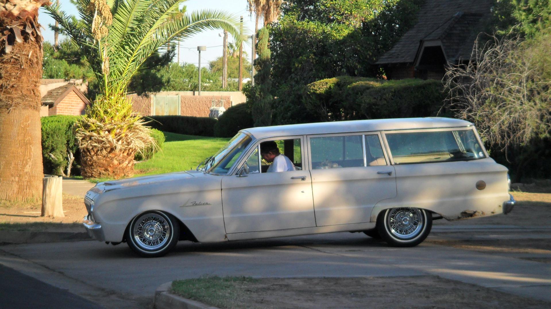

    Got new front tires so now I have clearance. They are 185/70 14s Rears are 195/75
    Still need to wash the blue off the whitewalls
