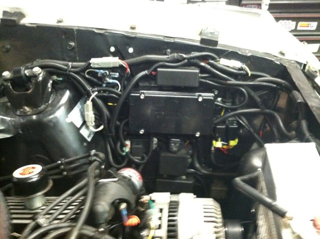

    Looks great but I don't think I've ever seen that much wiring under the hood of a Falcon! Is that the fuse box on the drivers side?

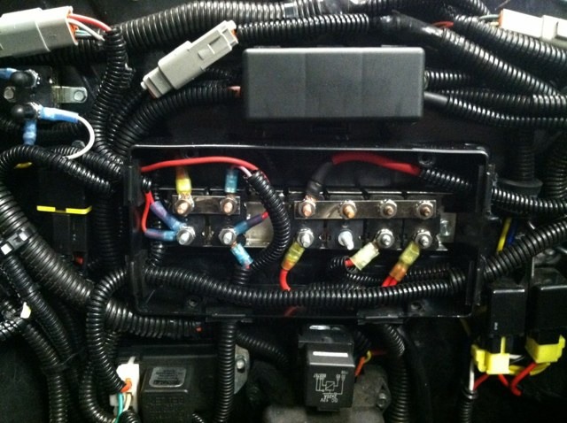

    ImageUploadedByH.A.M.B.1371153313.714439.jpg ImageUploadedByH.A.M.B.1371153344.039210.jpg
    Cleaned it up for ya'.
    From the top:
    Power buss
    Ignition relay. Circuit breaker panel
    Fan control relay. Fuse box. H-4 relays
    Ground buss. Horn relay
    Moved the 6AL to the core support
    My first attempt to upload pics from my dopey iPhone...
    Louvre Dude, I've got some Falcon a/c service info- I'll PM ya' later...

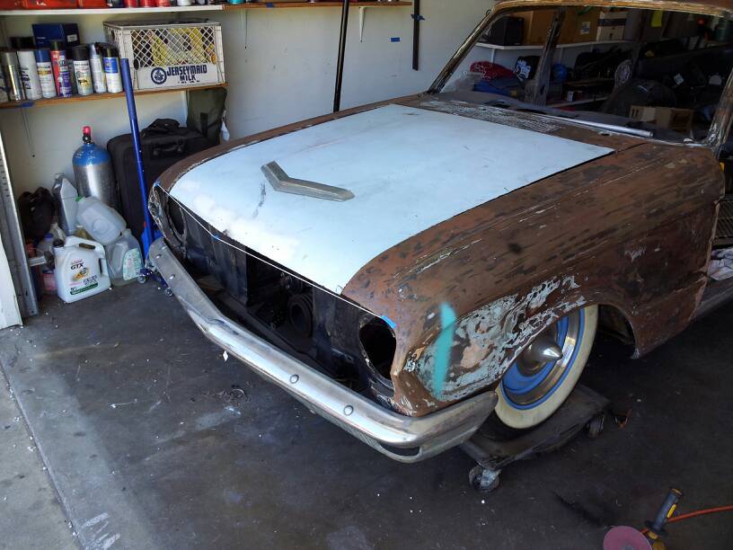

  19. falconizer_62
    Joined: Mar 2, 2007
    Posts: 637
    falconizer_62

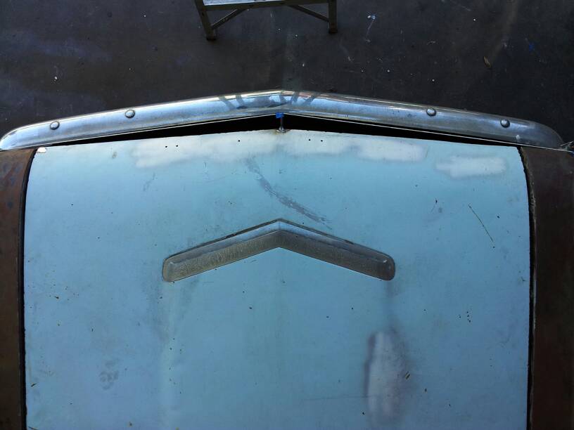

    I am thinking about extending the hood and fenders to match the peak of the comet bumper... Photoshop time :)
  20. falconizer_62
    Joined: Mar 2, 2007
    Posts: 637
    falconizer_62
    I decided to go for it and love the result :)
    It looked good on Photoshop, so I figured what the heck. All done before lunch break. Not bad

    Falconizer, Are you going to pull the sides/inside corners of the fenders out to match the profile of the hood?
    What are you doing about a grill?
    I saw a galaxy online with a folding sliding ragtop and it looked real good. I think it would look good on a custom like this.
