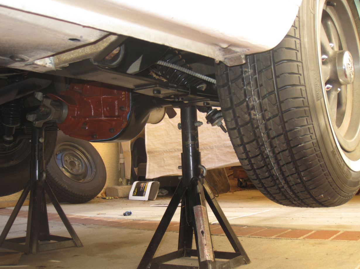

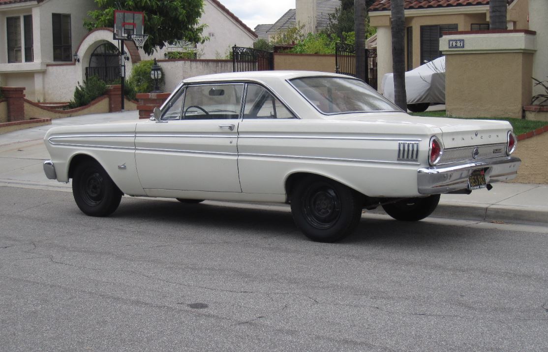

    Here is one of my projects. A 64 falcon hardtop. Originally equipped with a 170CI and 4 speed Dagenham transmission. Was a one owner, all original and ran great.
    Switched the suspension over from 4 lug to 5 lug. using the 65 falcon V8 manual steering and quality parts. The rear end is from a 63 Falcon with a 3.55 posi.
    Lots of fun while working with my little ***istant!!

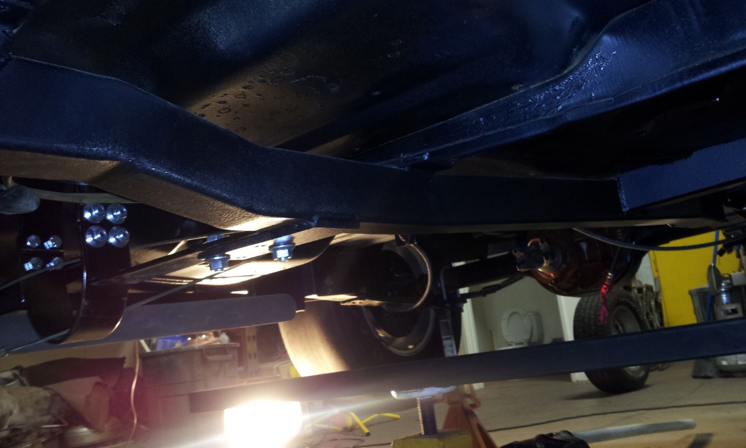

    Here is the rear end work...

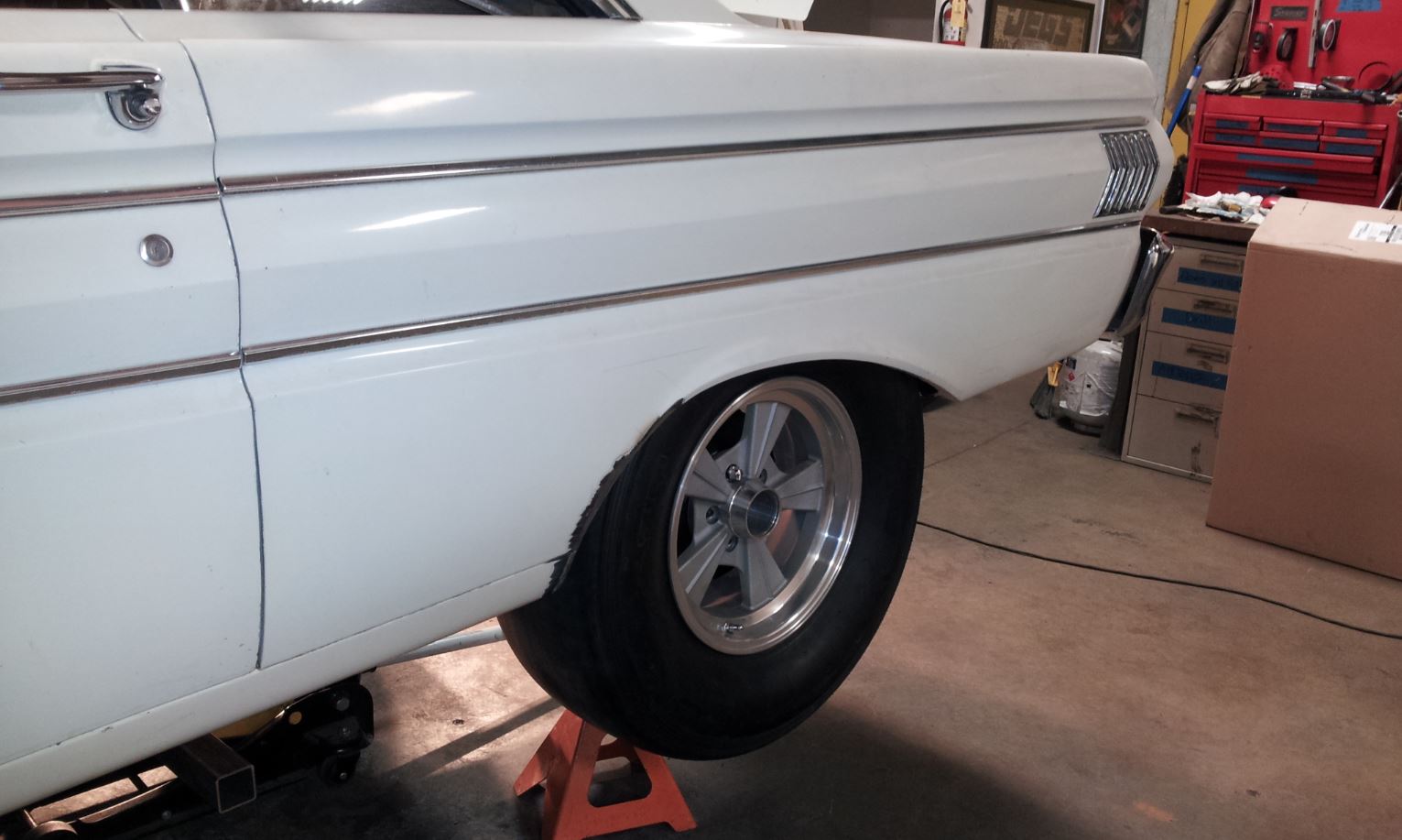

    Really, really cool build, that Falcon will be quite entertaining. When I read of your power plans, I was hoping you would upgrade the little 8", they are tough customers but to a point. That nodular 9'' will do nicely. Did you go with a new 56" total width housing and axles? And did you go centered housing or centered pinion?
    -KK
  12. nuts4fords
    Joined: Apr 16, 2011
    Posts: 26
    nuts4fords
    Those are Cragar GT (not SS) wheels. Center caps say GT not SS. They are pre SS. They are old school from the 60s two piece (steel rim & aluminum center) 14x6. Originally painted black centers which appear gray now due to their age.

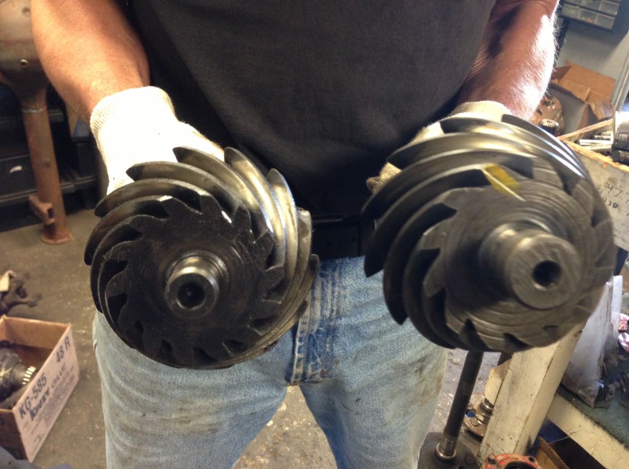

    I narrowed the "N" 9 inch (3.89. / 31 splines) rear end to 54.5" and centered pinion.

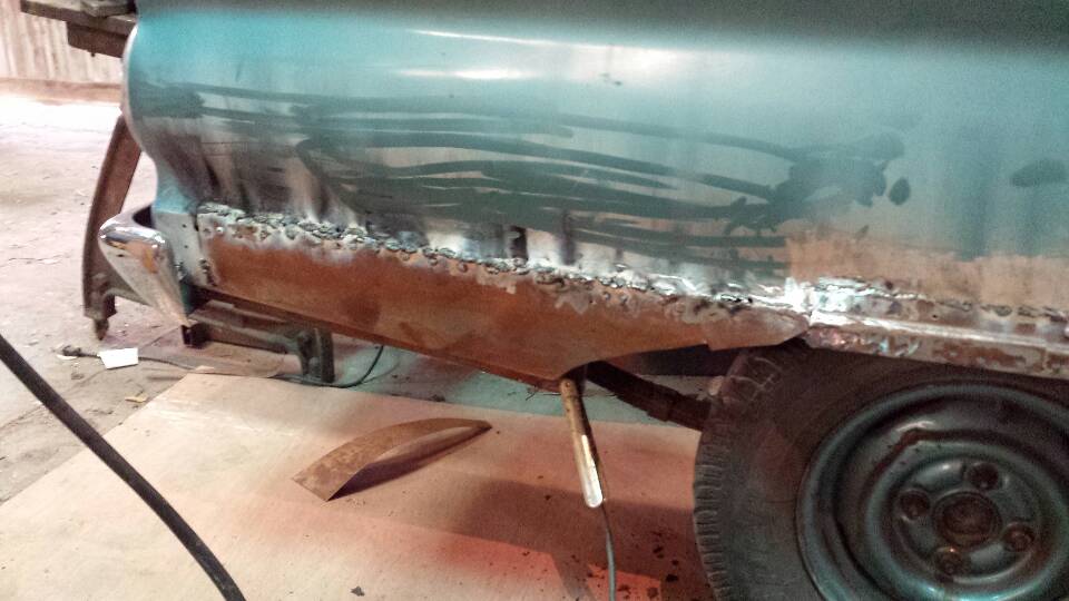

    Just got back to the falcon. The rear quarters are ROUGH!
