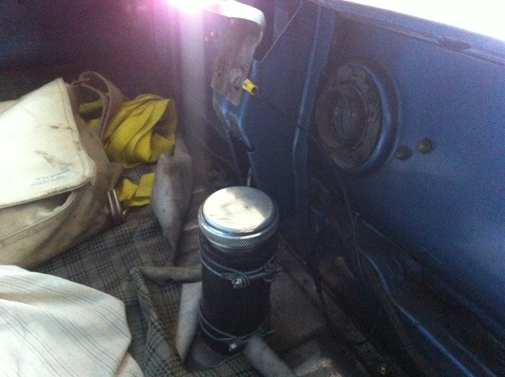

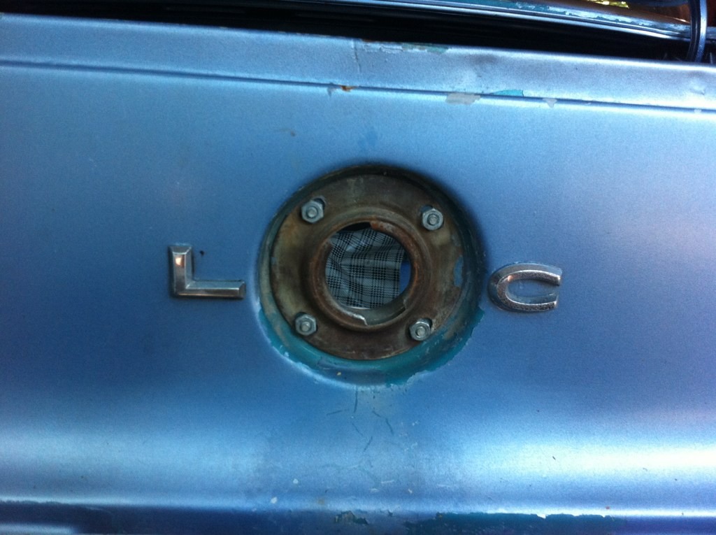

    You are correct. There is an outside piece that sandwiches the filler neck to the body. The gas cap locks onto this.
    Also, if you don't already have it, you'll need the rubber hose segment and clamps that connect the filler tube to the tank. My aftermarket tank had the fill spout facing the opposite way as the factory tank, so I just rotated the filler around to meet it and mounted it there.

    Damn, beaten to it. I just got in the door with my pictures. Yes, the lock ring for the cap is a separate piece.
