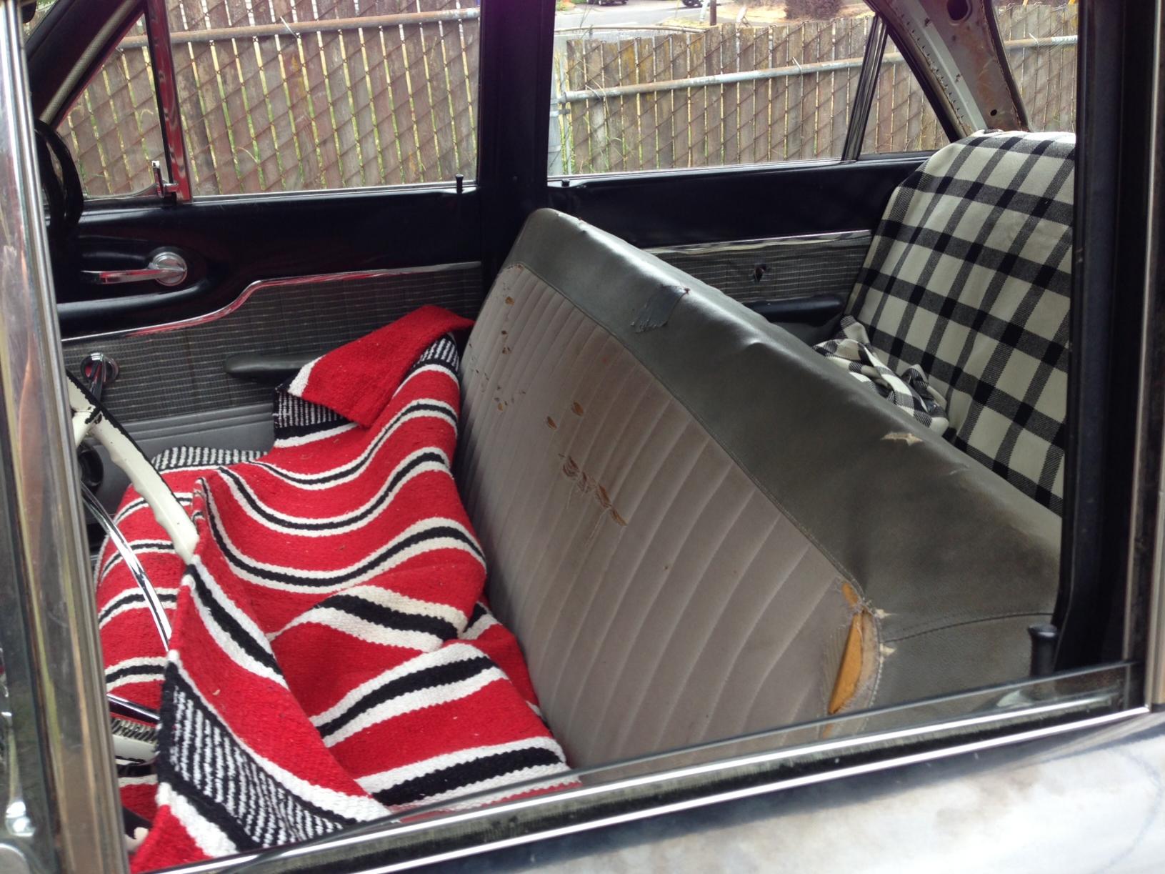

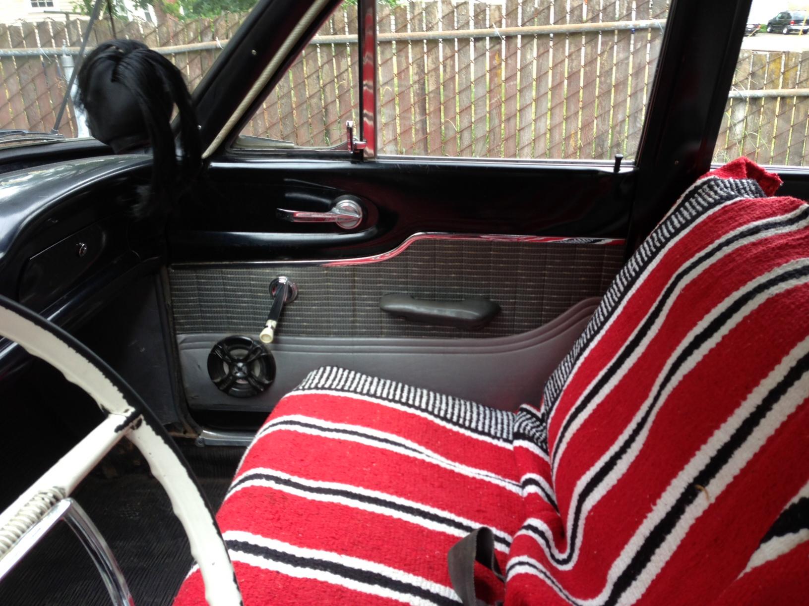

    So I have a 1960 falcon, black, 4 door hardtop, inline 6. I have been searching for seat covers, door panels and sun visors but haven’t had much luck (macs, dennis carpenter, dearborn etc.) seems like there is everything for 61 and up but can’t find much for 1960. Anyway, I’m not that concerned right now about the seats and door panels but I am going to have my package tray and sun visors recovered. Does anyone have pictures of their package tray and visors? I’m curious as to what color mine were from the factory. Any pics or links are appreciated. Below are a couple if pics of my car so you can see the colors.

    Nice looking falcon.
    I would lower it a little clean the interior up and call it done.

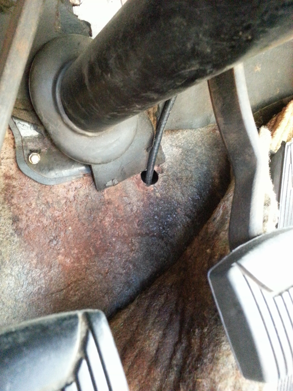

  12. Could someone throw up a photo showing where the speedo cable comes through the firewall on a '60 Falcon please ?

    Yes, I need a grommet:

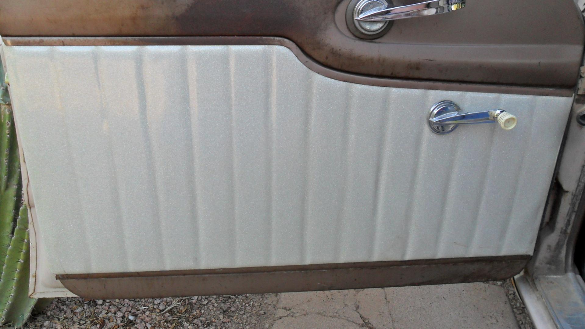

    I thought I would throw this into the mix on the door panel debate real quick, so I ran out and shot some kinda ****py pictures of what I did in my wagon. These are made of 1/8" luan door skin plywood from any home improvement store, about 20 dollars of "Zodiac" vinyl from the fabric store, and about ten dollars of 1/8" landau foam from an upholstery supplier. I cut out 2" strips of the landau foam, bonded them to the door skin panels with WeldWood brand contact cement from the home improvement store leaving about 3/8" between each piece. I then glued up the recesses between the foam pieces, the back side of the fabric on the corresponding lines, and glued them together. The rest is just carefully folding the edges over and gluing against the back of the panels.... Done, 3D, and no sewing so anybody can handle it. 'Course, I could teach ya to sew too...
    Quick disclaimer. At the end of summer I will have to take some time and gently pull the skin back off and reglue the the recesses a bit better. Unfortunately, I didn't really give these quite enough time to set up before I slammed them in place and started using them. Combine that with our 115 degree summers and the glue isn't what I would call happy...

    Mmm, Beachwood Brown Metallic.

    I've had horrible luck with 3M77 for panels, but the Weldwood has worked great for me, if I do things right. I used it on these panels, but I had to work fast, as it was a hot day under direct sunlight, and it actually got too dry if I didn't get the material on the panel quick enough!

    Ya, I'm thinking I might have got a bad batch this time around, as I have had bad luck with the aerosol 3M stuff too. But in our ridiculous summertime heat almost nothing sticks forever. I had a glued up headliner in the Plymouth for many years, and when I first put it in, almost every morning would find it laying across the top of the seats. A call to 3M asked many questions and answered many more. Then came "What's the temperature where you live?" 118 today. Long silence..... "Well there's the problem!" Cool! How do I get around it? "MOVE"! Another brand of contact cement DID eventually solve the problem.
