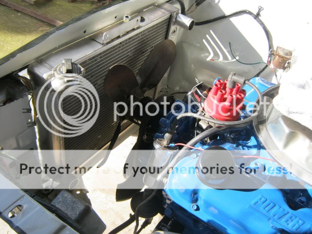

  9. Thought I'd throw up a few shots of the '60 slowly coming together .
    Did the Shelby drop on the UCA's , fitted heavy lowered coils and Pedders shocks. 289 and C4 in the hole - If the ****** tunnel was any tighter the C4 would've needed "personal Lube"!
    Rebuilt the Shelby calipers , fitted tandem master and 4 way valve . I have one brake line left to make up and I should have brakes .
    This was a factory Auto trans car so I've fitted the shift detent plate and shift indicator from a '63 into the '60 Column .

    Nice work! I was wondering what radiator you are using there? Im trying to work out what radiator to use in my car as the radiator support has already been cut to fit a 70's XA/XB falcon 6 cylinder 2 core radiator, which I was considering using but really need a shroud for it maybe. I've got a 302 going in, so the water pump outlet is the same as yours. If the support panel was original I would have just fitted up a mustang radiator, fan and shroud as apparently they bolt straight in. Cheers
  12. Thanks Veach , I'm building this for my wife, it will be her daily transport and when I've been especially well behaved I'll be allowed to take it out for spin! :D
    Liam , Thanks . The Rad came with the project when I bought it in Ca earlier this year. I suspect that it has been a custom build, when I got the project it was mounted in FRONT of the rad support. The support had already been cut, I just tidied it up a little before painting the car and as you can see I've moved it back behind the support.
    I've mounted it on soft mounts at the bottom and will build a support for the top which will bolt up to the two holes at the top of the support.
    You might want to measure up a V8 XC-XD rad , I think they were a crossflow type and may be close to what you need for width?
    Rod .

  14. Has to have a cert for the following ,
    289 & C4 ( custom trans cross-member )
    8" rear
    Shelby Drop
    Tandem brake system
    Shelby ( kelsey hayes ) 4 pot front brakes
    and because it's modified it has to have 3 point front seatbelts fitted, and yup they have to be certified as well !
    once it's all ticked off the rest is all pretty straight forward though .
