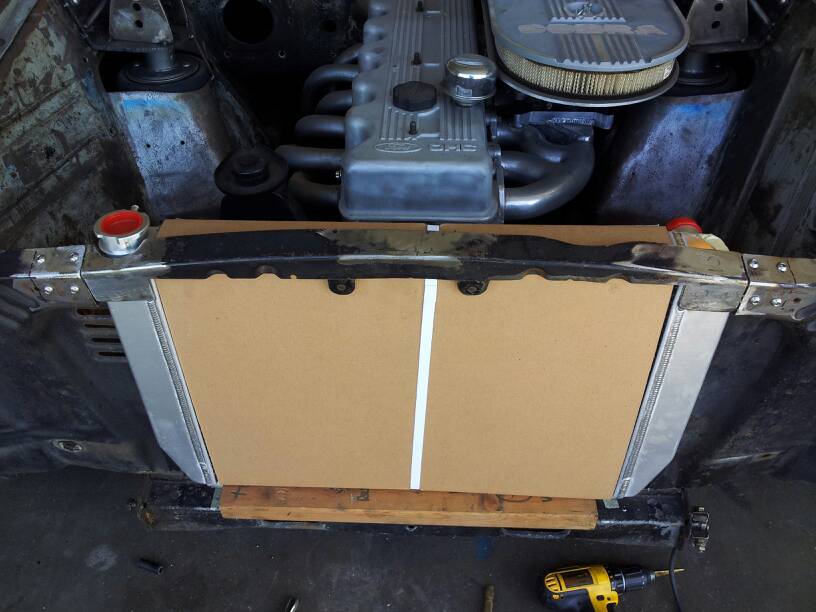

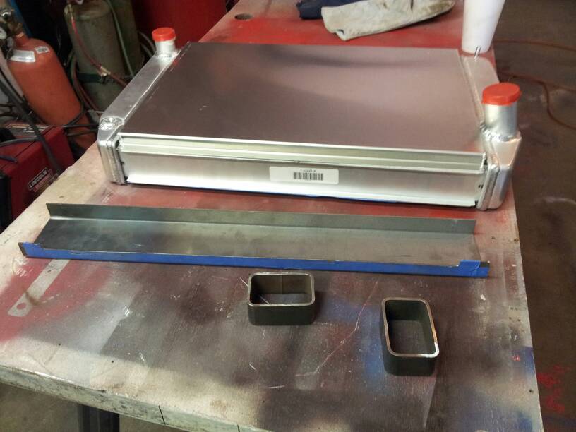

    Trying to make some headway on the radiator. I think this should work...
    So many small variables to consider if you do not want anything rubbing holes through the tubes on the core or rattling while running. I am also careful knowing that I could come up with a better way to do it after I'm halfway through this attempt.

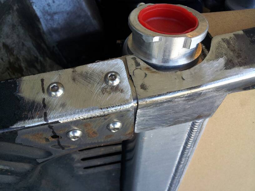

  22. falconizer_62
    Joined: Mar 2, 2007
    Posts: 637
    falconizer_62
    Man, worked all day on this darn radiator and still don't have much to show for it. The fans are so close to the pulleys that it's tricky to make this thing serviceable, and not go all tube ch***is on the front. It felt like one step forward, two steps back all day. But here's what I got :
    I think I would like to mount the lower channel with rubber cones so that the radiator can tilt backwards to release the upper Channel from the body.
    The lower channel is larger than the upper Channel so the shroud fits on the inside on the bottom and on the outside on top. That hopefully will allow me to slide the fans and shroud out the top in case I have to change a belt, and allow me enough room to tilt the radiator back to release the upper channel for removal. There's a million ways to do it, I'm kind of stuck as to which is best. The fruits of the day...

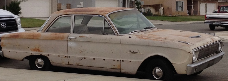

  23. rcrown
    Joined: May 29, 2013
    Posts: 30
    rcrown
    Figure ill jump on the band wagon and post a few photos of my 1962 Falcon project.

  25. rcrown
    Posts: 30
    rcrown
    Thanks, that was right after we brought her home and unloaded off the trailer.
