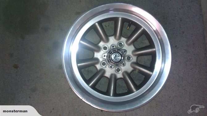

  10. Thanks Evil , based on how smart yours look I went and bought these today , They're 15x7 with just over 4" back space so if my measurements are correct they'll fit in the rear nice and tidy .
    We have a set of early 5 spokes in 14x7 that I had planned to use but the back space on them is only 3 1/8" so they're too tight in the rear fenders .

    those should look great ! only reason went 16" with this brand the 15's had more of a curved spoke not straight up and down. let me see some pictures asap when you mount them @! best of luck

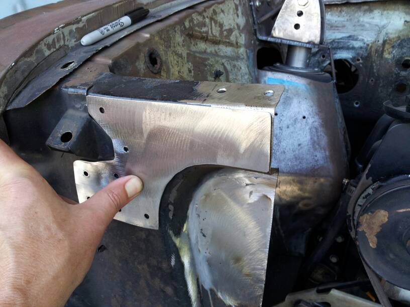

    Well, the radiator mount is getting closer to being finished. At least I know what I am supposed to do from here on out which certainly helps.
    I was able to use the original sheet metal on the top of the radiator support and just a box it all in, and now it is plenty strong. As far forward as the radiator needed to sit, the cap was right in the middle so I had to go around it

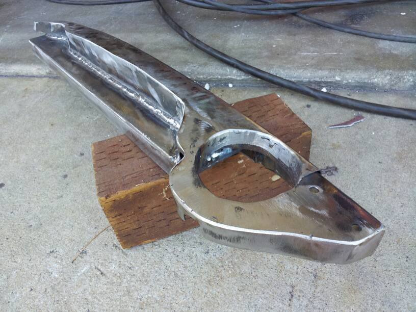

    Now, I have to box the end sections were the crossbar attaches. I will plate it outside and tie it into the corner and box it on the inside.
    I got the outside of the right hand side finished.
    Before, and after.

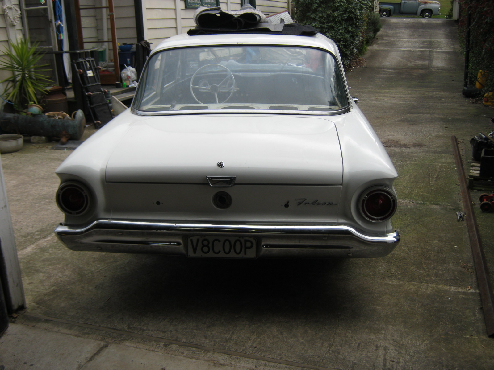

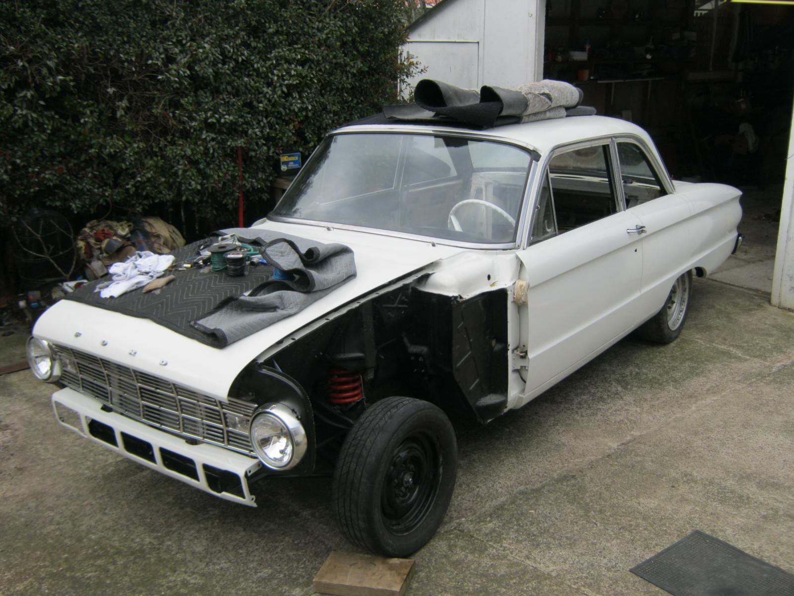

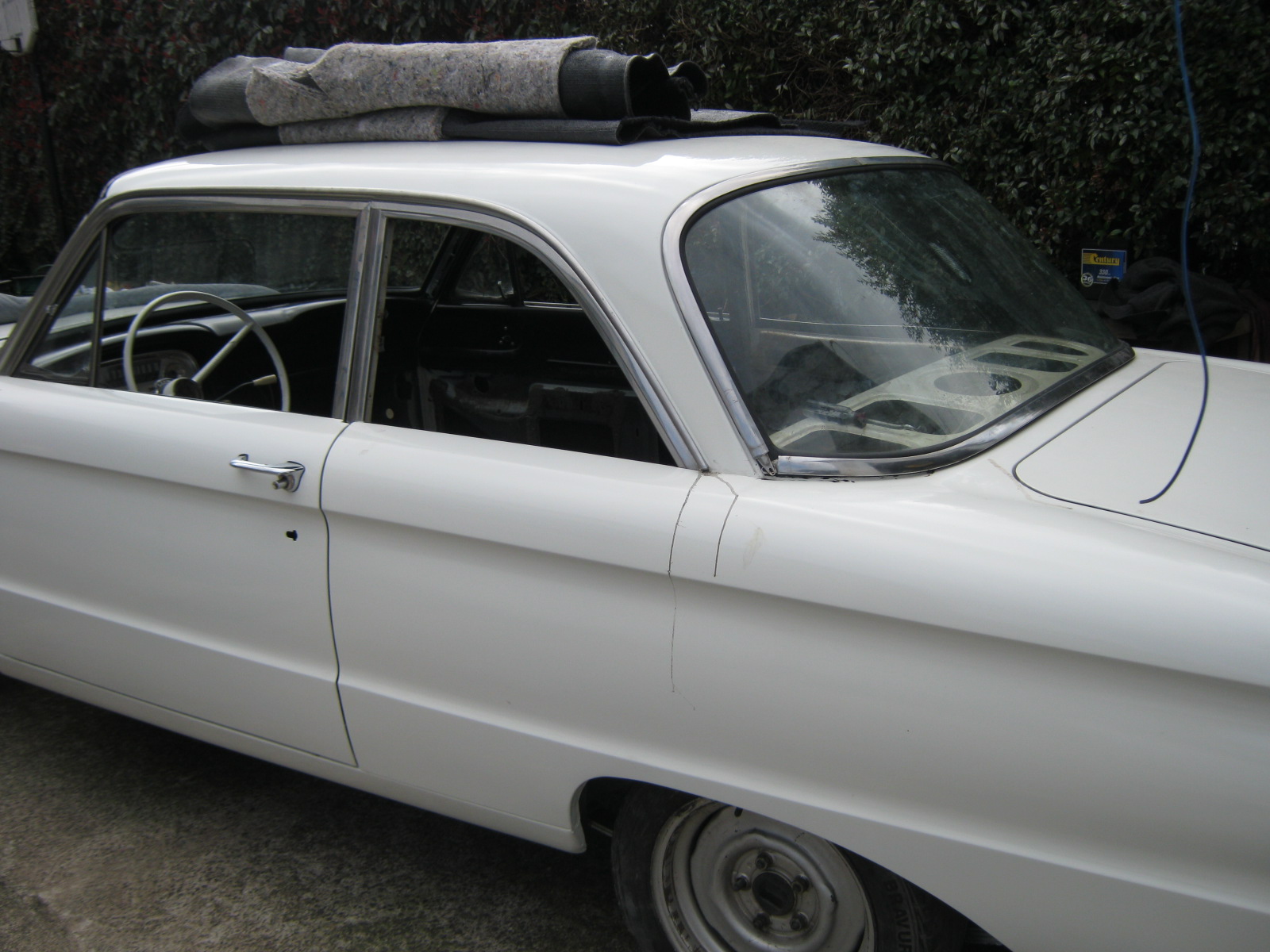

  26. Made some more progress today ...
    Head lining fitted , front and rear screens fitted , ****oned up the last of the wiring , fitted driveshaft and E brake cables , adjusted rears and am ready to bleed brakes tomorrow. Battery is on charge now....

    Looks good but, I don't think the fenderless style quite suits that model. Ha ha ha

    I kind of like mine with the fenders off.

    Wow 4t6ford! That is quite an extensive list of stuff you completed. Was the headliner install tricky?
