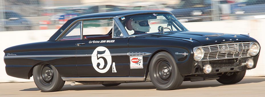

    Jumping in with my '63 1/2. Also a pic of the inspiration for my build. Although mine will have more of a Drag Racing profile since that's what I like to do. Controversial plans in the works that will undoubtedly not please some folks. Updates to follow.
