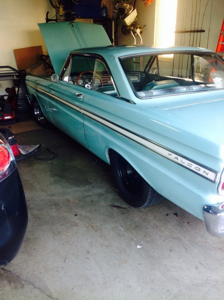

    A pic of my dad and I's 1965 falcon sprint 289 ImageUploadedByH.A.M.B.1383623441.306572.jpg were happy with it! A work in progress but we drive it!

    65 Sprint.. wow rare Falcon .. cool car! only 2806 hardtops built..

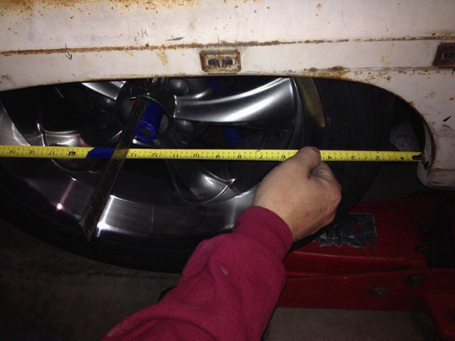

    Hello all, need to know if anyone knows the center line of their axle with in the rear fender on a 1962 falcon, I need to put a rear end under this car and weld up this universal four link front brackets to the rails. ImageUploadedByH.A.M.B.1384144337.577072.jpg

    Joined: May 29, 2013
    Posts: 30
    rcrown
    Ok sounds good, thank you I'll give that shot Tomorrow morning 109"
    Thank you again
  21. Falcondad
    Joined: Oct 14, 2013
    Posts: 16
    Falcondad
    from Tracy CA
    Just looked it up and I was 1/5 inch off. It's 109.5 inch wheelbase. Lol. Hope this helps. Post pics of the install of the 4 link.

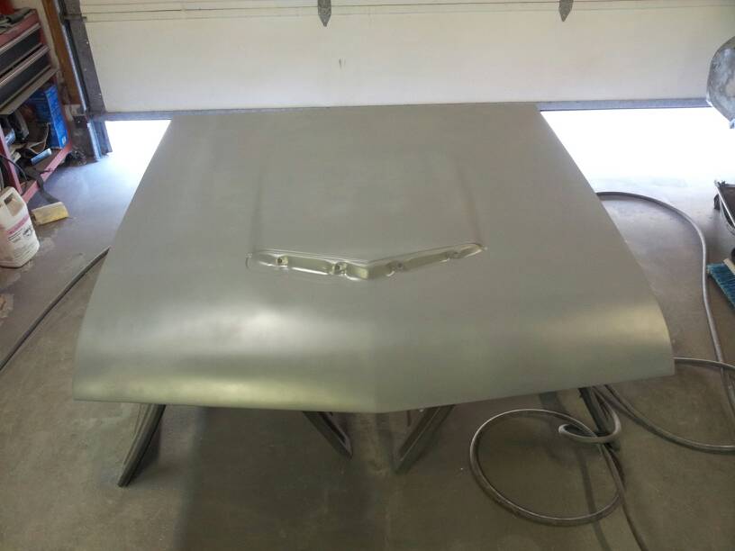

    Okay, here are some pictures of my last 40 hours, no kidding, of work. It does not look like much, and I don't know if it is this much work because I don't know what I am doing, or because it is simply that much work.
    Either scenario sounds equally correct.
    I thought the hood was going to be an easy job, because it looked like it was straight, and I would only have to fix a couple of dents and do body work where the welding seams are located.
    The underside of the hood was full of crud and rust, so I had it sand blasted. Come to find out that there was a ton of bondo on it. It had been walked on or jumped on in its past life, and had more than 60 dents in it. I did not know this before I had already spent a bunch of time cutting and customizing it. Grrrrrr....
    Well, I think I finally got it straight ( I will know for sure when it has it shiny color on it) and I painted the first color on the hoood's underside today. It is Meissen Bkau, a 1957 through 1959 Porsche color. The roof will be Wimbledon white with blue skull apps on it, I'm not hood and front fenders will have Wimbledon white scallops ( in theory... I will have to Photoshop that first ;)

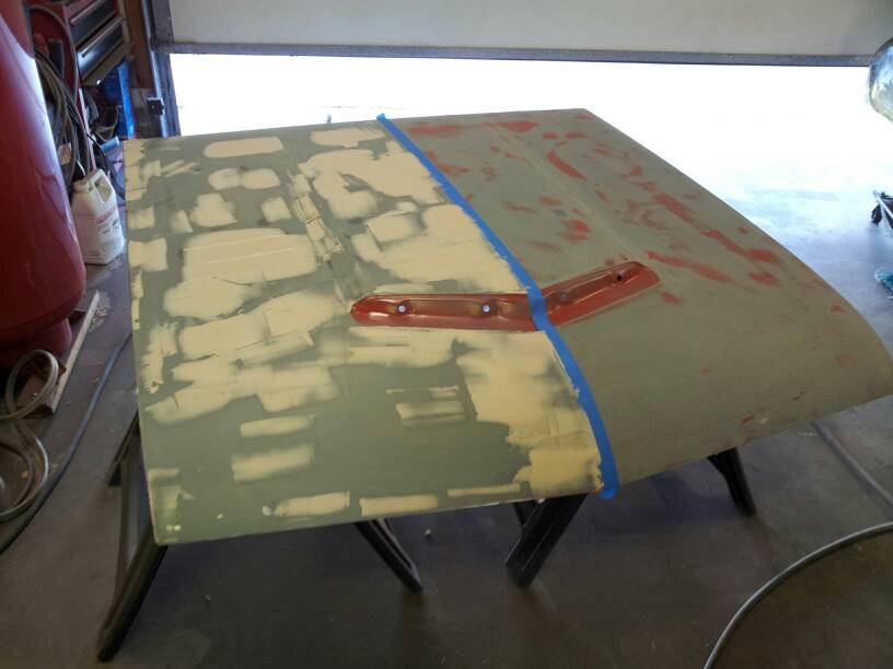

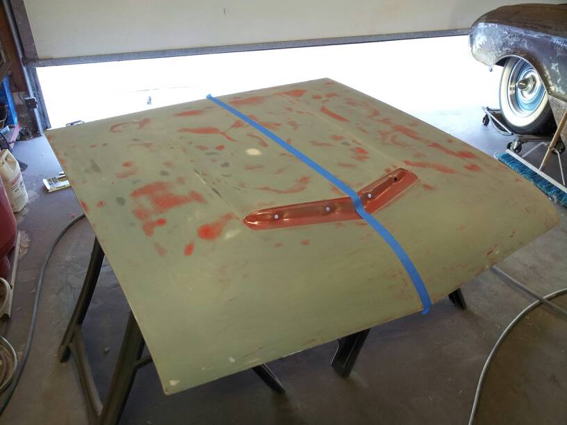

    These are the pictures of the process.
